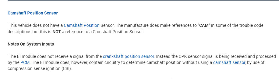

Just to add. This engine does not have a cam sensor as mentioned earlier. However, the code is telling you an issue. They should not be deleting it because clearly there is an issue. Depending on what the code was, you more then likely have a circuit issue or an issue with the PCM over and above the P0340/41 code from above.
If the code gets posted, I will be happy to investigate all the possible causes. However, as I said, we never want to delete codes and ignore them. There are times that we ignore some codes but that is because they are "reactionary" codes and not the one that caused the issue. Any time someone deletes these "cam" codes because they say you don't have a CMP sensor so the PCM must be wrong, probably does not have a good idea as too what is happening and a second opinion should be sought.
I attached some service info about this. Please post a question if there are any. Thanks
