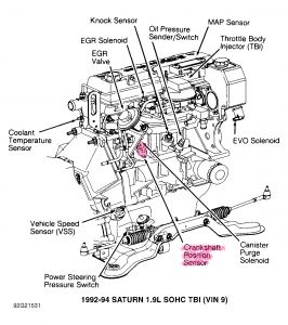

I thank the clown who gave me a reply to this but your diagram is for 91-94 saturns, mine is a 95 and I could not locate the sensor...appreciate the advice though, thanks.

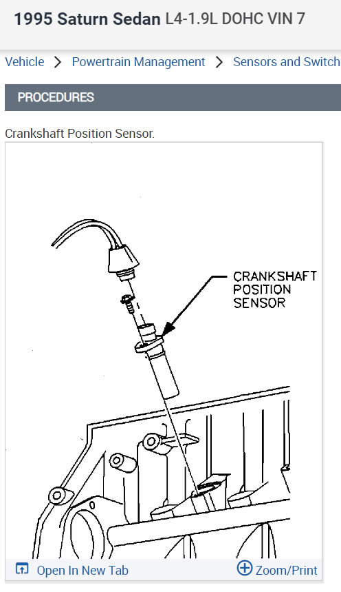

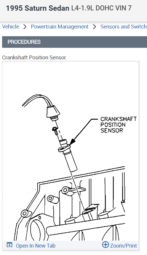

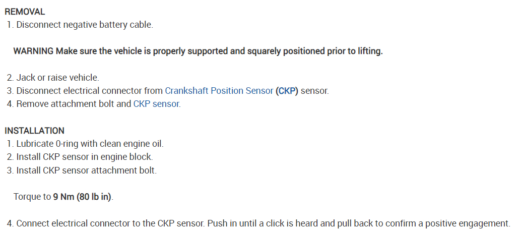

Try wiggling the connector on the crank sensor, or replacing the sensor, There seems to be a problem with Saturn and crank sensors...
https://images.2carpros.com/forum/automotive_pictures/62217_CPS_SOHC_copy_1.jpg
Here is a large image so you can see it better. Check out the images (below). Please let us know what happens.
Sep 2, 2007 at 1:07 AM
Suggested Repair
Wiggle the crankshaft position sensor connector and replace the sensor if the connection is loose or the problem continues. Saturns of this era commonly have crank sensor faults that cause stalling and intermittent no-start clicks.
Conversation Summary
The owner of a 1995 Saturn SL2 with a manual transmission reported increasing stalling and sputtering, then intermittent no-starts that produced only a click. A new battery, fluid service, and a jump start did not fix it, although the engine later cranked while the key was being turned. An expert advised checking or replacing the crankshaft position sensor, a known Saturn issue. The owner said the diagram shown was for 1991-1994 models and they could not locate the sensor on the 1995.
