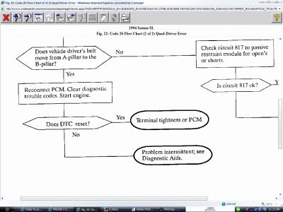

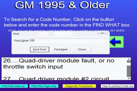

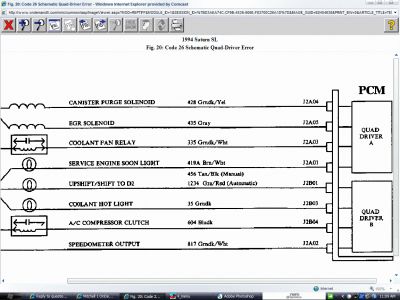

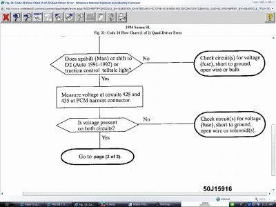

i did a code thing on my 94 saturn sc1 and it was 26 which said something about the quad driver module. I was wondering is that another name for the engine computer. If so can someone tell me where it is located in this car i'm not sure.

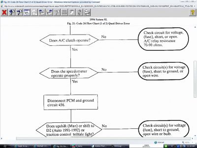

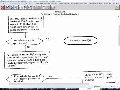

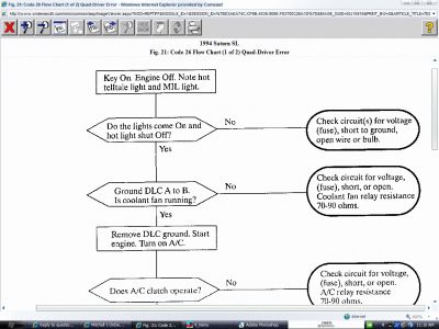

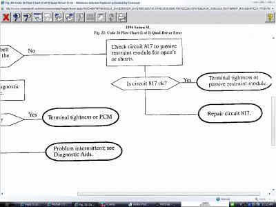

There are 2 quad drivers in the PCM, here is the troubleshooting proceedure...Make sure it's not the TPS first!
https://images.2carpros.com/forum/automotive_pictures/62217_Quad_Driver_1.jpg
https://images.2carpros.com/forum/automotive_pictures/62217_Quad_Driverflow1_1.jpg
https://images.2carpros.com/forum/automotive_pictures/62217_Quad_Driverflow2_1.jpg
https://images.2carpros.com/forum/automotive_pictures/62217_Quad_Driverflow3_1.jpg
https://images.2carpros.com/forum/automotive_pictures/62217_Quad_Driverflow4_1.jpg
https://images.2carpros.com/forum/automotive_pictures/62217_Quad_Driverflow5_1.jpg
https://images.2carpros.com/forum/automotive_pictures/62217_Quad_Driverflow6_1.jpg
Also check all fuses in the circuits!
