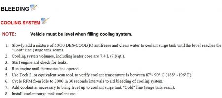

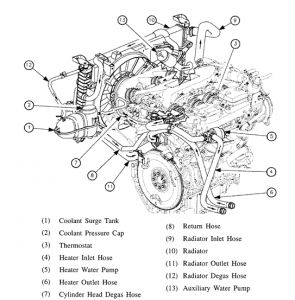

Just replaced the engine with a fresh 40,000 miles used one. Engine runs fine and car operates fine, there is no heat, heater hoses are cold. Bypassed the heater control valve, still the hoses are cold. Is there a procedure to burp this cooling system? Am I missing something? Engine runs at normal operating temp according to the in dash gauge.
Thanks!
Nov 7, 2010 at 11:00 AM
BLUELIGHTNIN6
  • 16,542 POSTS
You can try bleeding coolant system. If it doesn't help may have to remove and test thermostat.
