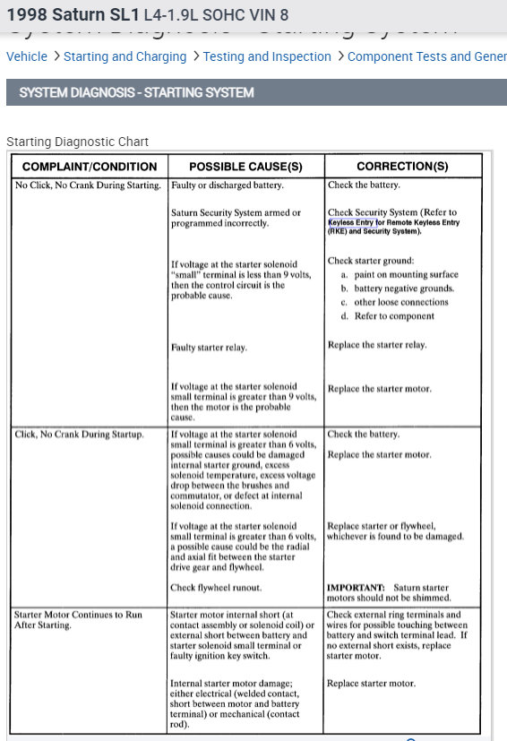

I have a 1998 sl1 saturn and it will not start. I have jumped it with cables and still doesn't not start. The radio will come on at times and I hear a clicking noise. What could this be? I would appreciate ant help.

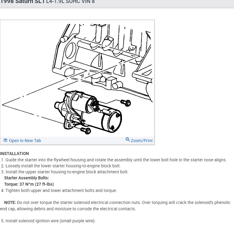

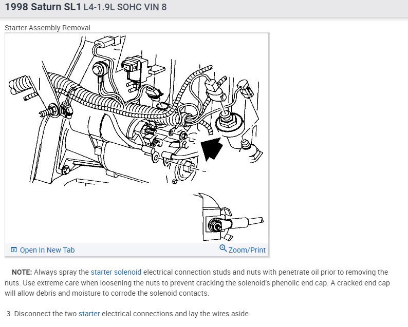

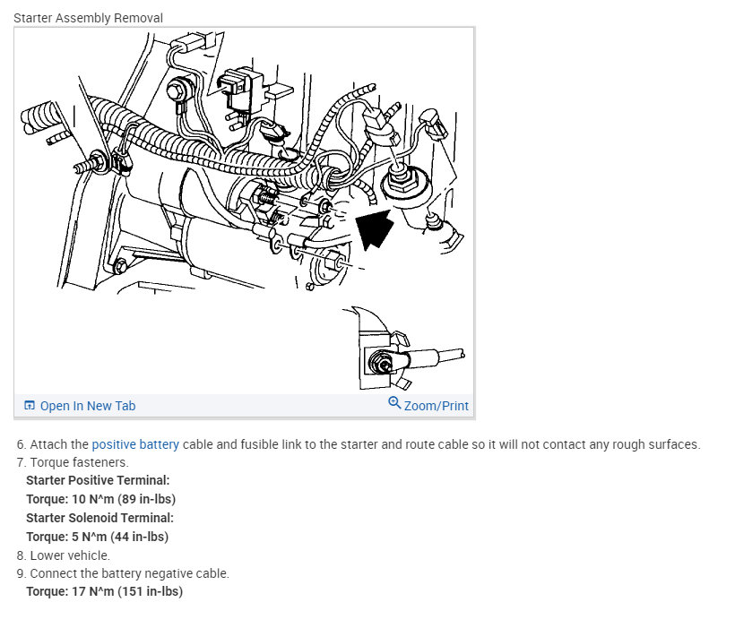

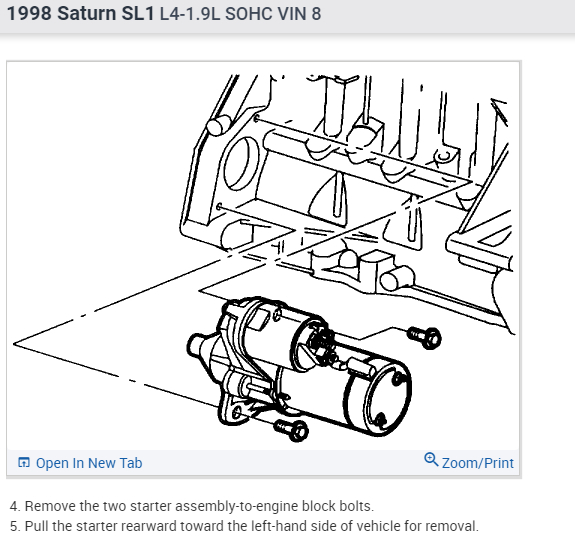

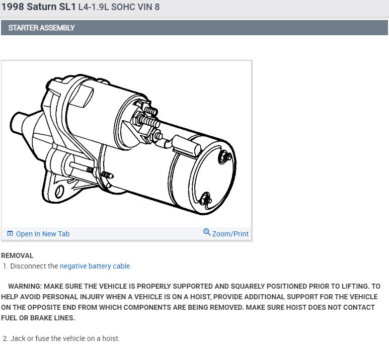

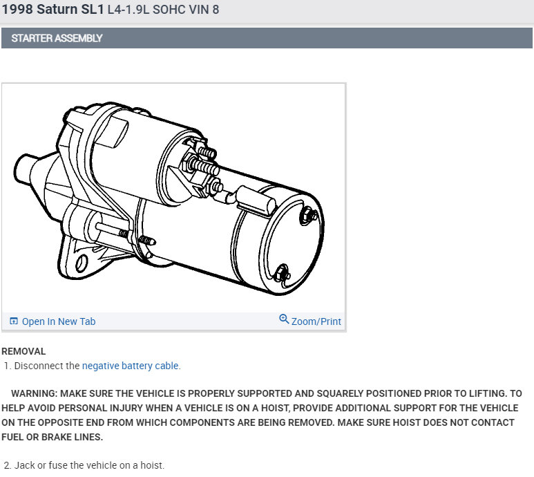

If you are unable to jump start the vehicle and it only makes clicking noise. It could be due to a faulty starter. It can also be a bad connection to the starter.
So first make sure the battery cable is secured and clear of any corrosion on the battery terminal as well as on the starter.
Here is a helpful guide:
