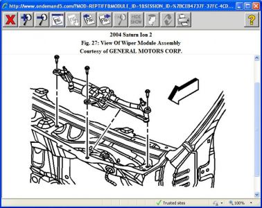

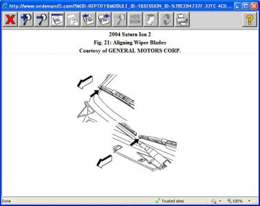

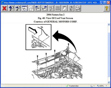

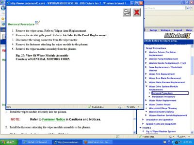

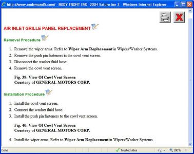

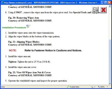

I would like to attempt replacing the windshield wiper transmission and wiper arm on drivers side. Would like to know how to get to it and any other helpful info on the task.
Thursday, July 22nd, 2010 AT 2:10 PM
SATURNTECH9
MECHANIC
30,869 POSTS
There you go there really aren't any secret's it's pretty straight forward it's not that hard.
