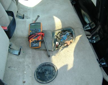

I am fighting the same problem,(1996 Saab 900) no fuel pump voltage. I have located the pump relay under the knee bolster driver side, and easter egged relays around, looking for a change. I tumbled the rear seat, and under the carpet flap on the rear passenger side there is a big rubber cork, remove that, and the 2 connectors are brown fuel gauge, the blue connector is pump. I have no voltage to the pump during crank. I metered the harness from there to the front of the car, and have a good ground. (5 or 6 ohms) The car died a few days ago, then "cured" after sitting for a couple hours. It ran kinda lame for a couple of days, not sporty, but like a Saab. And it started right up. I figgered with the pump side plug disconnected, that with a regulated 12 volt bench supply that I could verify pump operation, hummm, like a GM, nothing! I know that I have crank sensor and good ignition because the car will run with a spray bottle prime into the throttle body. I can't imagine the ECM and pump, calving at the same time.... I hope that the gurus have seen this before.

We realized that Saab only gives voltage to the pump during crank. I was looking for voltage in the run position. Once we checked and found that the power was there in crank, we changed the in tank pump. It was possible to cut the carpet and metal below in a circle and pull the pump without dropping the fuel tank. Be careful tapping the lock ring and also be careful orienting the pickup inside the tank. The fuel gauge float could touch in the tank and hangup.
After getting the car to run I siliconed the metal circle and the carpet back in place, and reinstalled the seat....fixed.
