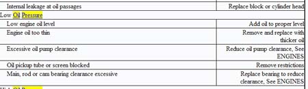

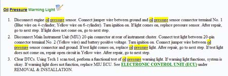

You say after turning it off and then restarting it, it ran with no lights or buzzers? I gotta tell you, if you used a pressure guage and the pressure was 5-10 psi at idle with warm engine, you may have a wiring or sending unit problem. I need to go out right now, but I will look into the resistance values for the circuit. Get back to you!
Monday, February 11th, 2008 AT 12:21 PM
MERLIN2021
  • 17,250 POSTS
Some testing info
https://www.2carpros.com/forum/automotive_pictures/62217_Oil_pressure_1.jpg
https://www.2carpros.com/forum/automotive_pictures/62217_Oil_pressure2_1.jpg
Monday, February 11th, 2008 AT 12:43 PM
