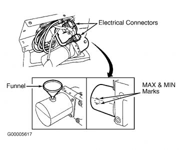

That's it behind rear seat remove filler plug use funnel to fill see diagram

roof will not retract> Everything sounds normal nothing out of the ordinary. Then completion bell sounds without roof rretraction.

U will need to check hydraulic fluid reservior, check from pip hole located inside trunk, if fluid level is good then u need to check intermediate switch located on driver side, small swiitch above hyd cylinders in corner, check if switch as bent arm, if so u will need to replace but if u r good u may be able to straighten arm without breaking it good luck, check your owner manual on how to manually work softtop, to release 5th bow & fold down top.
