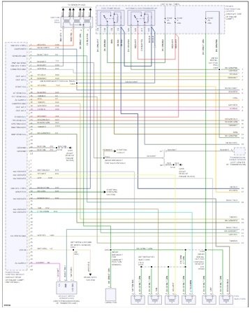

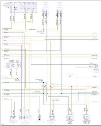

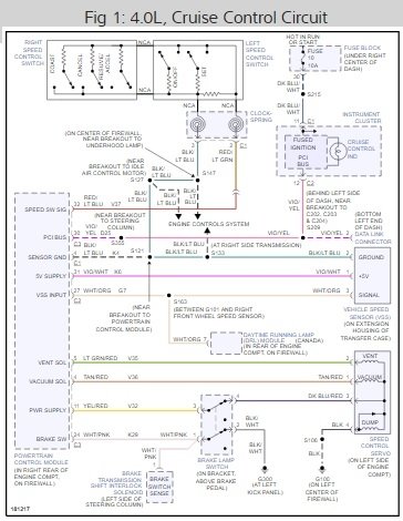

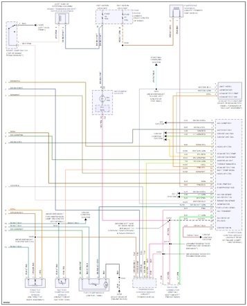

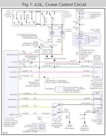

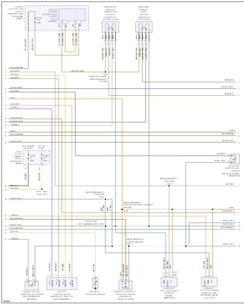

CJ MEDEVAC
  • 11,005 POSTS
I found the following possibilities for the 1596 code.
1) a faulty speed control switch.
2) speed control brake switch wire harness may be shorted.
3) speed control brake switch circuit may have a poor electrical connection.
4) a possible faulty clock spring, it's harness possibly shorted, or poor connections.
Moving on to the misfire code (po305), here are possible problems that might trigger this code.
1) a faulty spark plug in #5 cylinder.
2) faulty or clogged fuel injector.
3) faulty ignition coil.
4) fuel injector wire harness is open, shorted, or poor electrical connection
5) Ignition coil wire harness is open, shorted, or
6) you may have a vacuum leak.
7) maybe cylinder 5s compression is inadequate
8) wrong fuel pressure.
I posted you three diagrams from Prodemand (below).
The first three are "engine performance" the fourth is "cruise control"
Let us know if this helps.
