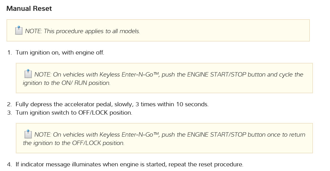

try a manual reset for oil light if it still does it then have it scanned for codes. see pic

Hi! Thanks for the tip but remember I said the car won't rev, that's the major issue. Please help!

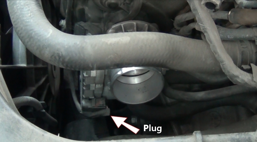

It seem like the something got bumped off such as an electrical connector, please the check the throttle actuator plug and the crankshaft angle sensor.
Get back to me please,
Best, Ken
