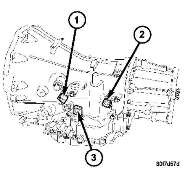

having trouble with starting in park
119,000 MILES • 3.8L • V6 • 4WD • AUTOMATIC
BAPP06420
looking for the location of the neutral safety switch
May 30, 2015 at 2:26 AM
HMAC300
  • 48,601 POSTS
its part of transmission range sensor on the transmission check fuses underhood and starter relay . It may also need to be scanned to see if the tpim module is bad but a mechanic needs to do that.
May 30, 2015 at 3:12 AM
BAPP06420
After searching for a replacement part I found it on left upper middle part of the transmission. Is this where you were referring. I'm having intermittent problems starting the wrangler jk and googled that this was the culprit
May 30, 2015 at 4:51 AM
HMAC300
  • 48,601 POSTS
item 3 inpic is range sensor.
