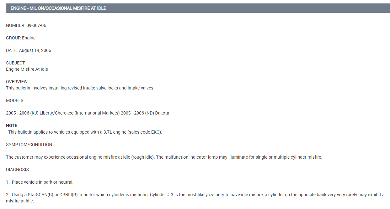

The next is to put things back together make sure your coils are secured clear codes.
First start engine and idling using a test light (remove injector cylinder one connector)check to see you a pulse light on test light while is idling.
Second if it is pulsing light it means you are okay there replace all spark plugs, and cylinder one ignition coil with a new one. Once you have done that erase codes again and scan again this time with ignition on engine off, if no codes show then proceed to start engine allow engine to idle and watching the tester to see if any other codes appear then p0300, listen is the engine misfiring, remember any small vacuum leak can cause a misfire indication.
Remember to replace the spark plugs.

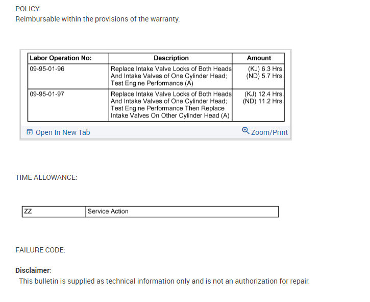

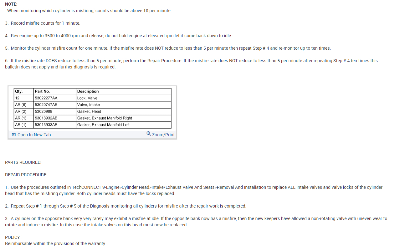

This technical bulletin possible that it applies to your vehicle.
To run this procedure you will need a tester that you can check live misfires on the tester it will show the cylinders what there are doing while it is running (it will show all cylinders and have 0 and when that cylinder misfires the 0 will change. Then when it is misfiring it should change to for instance 100 + or -. Write witch cylinders show misfires.
See chart on Technical Service Bulletin.

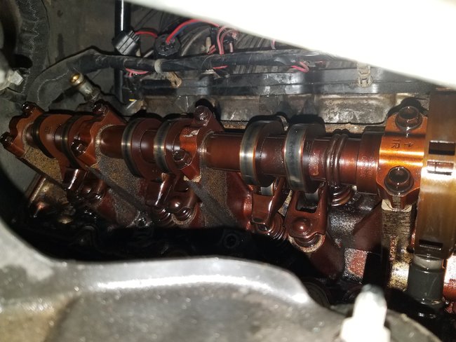

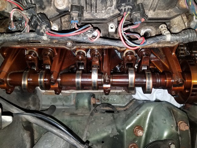

Dropped a little oil in cylinder number 6 this morning and did a compression test and got no change 50 PSI. I'm suspecting something in the valve train. Apparently these engines are known for breaking the rockers or displacing the rockers. Also dead lifters. Obviously stuck valves and dropping the valve seats which causes the stuck valve. Looks like the valve covers coming off.

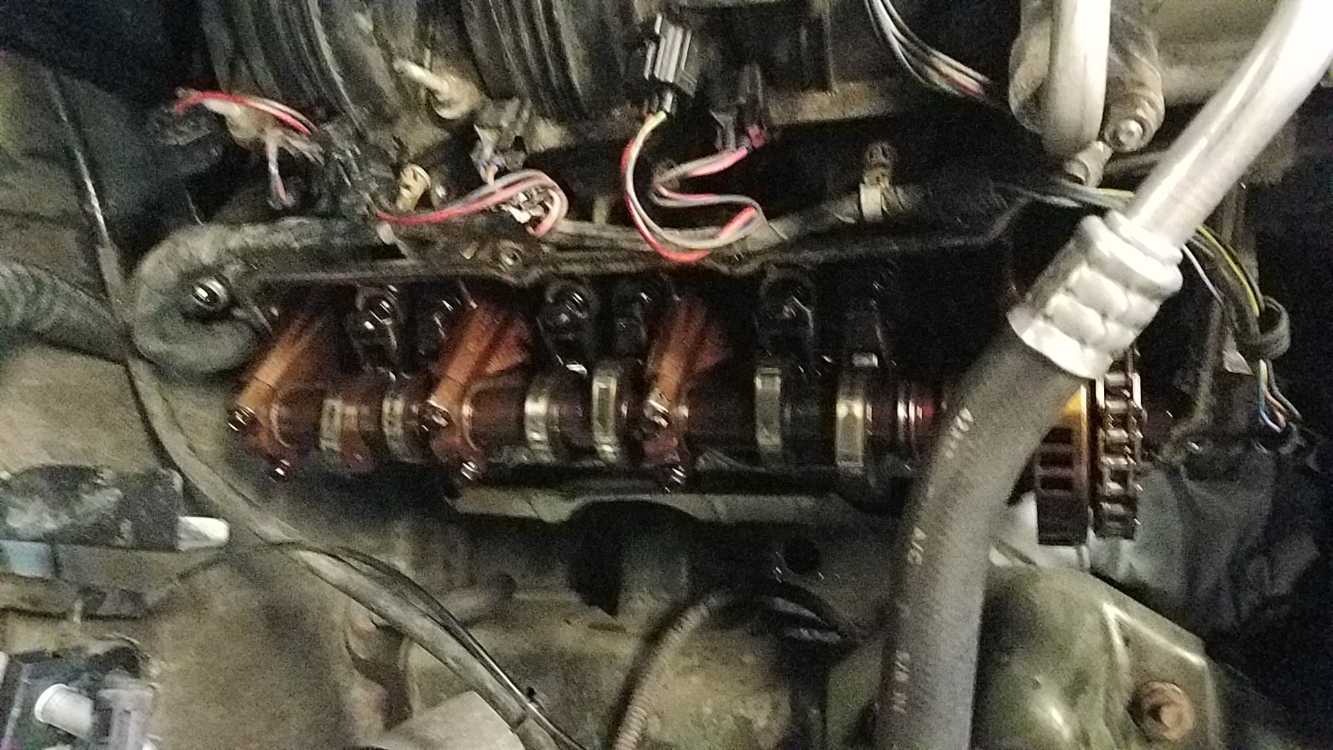

I don't see anything out of the ordinary underneath here. Everything looks intact. How do I turn the engine over by hand so I can watch the valve train? Do you have any other suggestions?

It is time to tear down start with valve covers you will be able see cam lobs and move your way down, if you had a bore scope you can see inside, valve and combustion area. The best way is rebuild short block ask around for prices.

Pull the plugs out and use the drive belt to turn it over. Been able to do that on many 3.7s. If nut a strap wrench on the crank pulley with the belt off works. Or a faster way would be to use your compression tester. Pull the one way valve out of it and use it like a leak down tester. Rotate the engine so both lobes on 6 are up, apply some air pressure, air rushing out the exhaust or intake (they normally drop the exhaust seats) and you have the culprit. If it's a bad seat the rocker is going to be very loose as well on that valve.

I don't really know what I'm listening for I'm getting air leakage into the intake manifold when the intakes are up. I think that's where the air is going and I was getting some air out the exhaust. If you could explain this a little more I could test again.
Friday, April 23rd, 2021 AT 12:26 PM
STEVE W.
  • 13,573 POSTS
Okay, if the lobes on the cam are up so the valves should be closed because the rocker arms are on the lowest part of the cam you shouldn't hear any air through the intake or exhaust, you might hear a little through the oil drains because no piston seals perfectly, but if you are hearing air out the intake the valves are bad and the heads need to come off. At that point it doesn't matter if it's intake or exhaust as they are leaking. Those engines tend to lose the valve seats or the lash adjusters will pump up hard and the rocker will push the valve down and just touch the piston as it returns and you get a leak.
