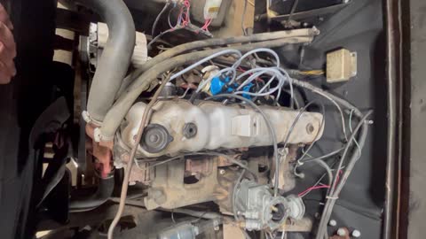

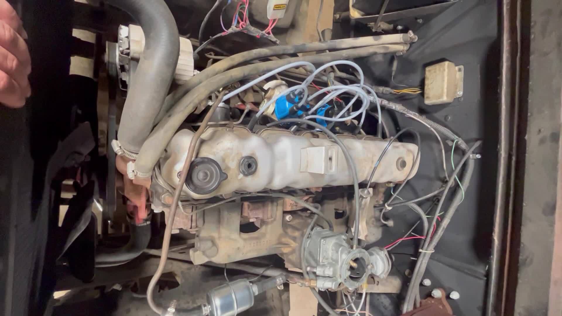

Here’s a video with better description.
Aug 4, 2023 at 2:47 PM
  • 110,244 POSTS
The video didn't fully upload. It lasted about 4 seconds. LOL Could you try to upload it again?
Aug 4, 2023 at 4:03 PM
TOM WAGNER
  • 7 POSTS
I uploaded it again.

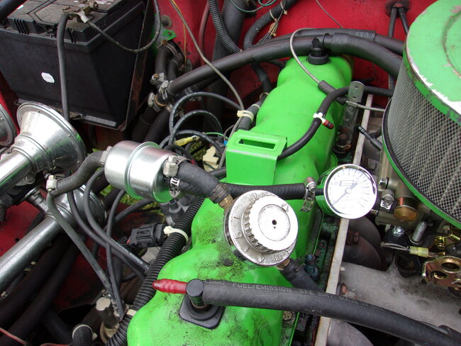

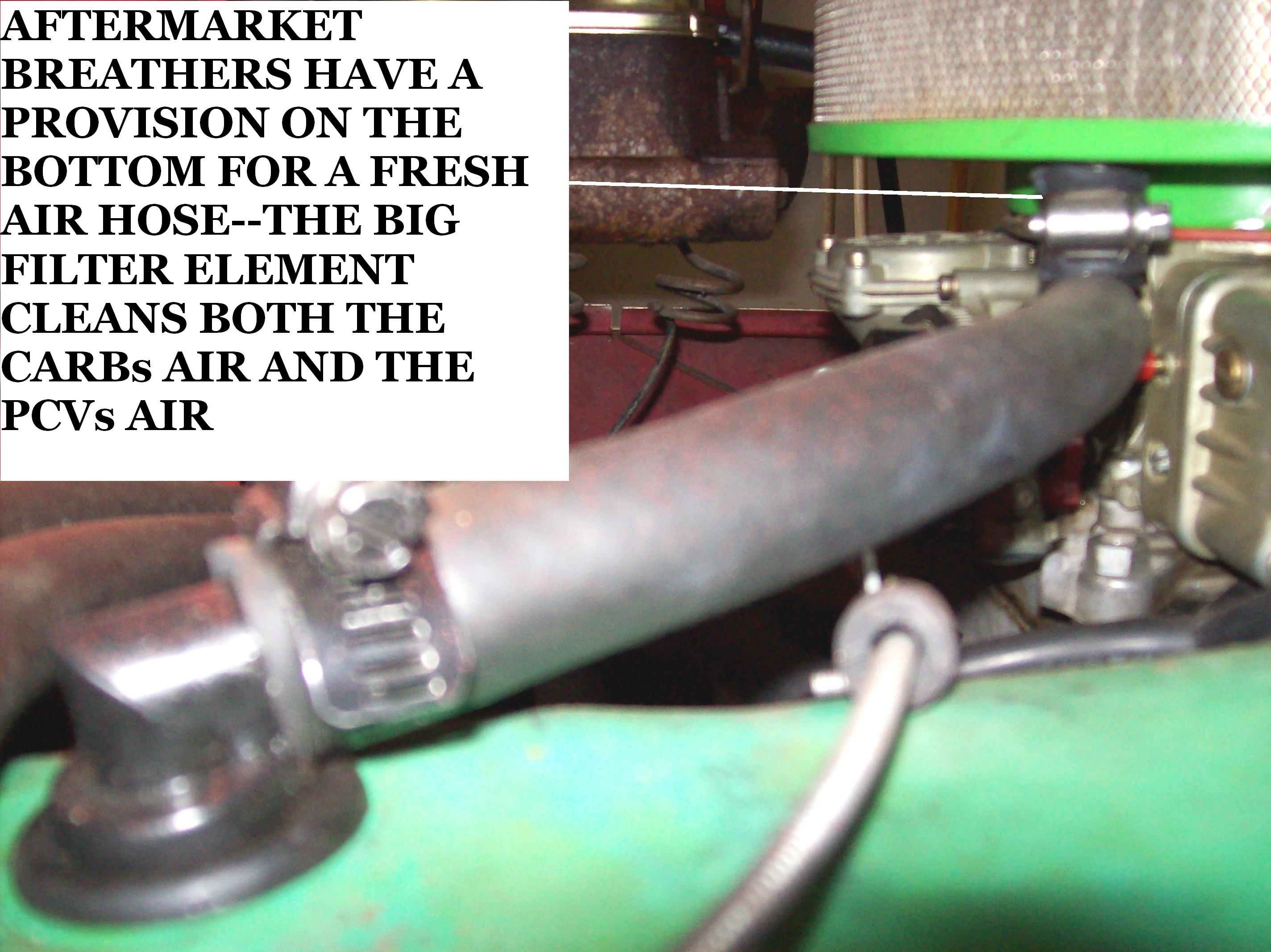

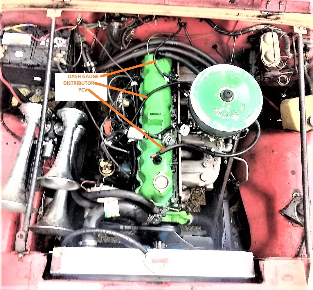

Lets start out with your PCV system!

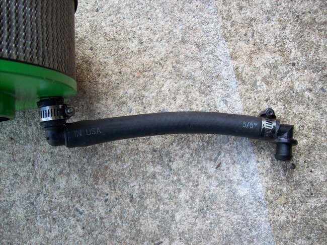

Use the correct PCV valve for your year--in the front hole--with a good snug grommet. The back hole is "Fresh Air" for the PCV (not EGR) it should have tight grommet and a fully open elbow extracting air from your breather.
(the best place, as you normally change the filter element and would not worry with changing a separate one).
Your carburetor kinda sucks the bad combustion gases out of the engine, that replenishes clean air inside, and the carburetor was designed to use that "extra air or controlled vacuum leak (if you will)" to mix with fuel so your engine can be tuned properly at idle.
Depriving that air makes it nearly impossible to tune correctly. (never use a 2nd PCV valve as an elbow at the back, it "checks" (and blocks/ closes) if air is drawn backwards through it.
My next posting will be about your vacuum lines and vacuum operated stuff.

Hey, thanks for the detailed response! I’m not looking to pass emissions as I live in Michigan. I just want the Jeep to run good. I do have the proper PCV valve tubes, I had them off just trying to experiment with the running issues.

I do not have a return line to the fuel tank. Also, so what you’re saying is to not block off the EGR valve? I made a cover for it today to see if it made any difference, it didn’t.
Also moved around the distributor a little bit while running to see if maybe that would make a difference, still none. I did notice the difference in run quality but no difference to my throttle issue.
I have noticed that the cart YF is in pretty mint condition on my Jeep, makes me think it was new old stock or something. I’m wondering if maybe it needs different jets.
I pulled the plug today and purchased a Weber 38 kit. If that magically fixes things then I guess I’ll have my answer lol.

In your video, I thought, that You thought, the back hole in the valve cover was something to do with the EGR??? The back hole is for fresh air (I explained that in the last post)
Blocking the EGR is fine! If you installed headers, you would have to do it.
We need to make sure there are no vacuum leaks anywhere---which includes uncapped (sucking) ports!
Without power brakes, only 2 vacuum lines are needed to run the engine.
The PCV
and
The vacuum advance to the distributor
I have an extra one going to an "in dash" vacuum gauge.
Without a few tuning tools, it's nearly impossible to "wing it by ear".
Your PCV valve needs to be fed by Manifold Vacuum from a larger port.
This will be a Port anywhere "Below" the throttle plates in the carburetor, it will constantly suck air. It can be used from the intake manifold, not just the carburetor.
The distributor "normally" uses ported vacuum, some folks think that manifold vacuum is better. Lets do ported for now!
Ported vacuum is generated "Above" the throttle plates in the carburetor.
It is vacuum that "comes alive" as you increase the engine speed (a vacuum gauge connected to the port would easily show this happening.
Usually just cracking the throttle plates open slightly will make a port begin to suck.
Everybody else needs a vacuum cap or a piece of tight fuel line and a bolt
to eliminate any sorta vacuum leak!
This link might also help explain setting things up similar with yours.
https://www.2carpros.com/questions/jeep-cj7-1985-jeep-cj7-stalls-when-hot

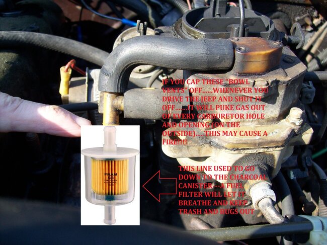

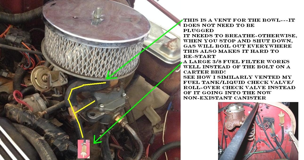

On the front of your carburetor, on the right, you have your fuel line feed coming in. Beside that, on the left, is an Open port (DO NOT CAP IT!) It is your "Bowl Vent", Normally it would hook to a charcoal canister.
No canister? It still needs to breathe! I have a pic of a Carter BBD and a similar way of how you can do yours using a sacrificial fuel filter hooked to nothing.

So, the PCV valve needs to go below the throttle in the carb? It was situated on the top of the carb when I got it. There are no connections on the intake I can use but there is one large one at the bottom of the carb. It was plugged with a hose and a bolt when I got the Jeep. I thought that would be a fuel return line.
I’ll have to reread your comment when I’m next to the Jeep to try to figure out where to put the vent and filter in place of the charcoal canister.
I’m not entirely sure that there’s suction from my pvc. I know there’s positive flow blowing out of the back end of the valve cover, like flowing out, not in.

As far as the PCV, the valve should be in the valve cover and the other end does go to the bottom of the carb. The hose you mentioned as being plugged is the likely vacuum source.
Let us know if that helps.
