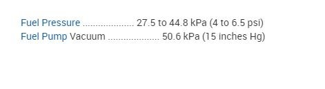

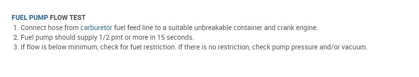

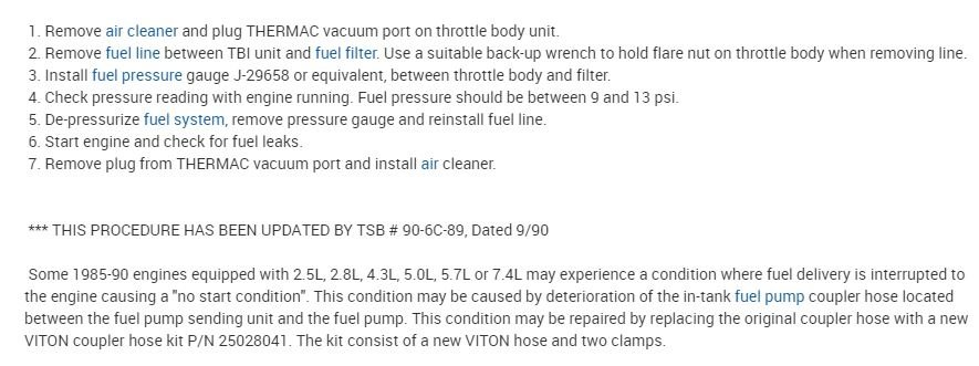

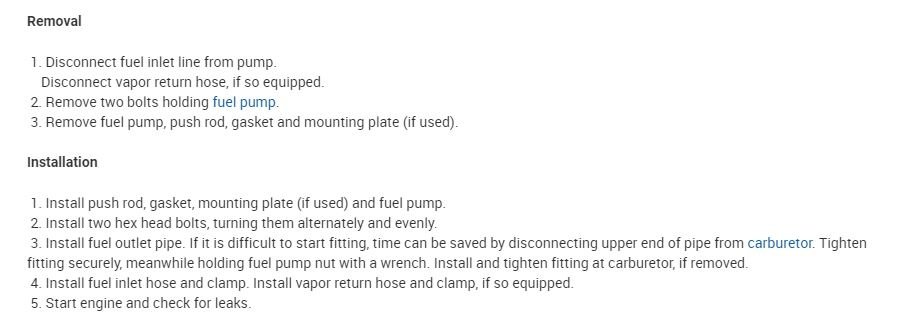

I have the truck listed above K2500 4×4 3/4 ton truck converted it to quadrajet 4 barrel carburetor new and street fire distributor which is new was running great but now goes 3 or 4 miles and acts like it's running out of gas. Sits a few minutes and cranks back up then does it again. Is it vapor locking?
Friday, February 7th, 2020 AT 1:46 AM
  • 52,797 POSTS
Good morning,
It could be. The fuel pump on the side of the motor should deliver about 7 pounds of pressure to the carburetor. If it does not, then the fuel could boil and this is the result.
