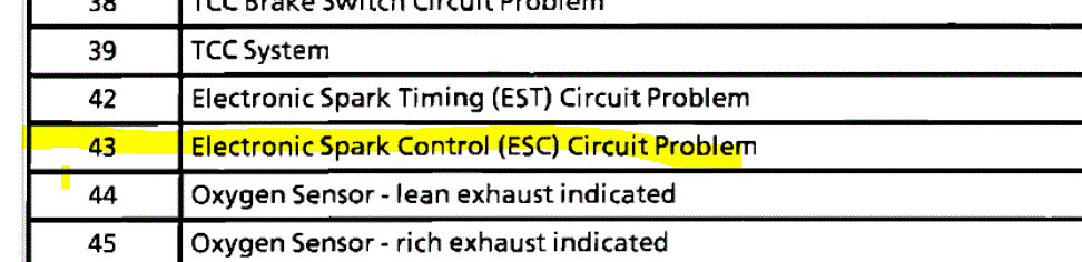

It is giving 12 and 43 codes. These parts have been changed: spark plugs and wires, fuel pump and fuel filter, cranks shaft sensor and throttle position sensor.
Sep 4, 2021 at 6:21 AM
  • 110,240 POSTS

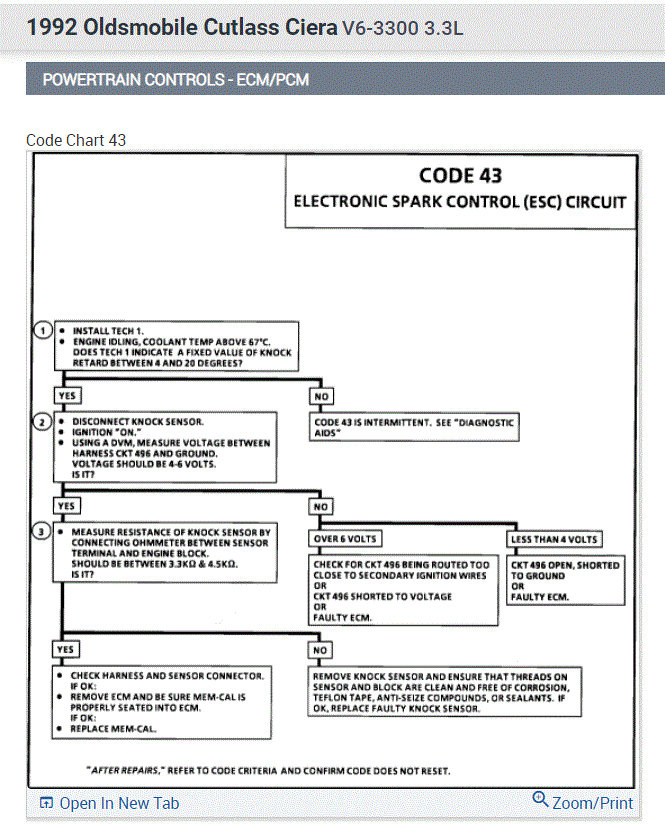

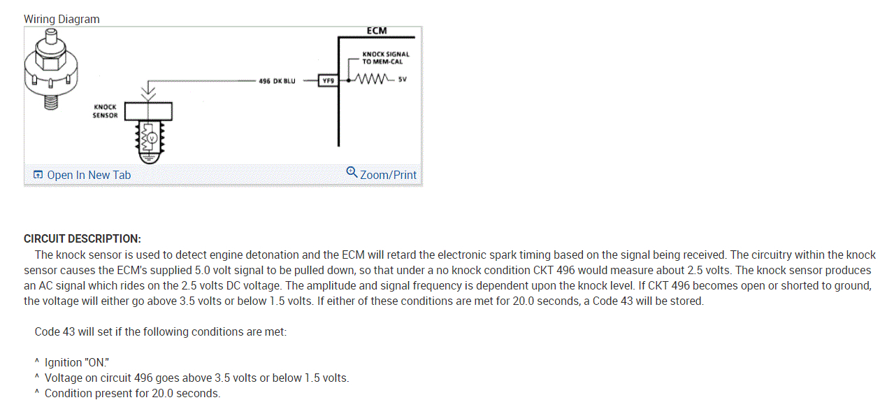

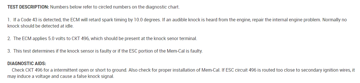

Code 12 means the diagnostic system is normal and functional. Code 43 is related to the knock sensor (ESC), electronic spark control. Do you notice a knock or ping sound when the vehicle is under a load?

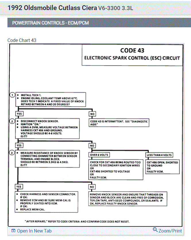

Also, I attached the diagnostics for code 43 below.
