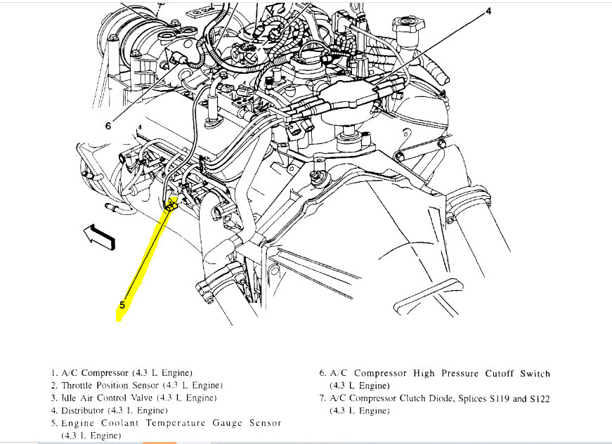

so, i have the vehicle listed above, basically a Chevy s10. but i noticed it wasn't getting to running temperature, gauge goes to about 80 degrees, i changed the thermostat didn't help, change the fan clutch it didn't help, but honestly I'm not to sure how this type of fan all works seems like its always drawing in air. would there be a fuse or relay? maybe a sensor? comes on right away. trucks at 96321 miles/ 155,000km.

I ask because the coolant temperature sensor may be faulty. Heat causes the resistance to change in the sensor that the ECM receives. Based on that information, the gauge adjusts.
I attached a pic below showing the location of the engine coolant temperature sensor. Inspect the wiring to it for damage. Also, confirm the connector is tight, undamaged, and free of corrosion.
If that appears good, then see if you can get your hands on an infrared thermometer and confirm the radiator and engine are actually 80 degrees. That sounds too low even if the thermostat was stuck open. Also, if it is 80 degrees, the heater will hardly produce any warmth.
Let me know what you find. Also, let me know if you are in an area that has extremely cold weather.
see pic below.
