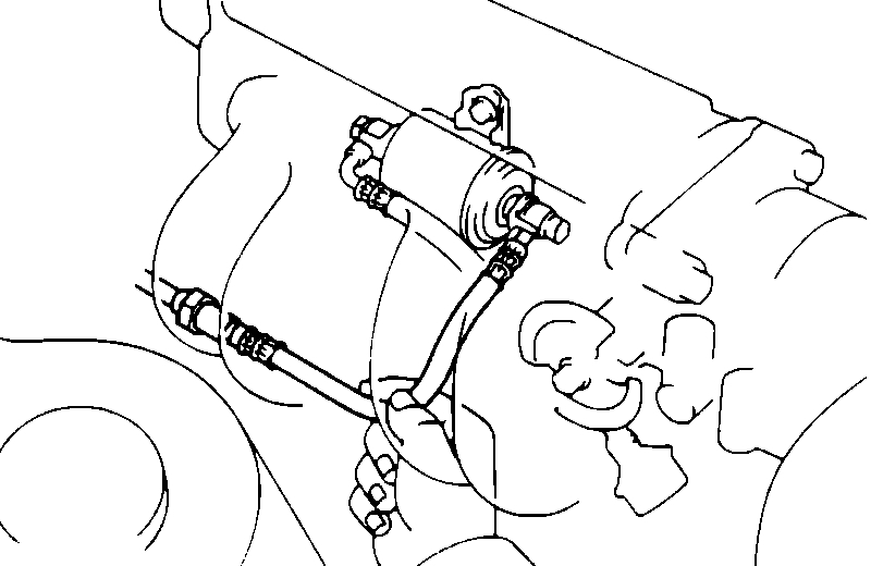

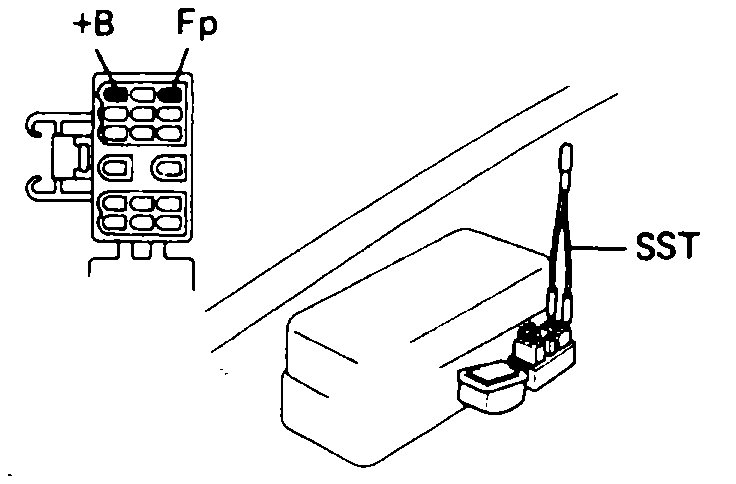

Here are directions specific to your vehicle for testing fuel pressure. The attached pic correlates with the directions.
1991 Toyota Truck Pickup 2WD L4-144.4 2366cc 2.4L SOHC (22R-E)
Fuel Pressure Test
Vehicle Powertrain Management Fuel Delivery and Air Induction Fuel Pump Fuel Pressure Testing and Inspection Component Tests and General Diagnostics Fuel Pressure Test
FUEL PRESSURE TEST
1. Turn on the ignition but DO NOT start the engine.
2. Connect terminals +B and FP of the check connector with a service wire.
pic 1
3. Check that there is pressure in the hose to the cold start injector and that you can hear fuel return noise from the fuel pressure regulator.
Checking The Fuel Inlet Hose For Fuel Pressure
pic 2
4. Remove the service wire and turn the ignition off.
5. If there is no pressure check the following parts:
a. Fusible link
b. Fuse (EFI 15A, IGN 7.5A)
c. Circuit Opening Relay
d. Perform pressure test with fuel gauge, refer to FUEL PRESSURE REGULATOR/FUEL RAIL
e. Wiring connections to Fuel Pump
6. If no problems are found, replace the Fuel Pump.

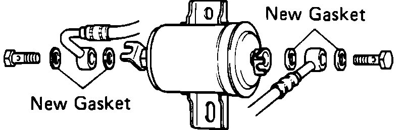

Here are the directions specific to your vehicle for filter replacement.
Procedures
Vehicle Powertrain Management Fuel Delivery and Air Induction Fuel Filter Service and Repair Procedures
PROCEDURES
NOTE: If vehicle has been operated within an hour, the fuel system is probably under pressure and requires caution when removing filter union bolts.
REMOVAL:
1. Locate the fuel filter on the right side of the engine.
2. Slowly loosen the filter union bolts. Some gasoline may escape, so ensure that the potential for fire is minimized.
3. Remove the union bolts and four gaskets.
4. Loosen filter clamp and slip filter from clamp.
INSTALLATION:
1. Slip new filter into clamp. Ensure that flow arrows are in the correct direction.
2. Position filter in the middle of the clamp and tighten filter clamp.
Replacing The Fuel Filter
pic 3
3. Reinstall both union bolts with four new gaskets.
4. Torque union bolts to 18 Nm (13 ft lbs). DO NOT overtighten union bolts.
5. Clean any gasoline that may have escaped.
6. Start the engine and check for fuel leaks.
