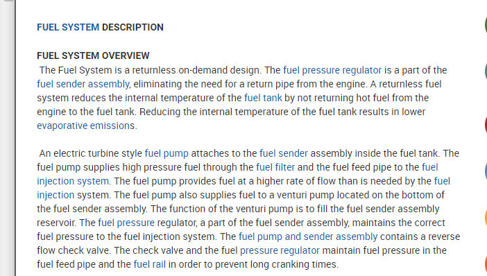

After running it for a little while it starts spitting and sputtering and loses power
2005 GMC SAVANA
210,000 MILES • 5.3L • V8 • 2WD
KENVIVIS
The first probably 30 minutes of it running it runs fine then it starts spitting and sputtering and loses power. if you shut it off for a few minutes it’s fine for a little bit then does it again. Changed all the plugs wires fuel pump. It doesn’t have a return fuel line so after some research I’m thinking it might be vapor locking. What do you think and if that’s it can I just install a check valve on the fuel line between the tank and the motor?

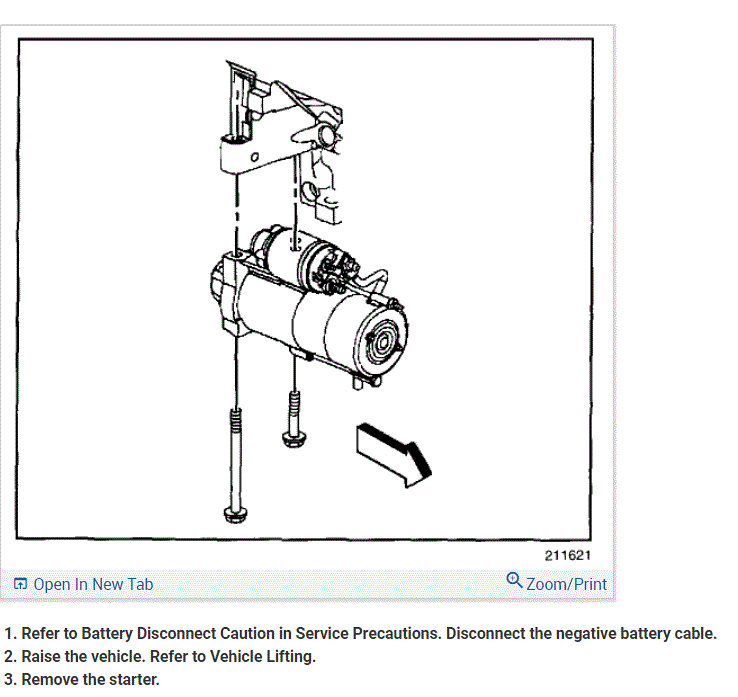

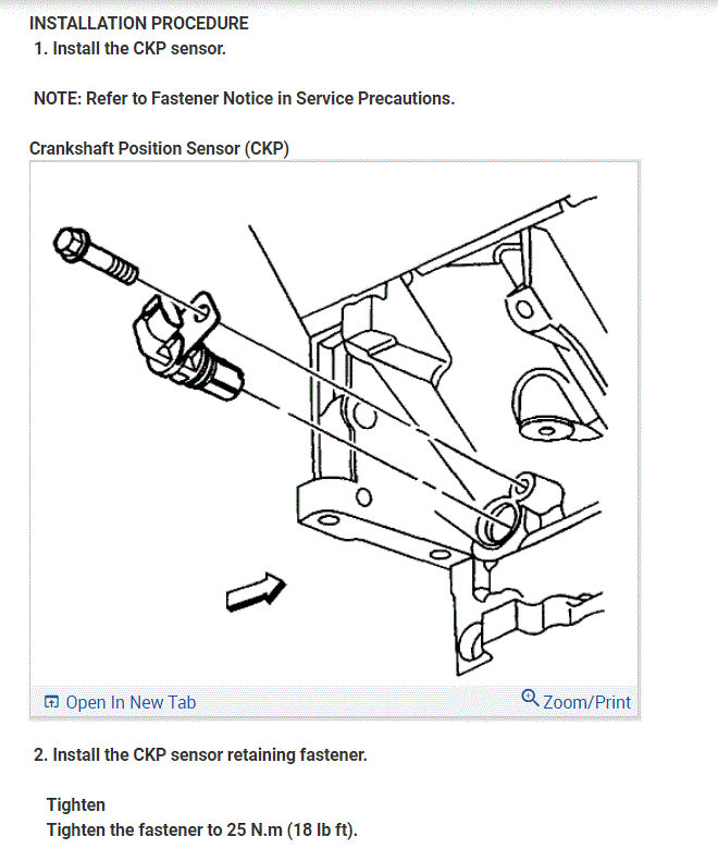

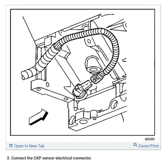

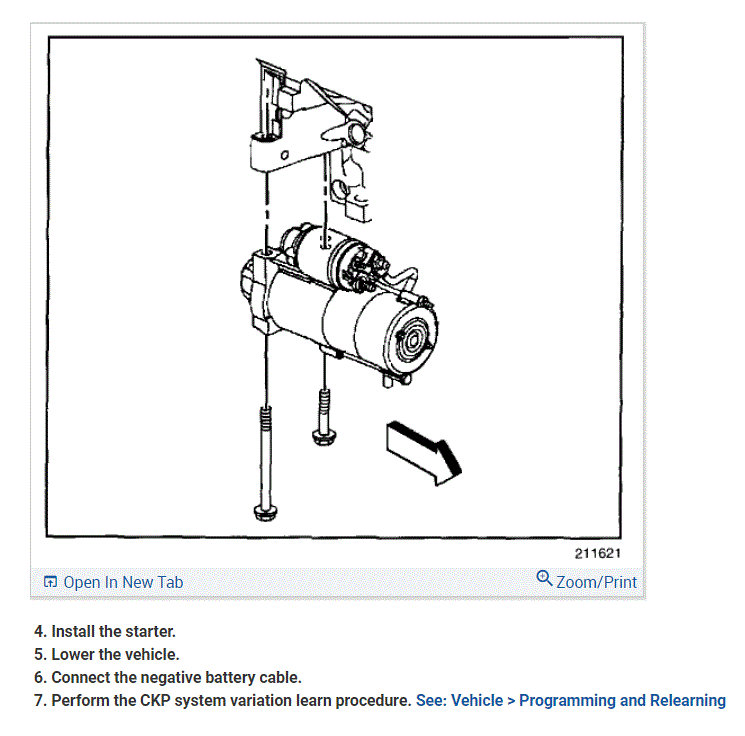

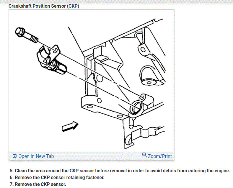

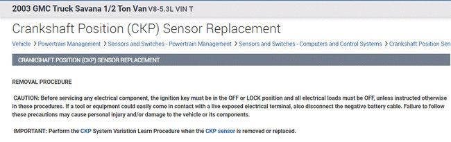

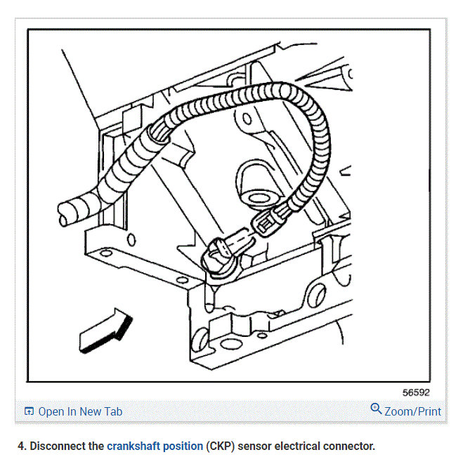

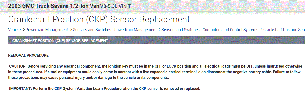

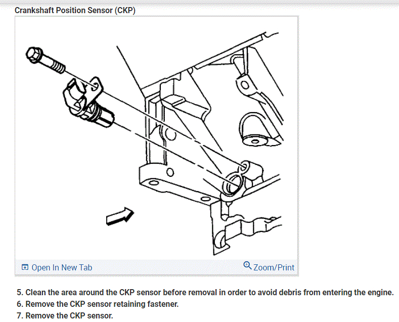

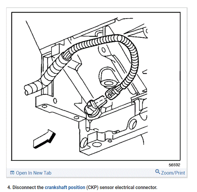

What you are describing sounds like it could be related to the crankshaft position sensor. When these sensors begin to fail, they are affected by heat. When they get hot enough, the engine loses spark and shuts off or runs poorly. Then, if you give it a chance to cool a bit, it runs again.
Do me a favor. Take a look through this link. It describes the most common symptoms related to the crankshaft position sensor.
If you feel that mirrors what you experience, you can check if spark is lost when the engine won't start. You can do that using a live data scan tool, watching if the RPM gauge moves a bit when cranking (it won't if the sensor is bad), or you can check for spark at the plugs.
Here is a link showing how to test for spark:
If you find no RPM signal or no spark, the first suspect is the sensor. Here is a link that explains in general how it is done:
If you look at the attached pics below, they provide the directions specific to your vehicle for replacement.

This does sound like a fuel issue but if it is vapor locking then the engine would normally stall. What I would do is start with checking the fuel pressure while the engine is running so that you can monitor it while it starts to run poorly.
Here are a couple guides that will help with this issue and checking the fuel pressure:
https://youtu.be/U1RoG3I-Oww
You are correct that this is a returnless system but only way you would be getting a possible vapor lock is if the fuel is overheating and atomizing before it gets to the cylinder.

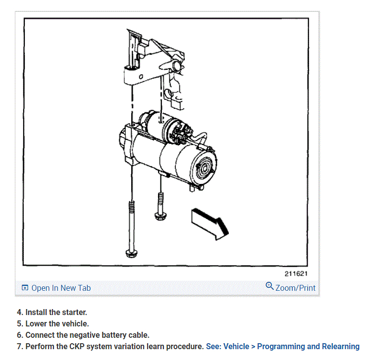

Take a look at the info attached for this system and let's check the pressure when this is happening and that will tell us what steps to take next. If this checks out, I am thinking we have an ignition issue and possible crank sensor issue. Here is a guide that will cover that but we can get there is this checks out:
