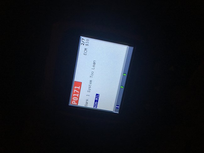

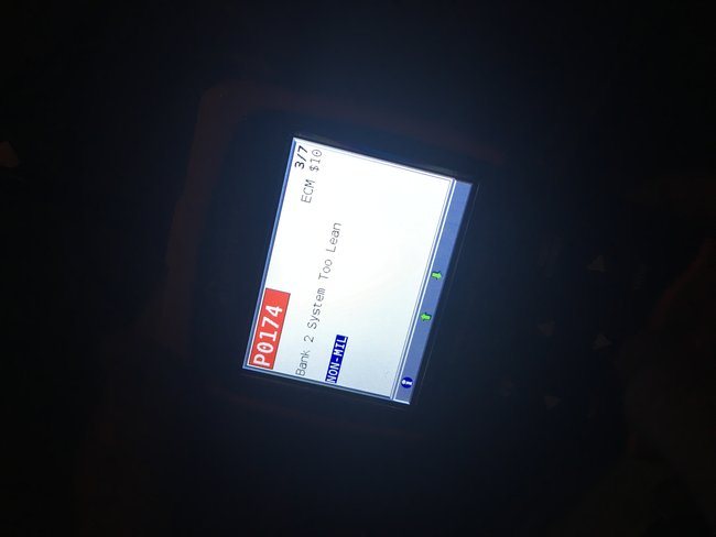

It does not have a vacuum leak and I think the mechanic said it has got enough fuel pressure but I will check, I cannot remember how many psi he said it had. It has got bank 1 and 2 too lean sensor set off and the evaporative emissions system purge control valve circuit code set off. It has got several of the same codes set off.

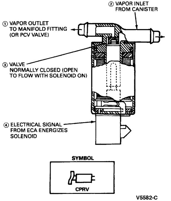

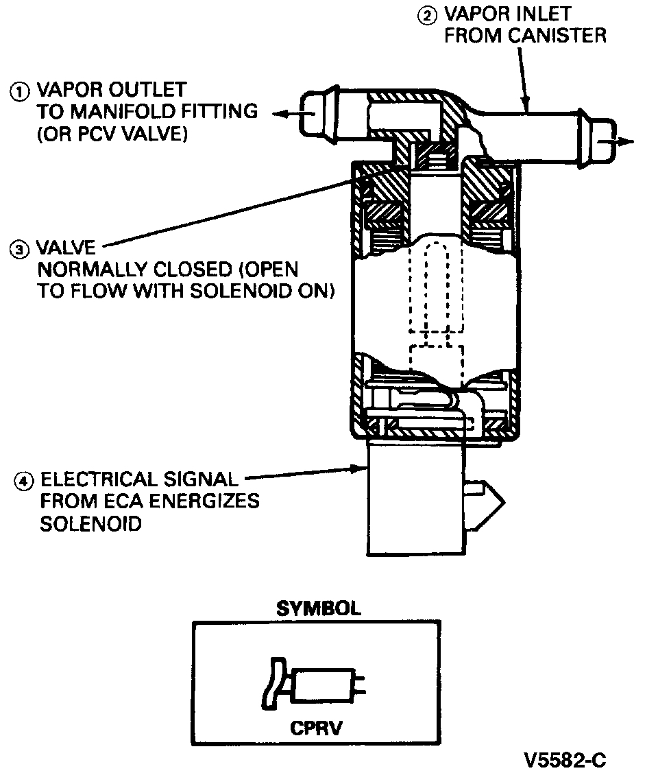

I feel the canister purge solenoid is stuck in the open position. As a result, you have excessive air entering the engine through the intake manifold. Both sides of the engine are lean, so it is one general item causing it. Since you have a code for the purge solenoid, I suspect that is where the problem is coming from. I attached a picture of the component I'm questioning. There is a valve in it which is to open at specific times for a specific amount of time to allow gas fumes from the tank to enter and be burned by the engine. The valve is energized electronically, but if it is stuck open, you are getting too much air.
Take a look at the attached picture.
Let me know what you find,

I replaced the canister purge valve and reset the codes and it threw the same codes back up and is still running lean. The guys at advanced auto parts said I need to finish a drive cycle so the computer will recognize the new part. Is that right?

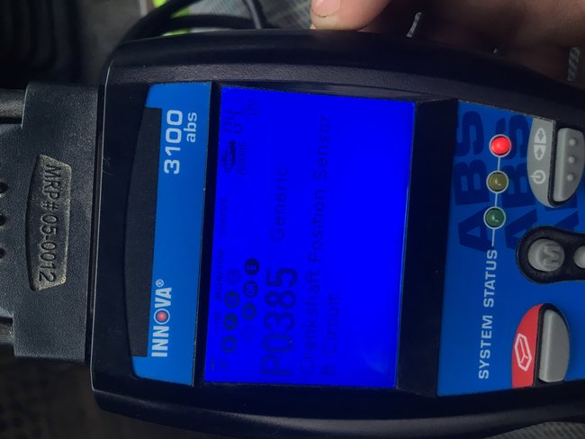

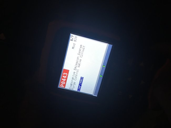

I have cleared my codes and I am waiting to see if they come back. I had a new code show up this time around which I have seen show up before but not often, it is some sort of crankshaft sensor, I will put the picture below. And sometimes it seems like the throttle sticks a little bit. Also I do not have a purge valve solenoid, I am not sure why. And is it worth going ahead and checking both fuel pumps to make sure they are working right?

The codes came back again and it is still running lean on bank 1 and 2 and it still got the evaporative emissions system purge control valve circuit code set off.
Nov 9, 2018 at 3:23 PM
  • 110,194 POSTS
If you are still getting the EVAP code and there are no vacuum leaks, it has to be an electrical issue to the purge valve. Have you checked wiring to the control valve?

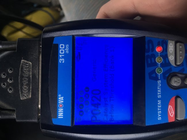

No, I am not getting a misfire. It is catalyst system efficiency below threshold is what it says. P0420
Nov 21, 2018 at 9:55 AM
  • 110,194 POSTS
Wow. You are not having luck with this thing. That usually indicates a bad catalytic converter.

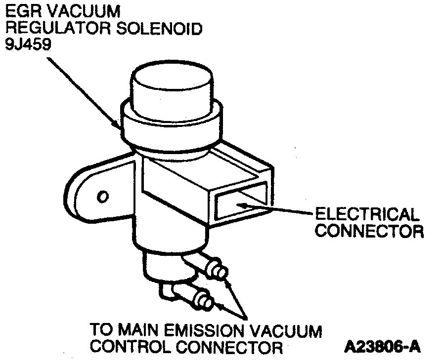

I want you to check one more thing for me, the EGR vacuum regulator. Here are the directions.
1. Disconnect battery ground cable.
2. Disconnect the vacuum hoses from the Exhaust Gas Recirculation (EGR) Vacuum Regulator Solenoid.
3. Lightly blow air into the EGR vacuum regulator solenoid and verify that air does not flow through the regulator.
4. Disconnect the electrical connector from the EGR vacuum regulator solenoid.
5. Apply battery voltage and a ground to the electrical connector of the EGR vacuum regulator solenoid.
6. Lightly blow air into the EGR vacuum regulator solenoid and verify that air does blow through the regulator.
7. If air does not flow through the regulator, replace the EGR vacuum regulator solenoid.
8. Connect battery ground cable.
NOTE: When the battery has been disconnected and reconnected, some abnormal drive symptoms may occur until the Power-train Control Module (PCM) relearns its adaptive strategy. The vehicle may need to be driven 16 km (10 miles) or more to relearn the adaptive strategy.

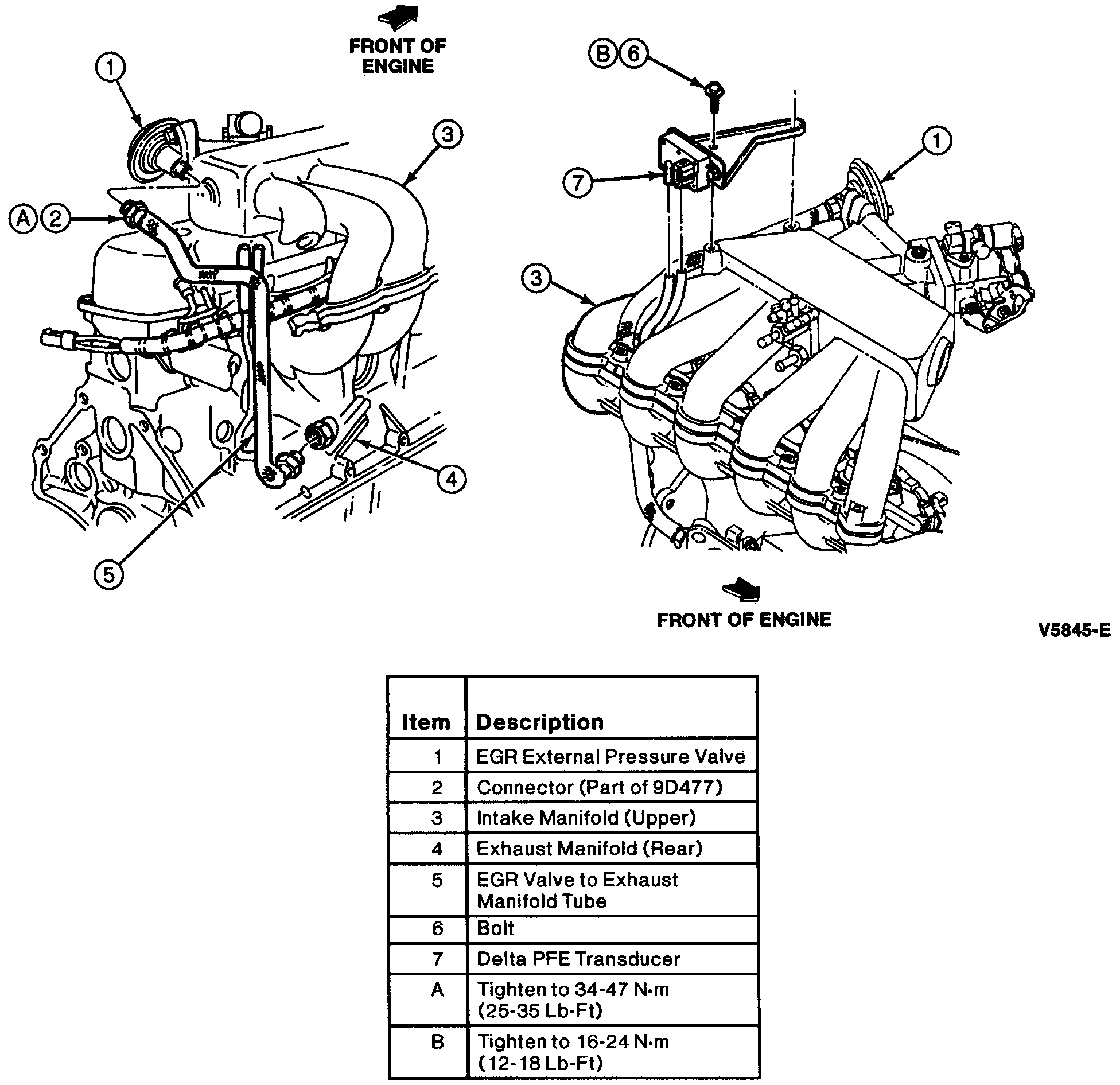

Also, I want you to remove the EGR and inspect both it and the intake for excessive carbon build up. Also, make sure the EGR works when you apply vacuum to it.
1 Disconnect the Exhaust Gas Recirculation (EGR) valve vacuum hose.
2. Disconnect the EGR valve to exhaust manifold tube from EGR valve.
3. Remove EGR valve retainer bolts and EGR valve from upper intake manifold.
4. Remove EGR valve gasket. Clean residue from upper intake manifold gasket surface.
