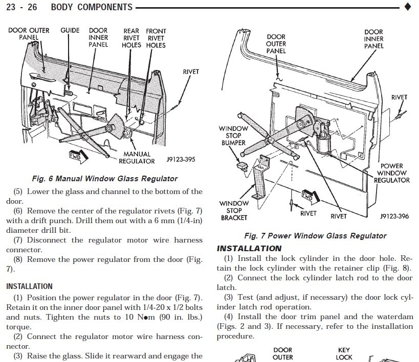

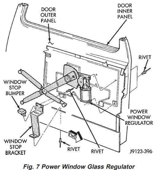

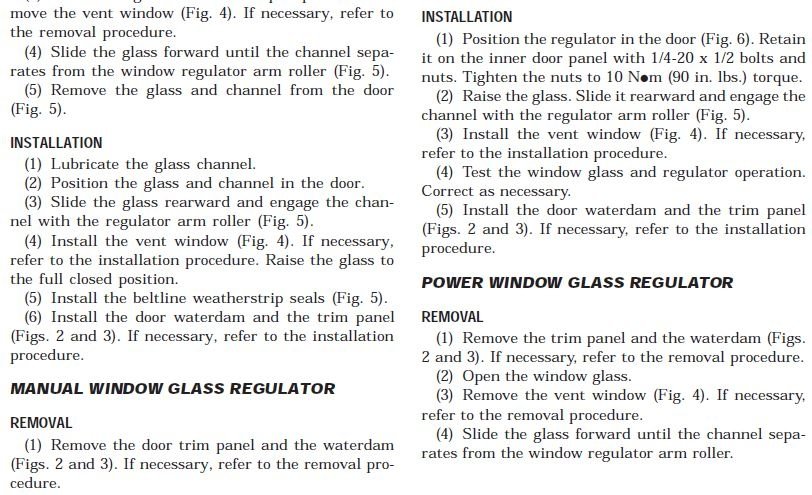

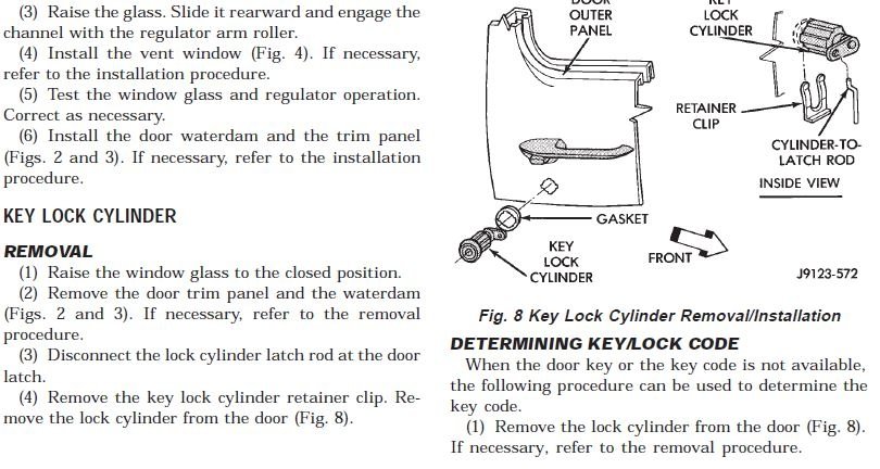

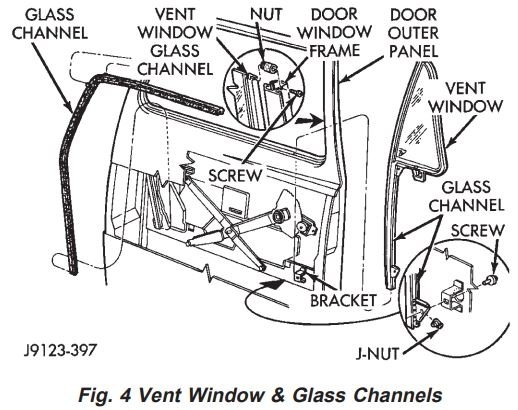

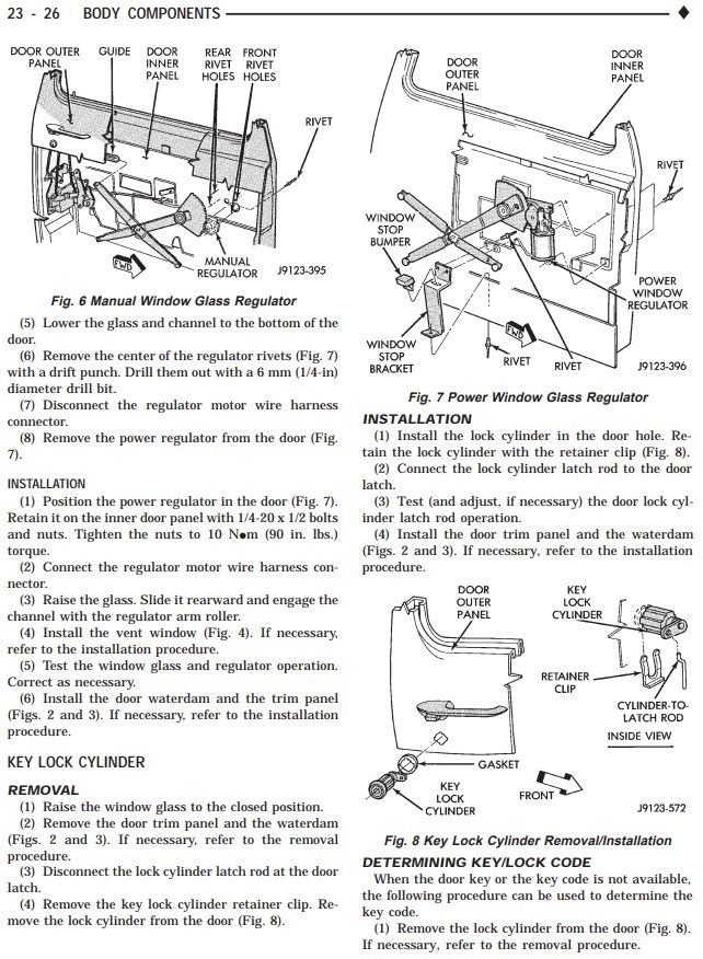

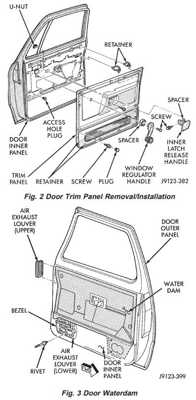

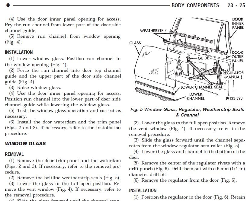

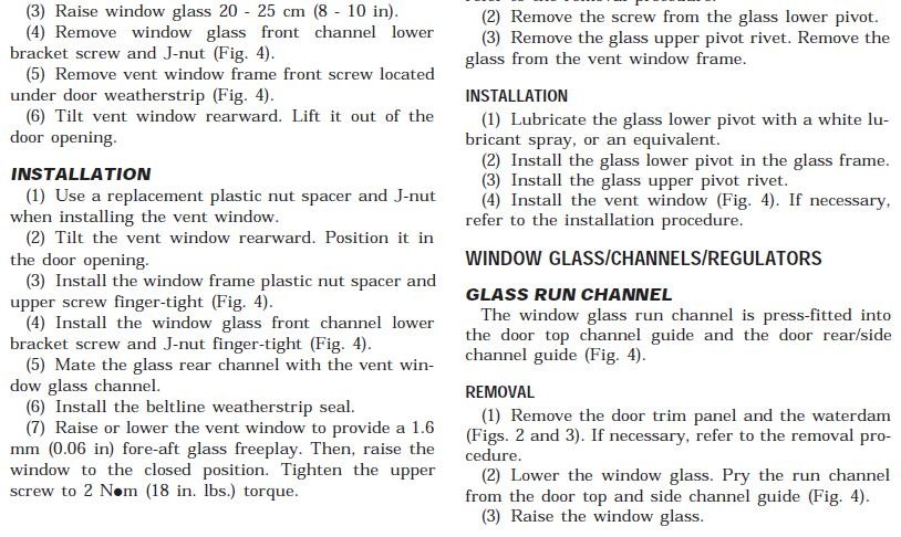

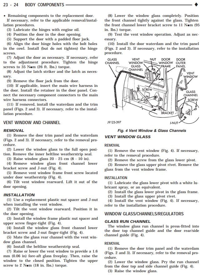

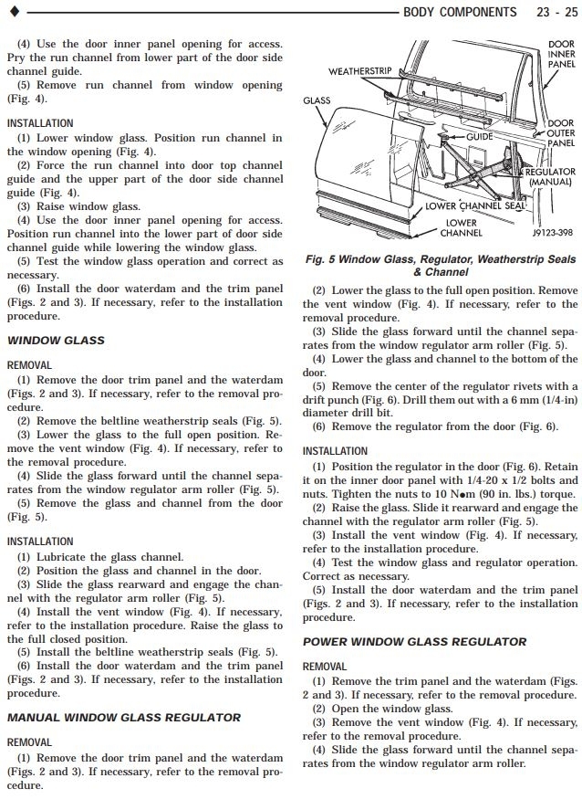

Attached below is the information you've requested. I had to split it up over several attachments to retain the resolution. I've included both the power regulator R&I as well as the vent window R&I. The vent window has to come out first.

Sorry, but the Info. (as presented ) was broken up in segments so that I couldn't read enough to see what to do, I.E. start on #4, next shows ref t6o a figure #,, but it's for a different part of procedure, Please try again, and make sure that it follows along consecutively, Not split up, coming into the middle of one procedure, and then in the middle of yet another. please make it consecutive so it makes sense, and I can also make good use of the illustrations, if I can see them with the text that they apply to. Thank you very much, J. B..

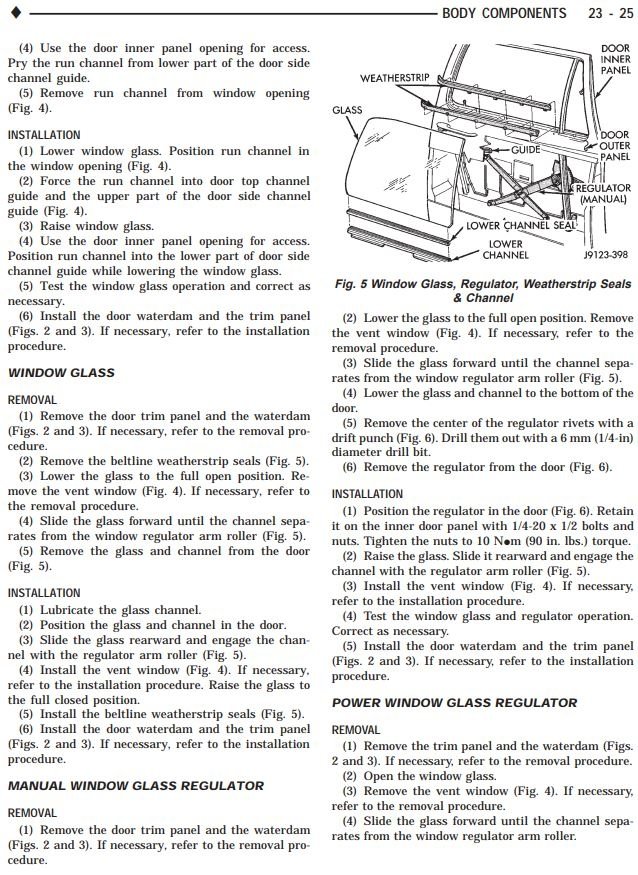

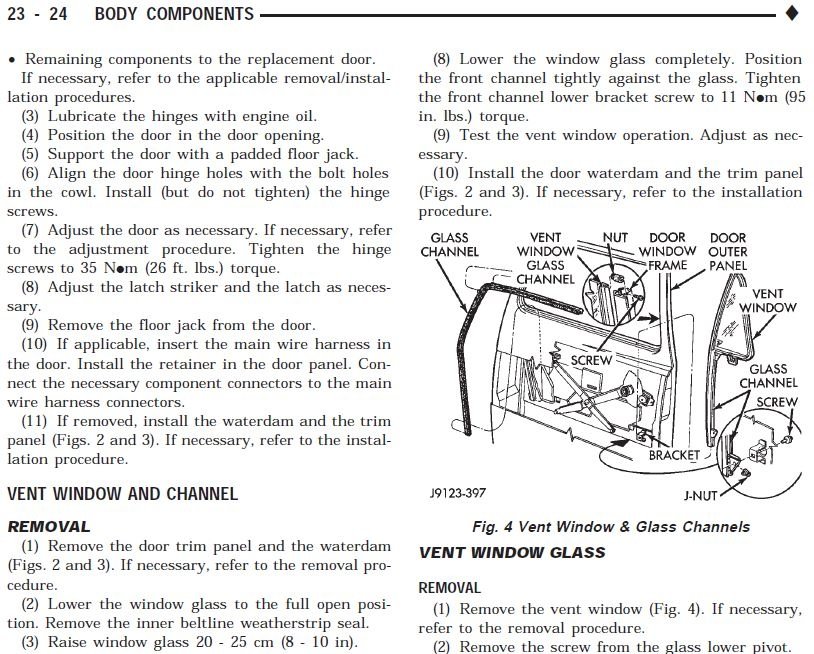

I apologize for the confusion. The attachments are actually laid out sequentially, however we try to take smaller screen shot segments so they are easier to read in this format. For example, the first screen shot is the top half of page 23-24 and the second is the bottom half of 23-24. The second set is page 23-25 and the third is 23-26. I have reattached the full pages below for your reference. There are also separate attachments of the figures not included on the pages with the repair procedure.
