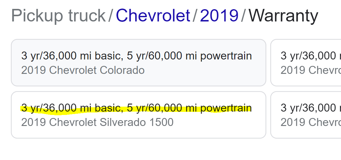

Keep in mind, if you feel there is a transmission concern, the vehicle's powertrain warranty is 5 years or 60K miles, so you are well within the limits.
See pic below.
