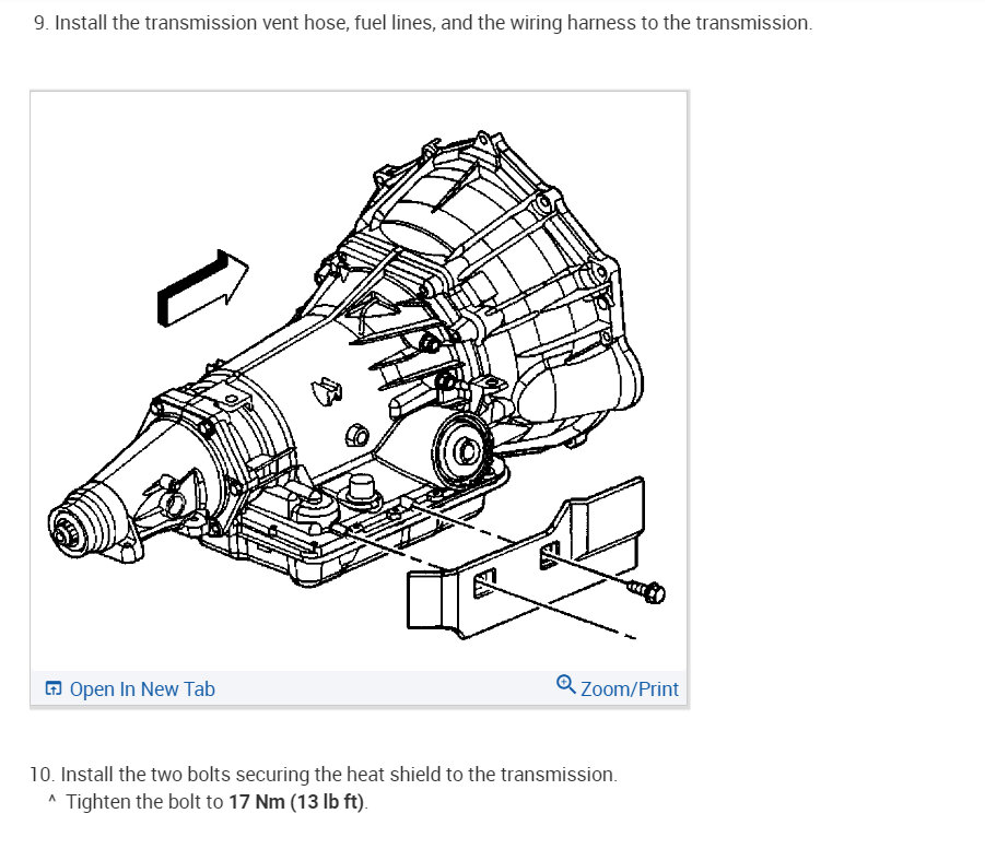

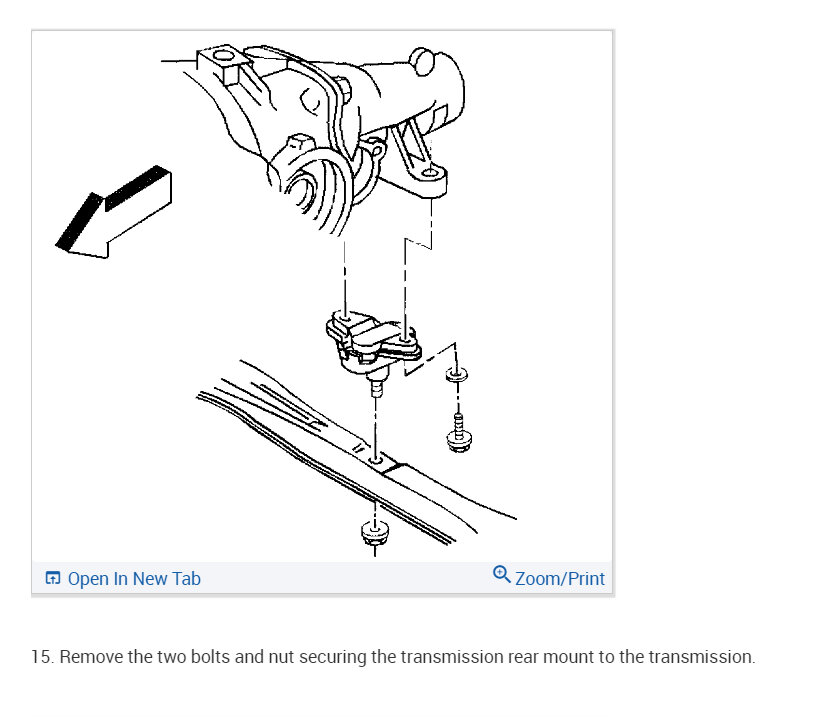

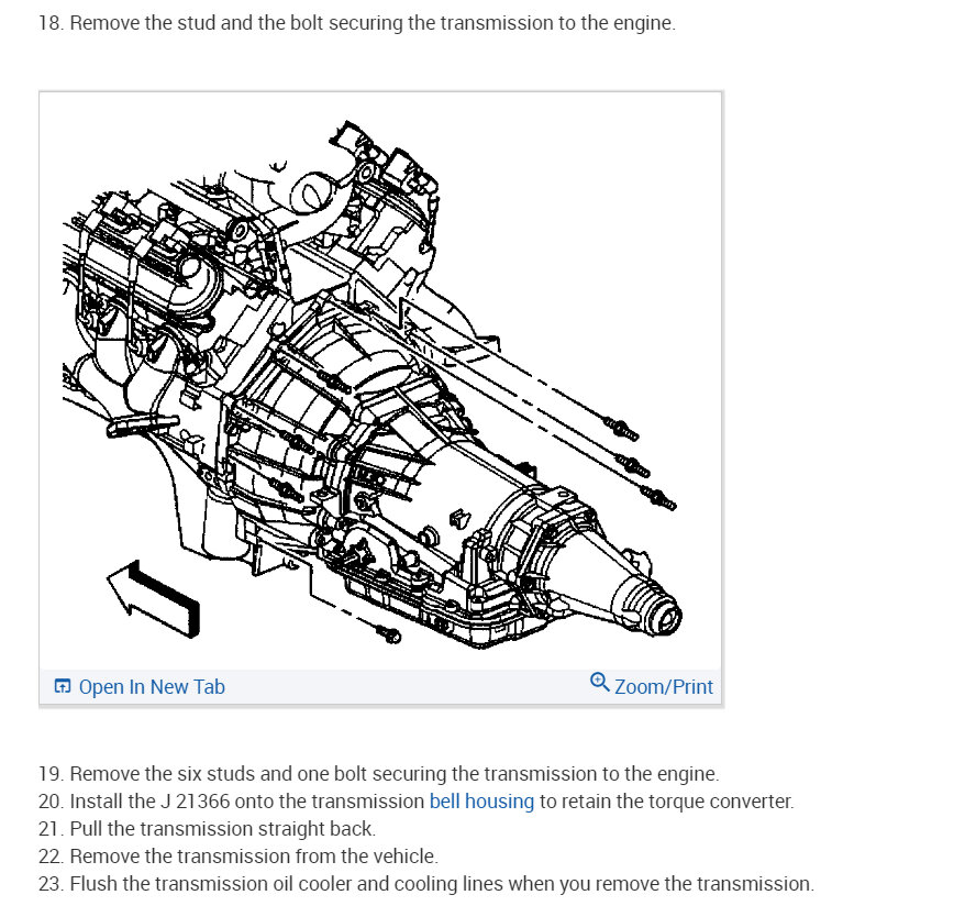

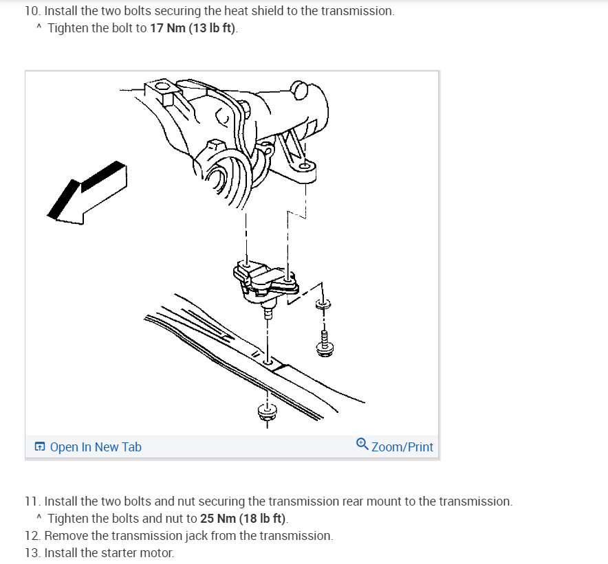

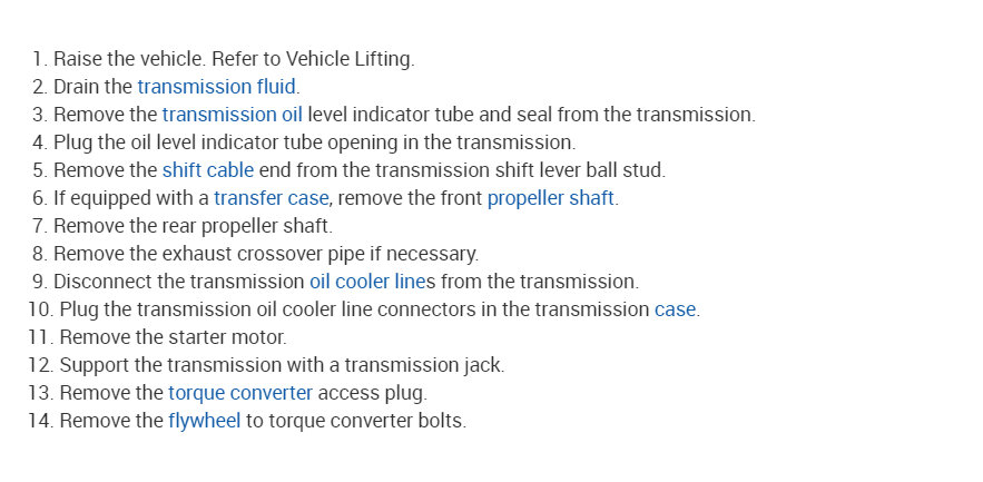

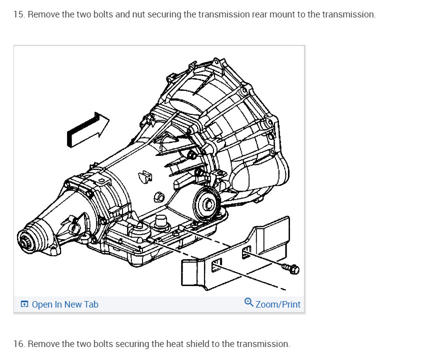

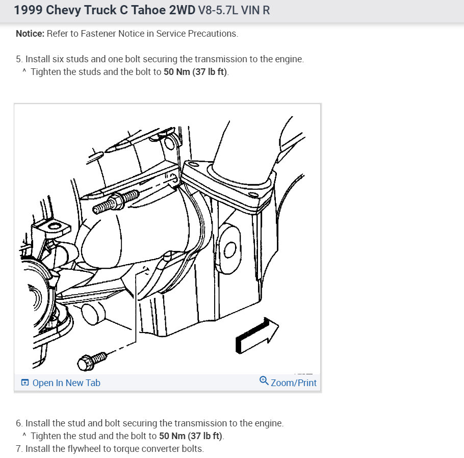

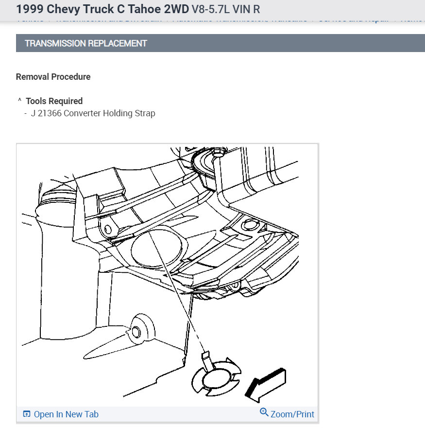

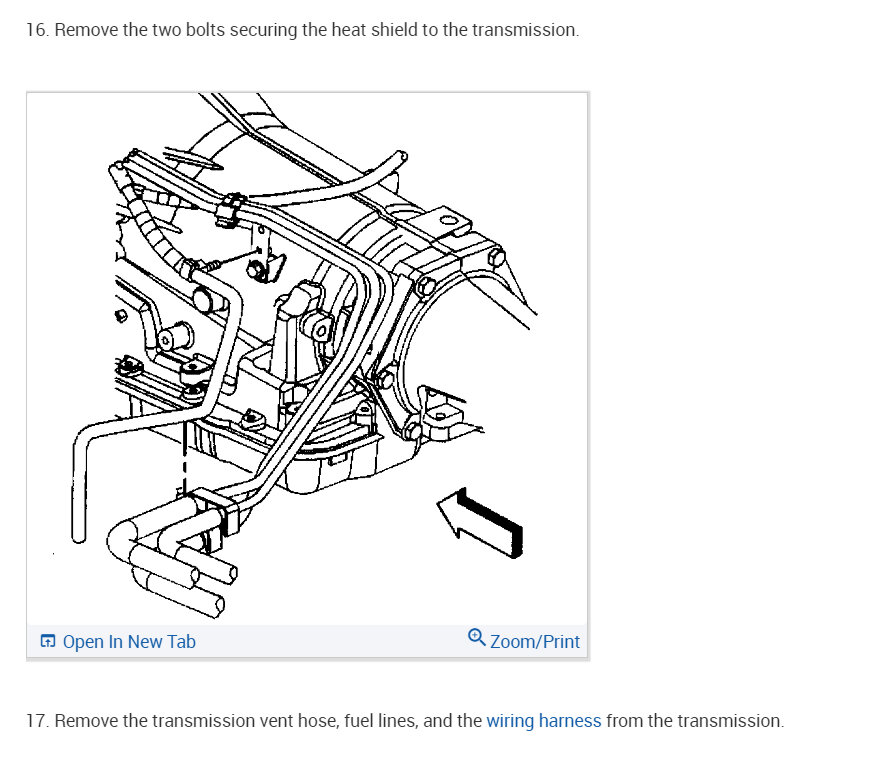

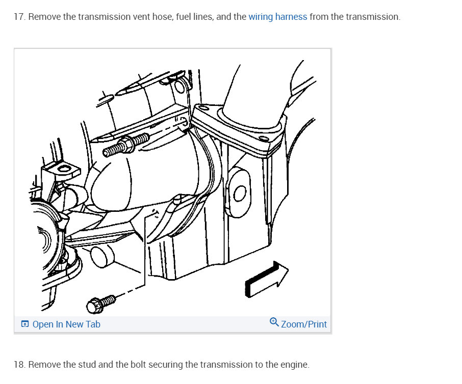

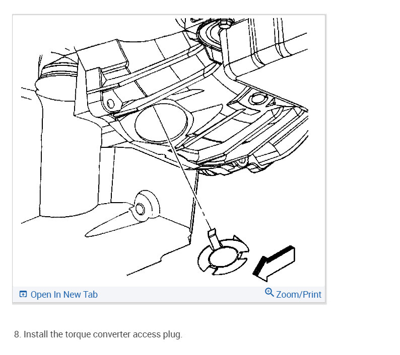

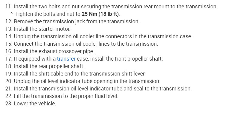

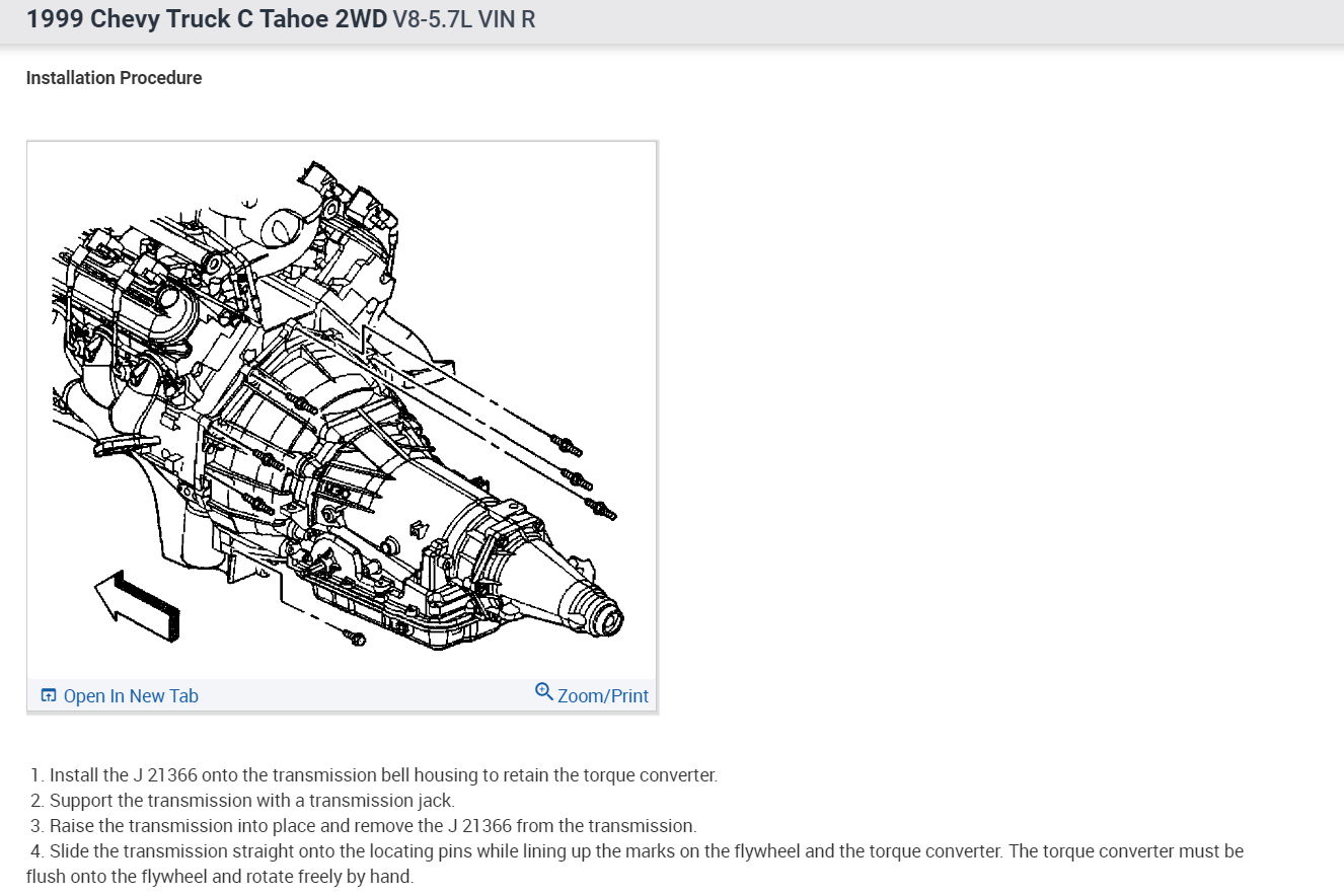

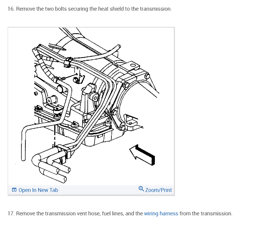

p1870 Code - Transmission Component Slipping so it seems like the transmission is worn out, but you can try a service to see if you can get a few more miles out of it with a new filter.
This guide can help you with the job:
If not here is how to remove the transmission for a rebuild. Also, this video shows the job being done on a different car, but the process is the same.
https://youtu.be/3vJAojsrfuU
