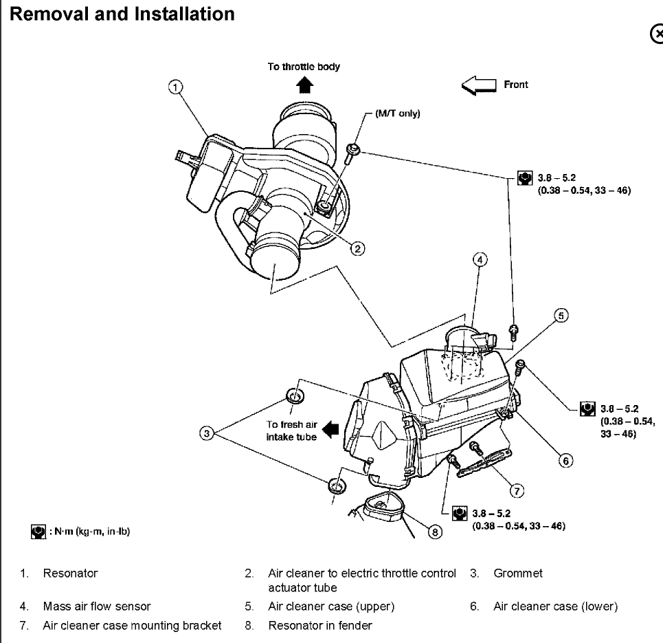

This sounds like a classic MAF sensor that is off but not enough to cause a check engine light which is normal. Here is a guide to help you replace the sensor with a diagram below on where the sensor is in your car:
https://www.2carpros.com/articles/how-to-replace-a-mass-air-flow-sensor-maf

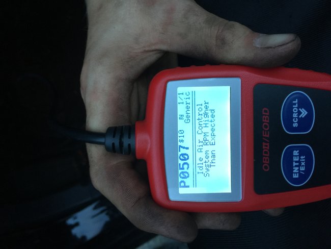

I replaced the MAF sensor. Mechanic disconnected the battery and then reconnected it because it was still doing the high/low rpm's. He hooked up a code reader afterwards and it read p0507.
What does this mean? He already cleaned the butterfly. But it was more a quick clean around the opening rather than a detailed clean.

Okay, I drove the car today and started acting like it was going to stall and it was hesitating poorly. Now code p0300 appeared.
Jul 12, 2018 at 7:11 AM
  • 55,081 POSTS
You need to clean the throttle body completely by removing it. Here is a guide to help you see what to do, this will make it stall at idle and run poorly:
