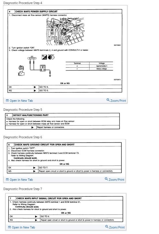

Problem has gotten worst, used to lose power drive now when I give it gas engine dies out. Would this be a mass air flow sensor does any one know to test one? Please help,
Thanks
Mike
Wednesday, September 3rd, 2008 AT 5:24 PM
20 Replies
BMRFIXIT
  • 19,053 POSTS

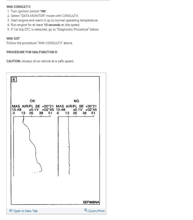

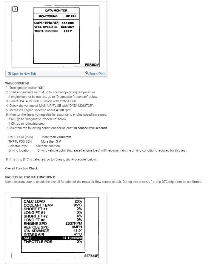

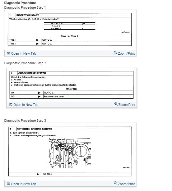

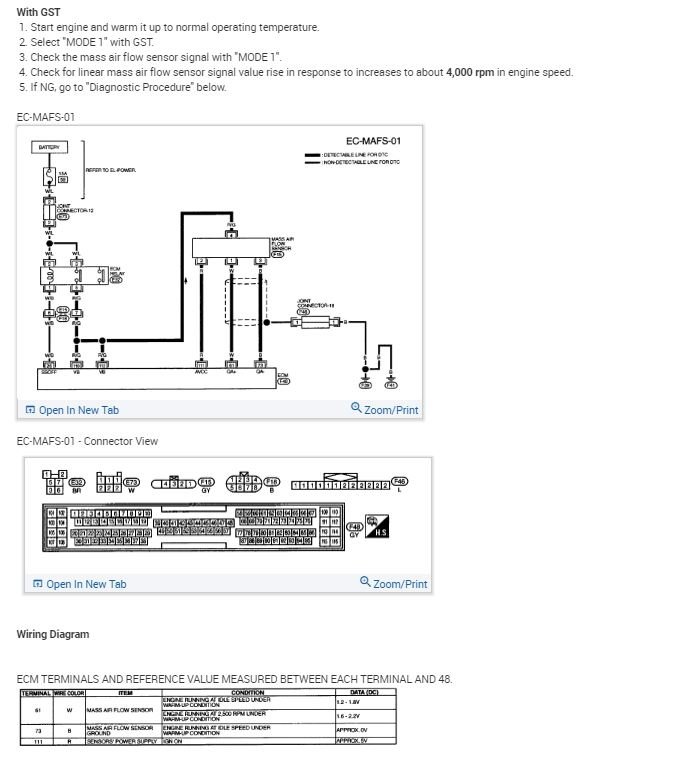

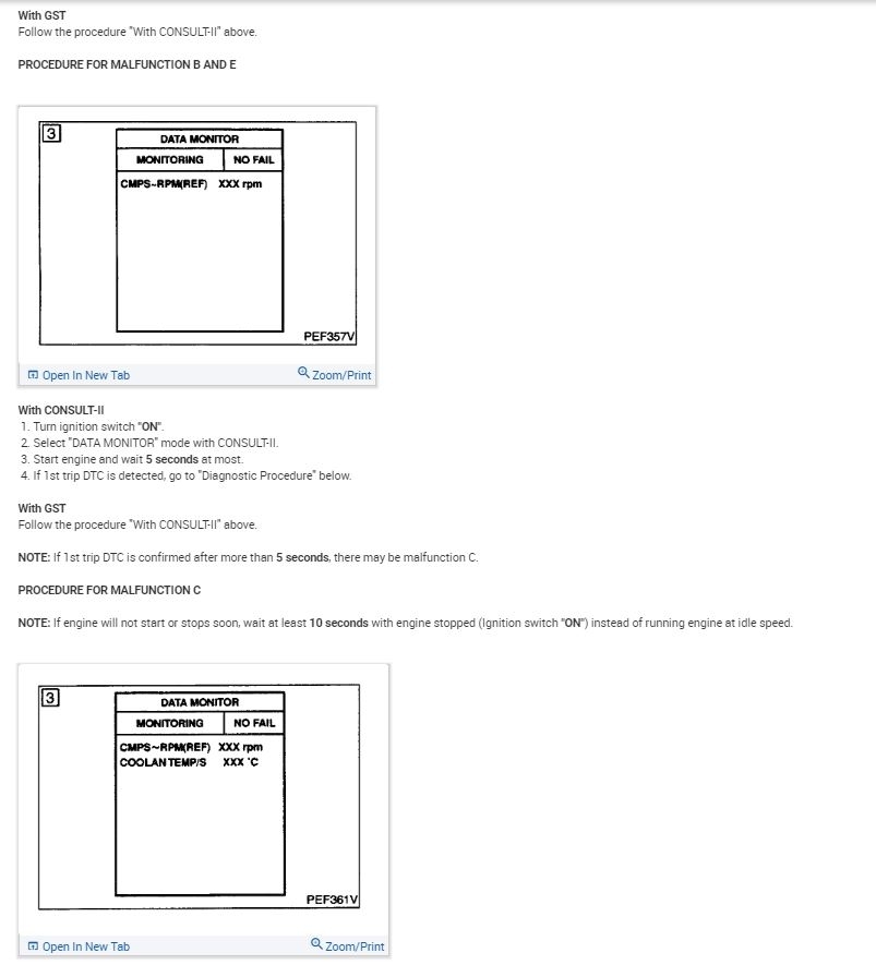

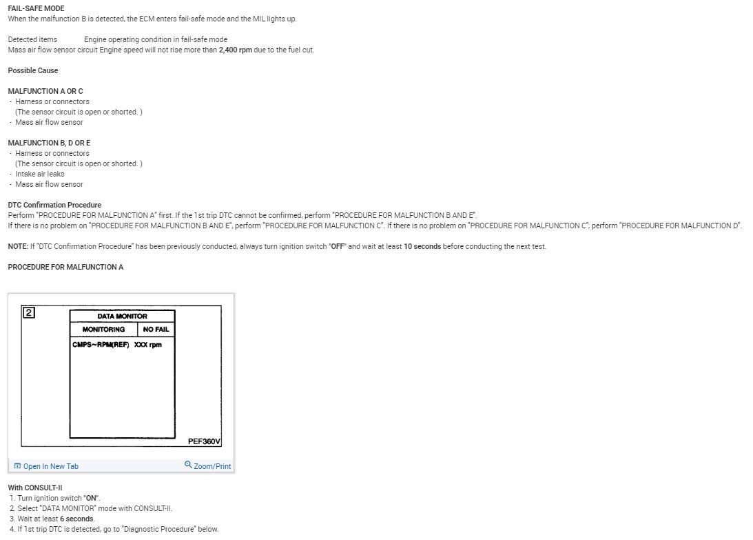

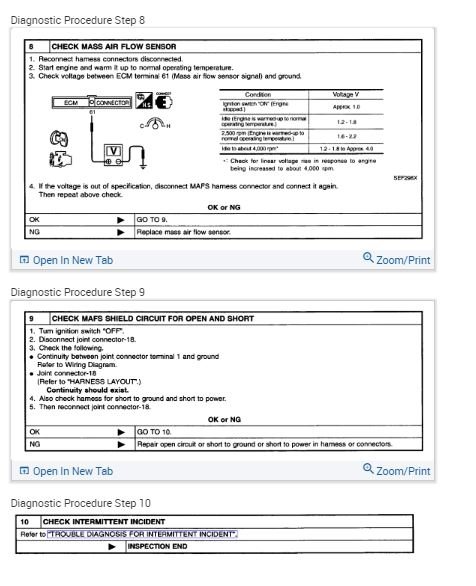

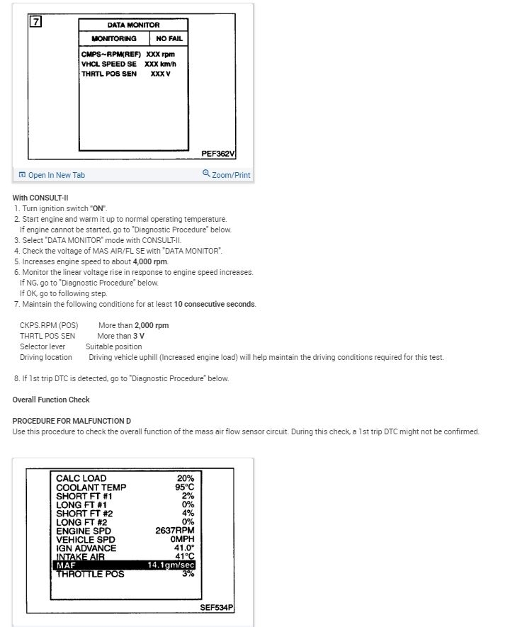

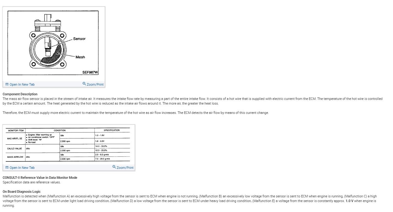

We had a similar issues its end up being the MAF sensor
so you are on the right track
Read the guide below on testing wiring
The diagnostic chart for the MAF is attached below..
