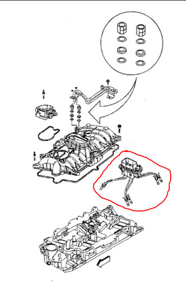

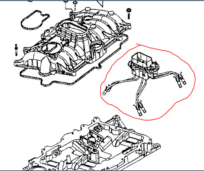

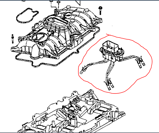

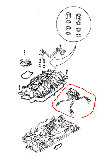

What it sounds like you are experiencing is an issue with the "spider" injection. This is the fuel injection tubes mounted in between the upper and lower intake manifold. This is a common problem in these Vortec engine. I had the same issue in my 1997 K1500. I've owned a 1997 and 1989 K1500 so I know these trucks well. It would be a good idea to stick with the Delphi or AC Delco replacement as I've heard some people having problems with fitment-issue on cheaper brand replacement. Here is a tutorial showing how to replace an intake manifold:
https://www.2carpros.com/articles/replace-intake-manifold-gasket

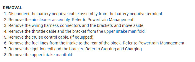

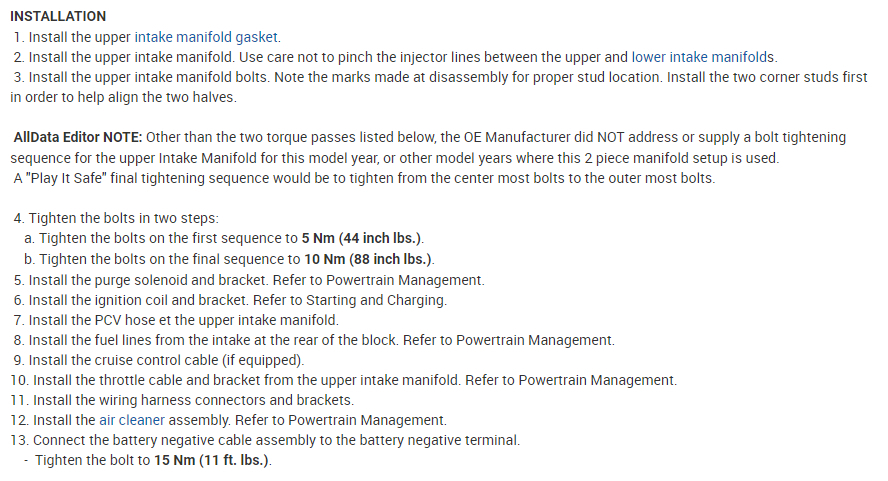

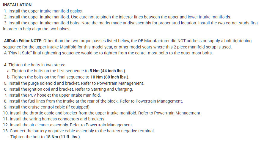

I've attached picture steps below on how to replace the "spider" injection on your Chevrolet truck. I've circled the part in red. Pictured are my 2 below as well. Let us know if you have any further questions on this issue. Hope this helps and thanks for using 2CarPros.
Sep 13, 2021 at 11:50 PM

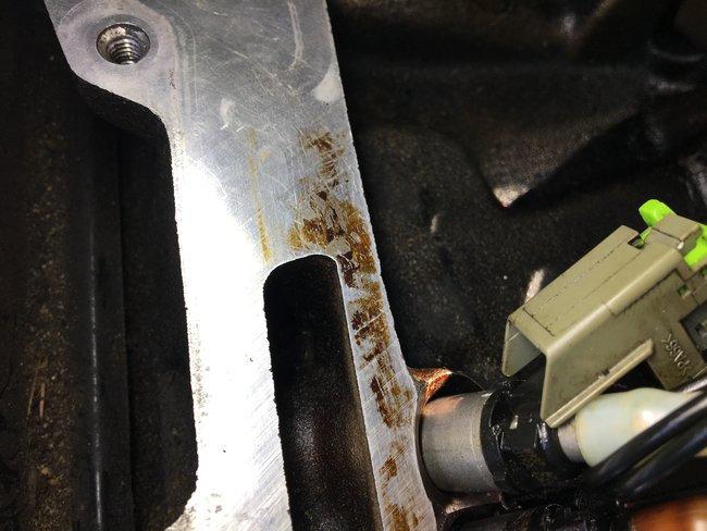

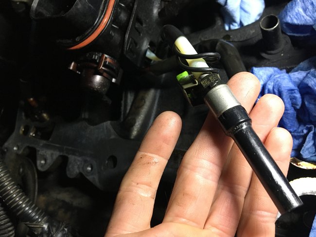

So I did put a new spider in there. One of the fuel injectors was not working. Now I can't get the damn Injector ports to lock in the engine. I'm not trying to break them from force. I did try a little oil on them to slide in and still didn't work. Any ideas? Thanks.

I cleaned all the ports. When I said one injector was bad I meant on the old unit. So on all of the new injectors the plastic part slides in the port just fine until it gets to the metal part of the injector. I tried pushing a little more but they won’t move. They do get snug but I can pull them out without pushing that one tab on the side. Should these be locking in place when I push them in?

Here is the picture:
Sep 21, 2021 at 7:39 AM
What is that a picture of? It is not of any injector.
Sep 21, 2021 at 10:43 AM
JEREMY400
  • 27 POSTS
I’ll have to get a better picture tomorrow. That’s a spider injector. The rest is in the hole. I just wanted to know if it has to click in or not. Or if it looks fine. When I took the old ones out I had to push a tab an pull them out. This is on a 1996 Chevrolet Silverado 5.7L vortec .
Sep 21, 2021 at 11:01 AM
They must go in and click to be sure they are seated. If you do not seat them, they can back out.
Sep 21, 2021 at 11:03 AM
JEREMY400
  • 27 POSTS
That’s what the injector looks like. I just took it out. The black plastic part goes in fine up to the metal part. Then it won’t go in any further.

Is the black plastic part of the old spider or the new one?
Sep 21, 2021 at 11:15 AM
JEREMY400
  • 27 POSTS
New one.
Sep 21, 2021 at 11:23 AM
Are there holes on the bottom for fuel to come out of? I wonder if they are protectors for the injector when boxed and shipped.
Sep 21, 2021 at 11:28 AM

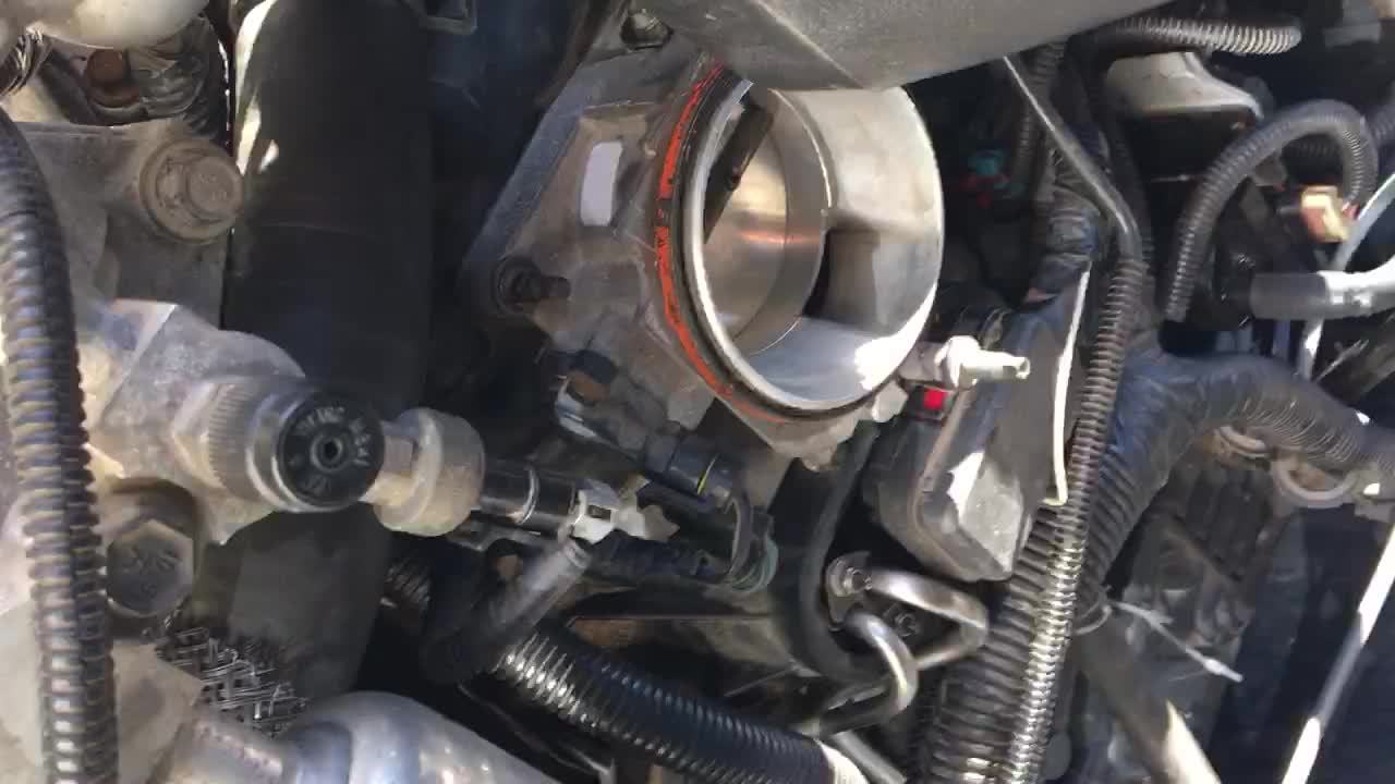

So, I assembled it all and my misfire is gone but now it sounds like the carb is whistling. idles really rough. Carburetor gasket? I did spray carburetor cleaner around and nothing changed. But when I took the air cleaner off and sprayed around the carburetor. It idled high then shut off. I put the cleaner assembly back on and started it and it fired up but ran rough.
Sep 25, 2021 at 10:51 AM
If you put your hand over the top of the carburetor with it running, does the whistle stop?
If it does, you need to either rebuild the carburetor or replace it.

I will have to check when I get home. I meant to say throttle body not carburetor.
Sep 26, 2021 at 6:50 AM
Okay, check that and see.
Let me know how you make out.
Sep 26, 2021 at 7:18 AM
JEREMY400
  • 27 POSTS
So, it did not shut off it sucked my hand onto it. It doesn’t sound like it’s whistling anymore. Here is a video of what it sounds like:

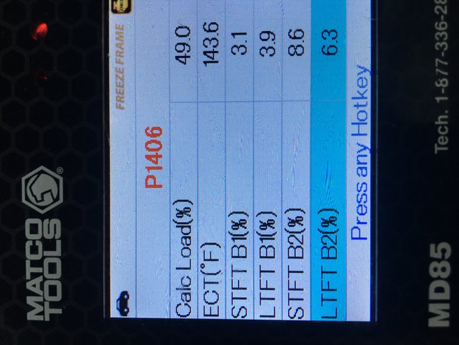

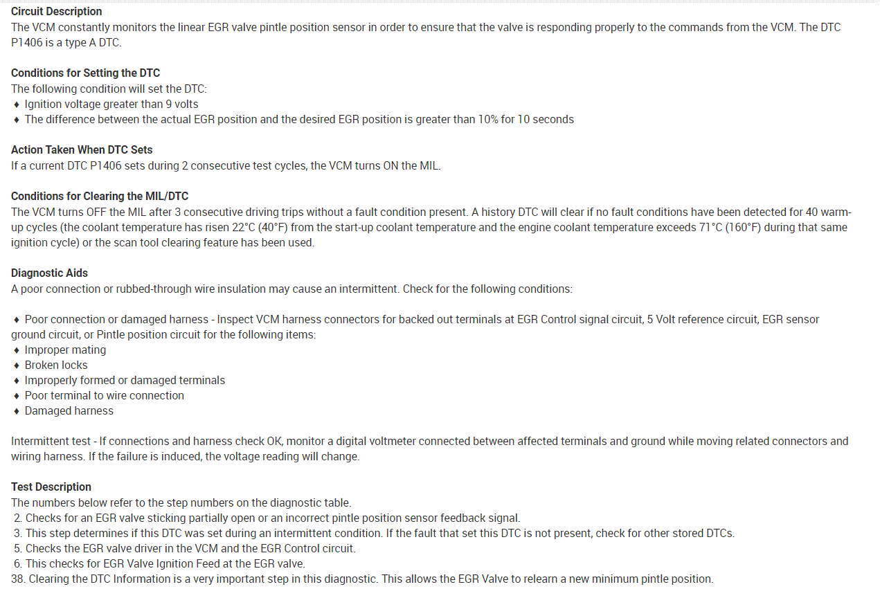

So, I borrowed a friend’s scanner. Here is a picture and a new code jump popped up. It’s on the screen. So, wouldn’t bank2 short term trims be a little high? Running lean? Thanks.
Oct 7, 2021 at 9:01 AM

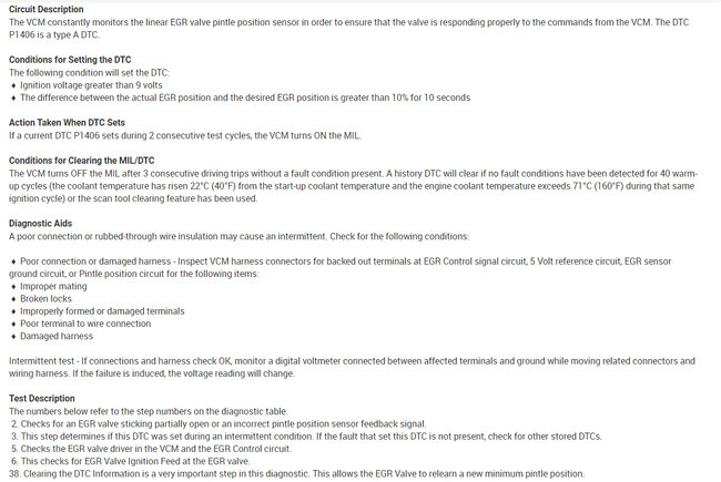

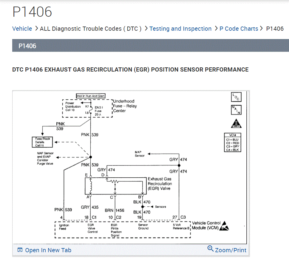

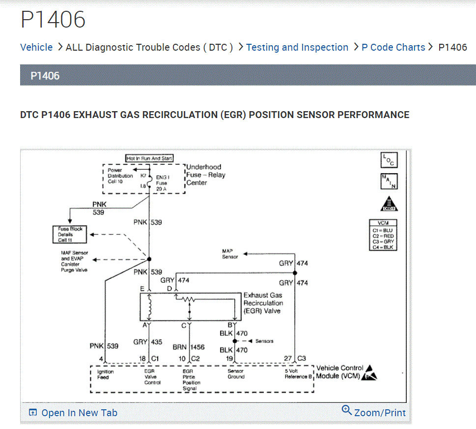

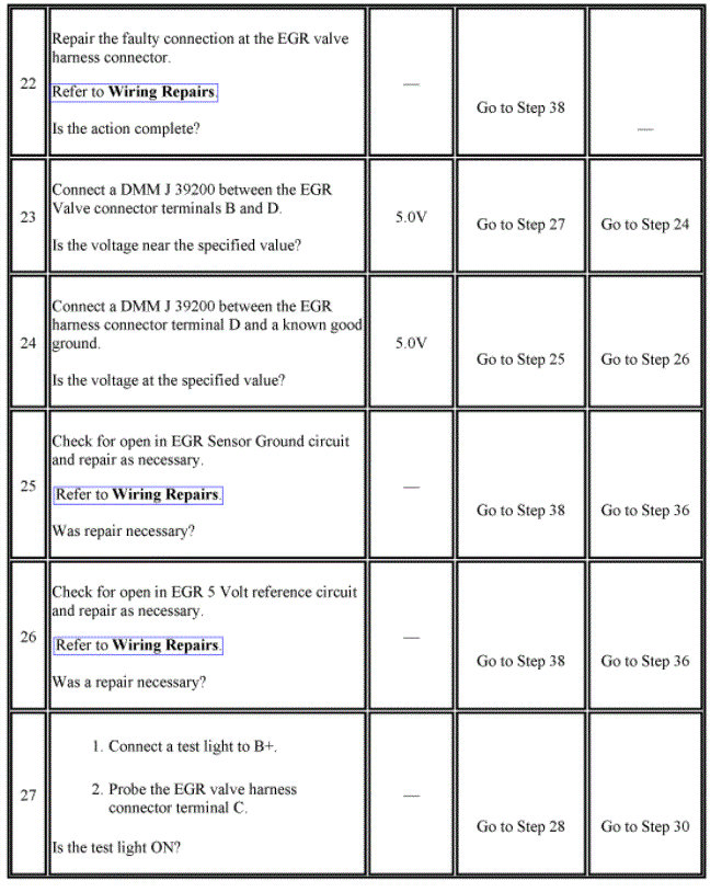

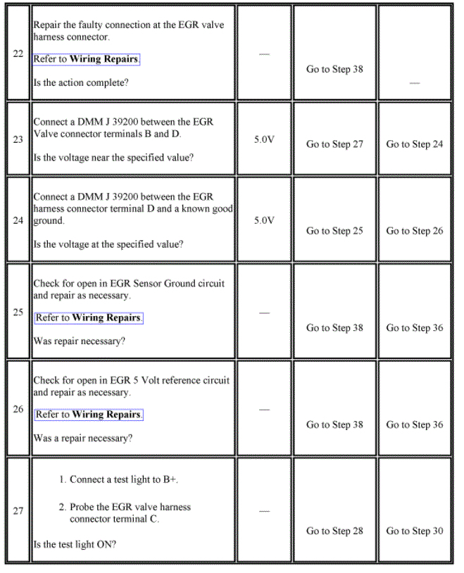

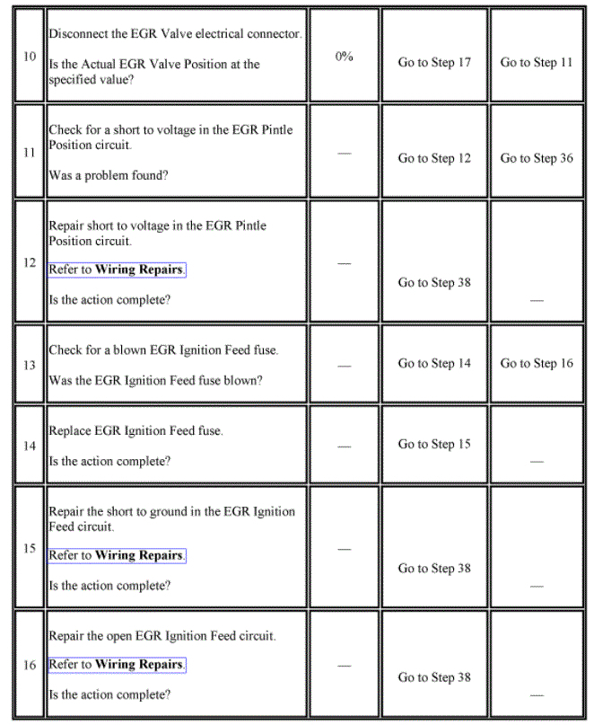

  • 110,244 POSTS
Bank 2 is a bit high. It isn't at operating temperature at this point. Check it at approximately 200F.

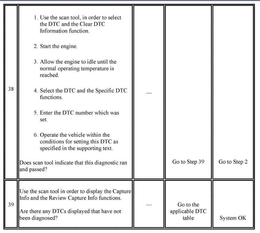

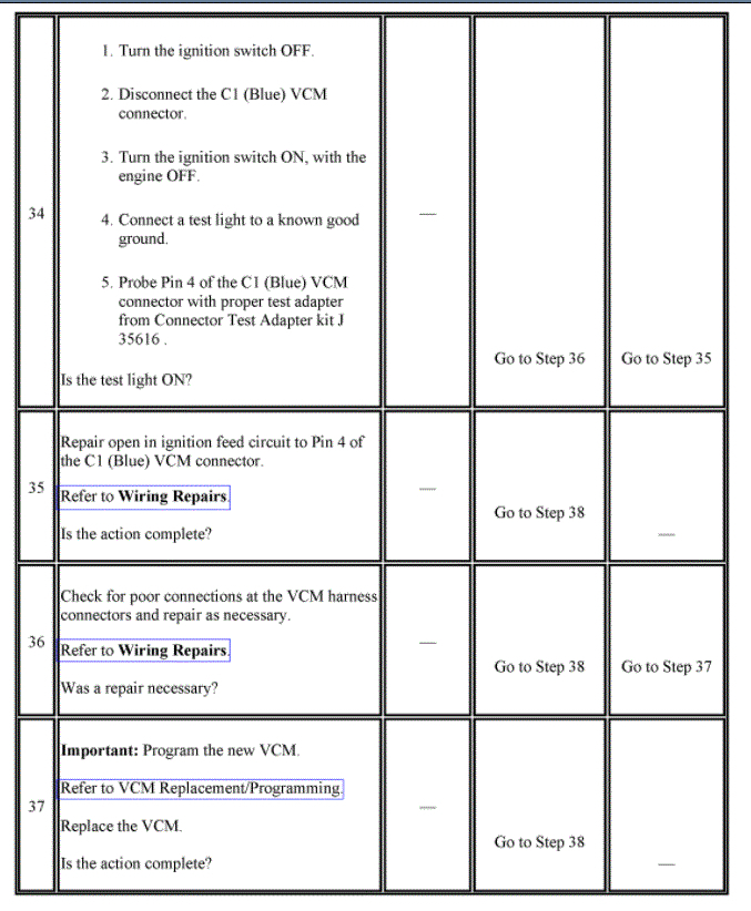

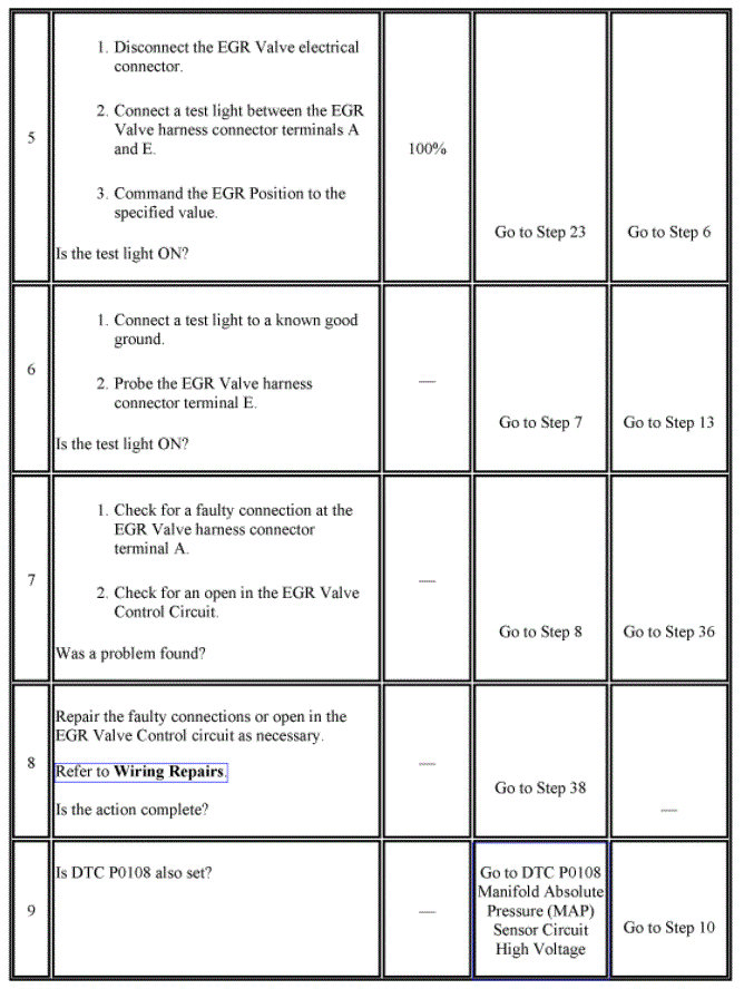

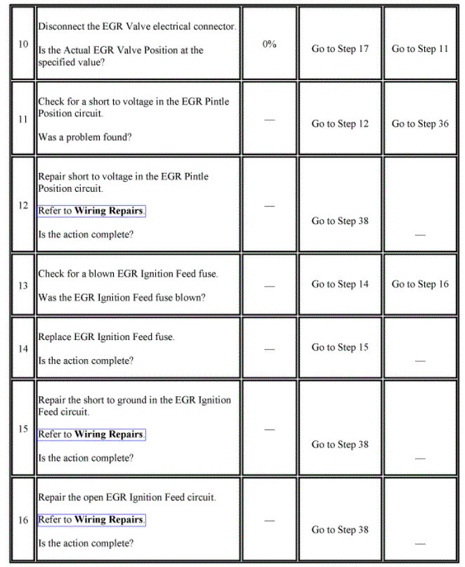

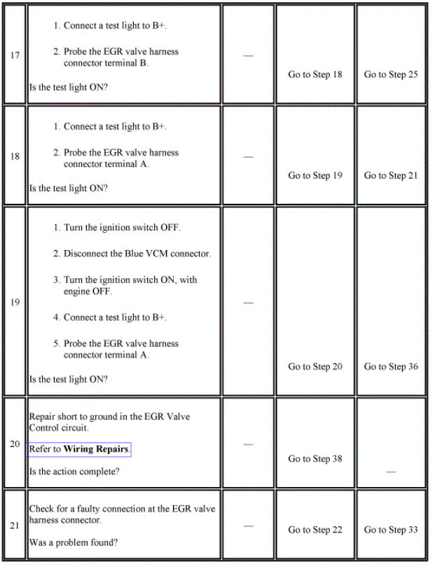

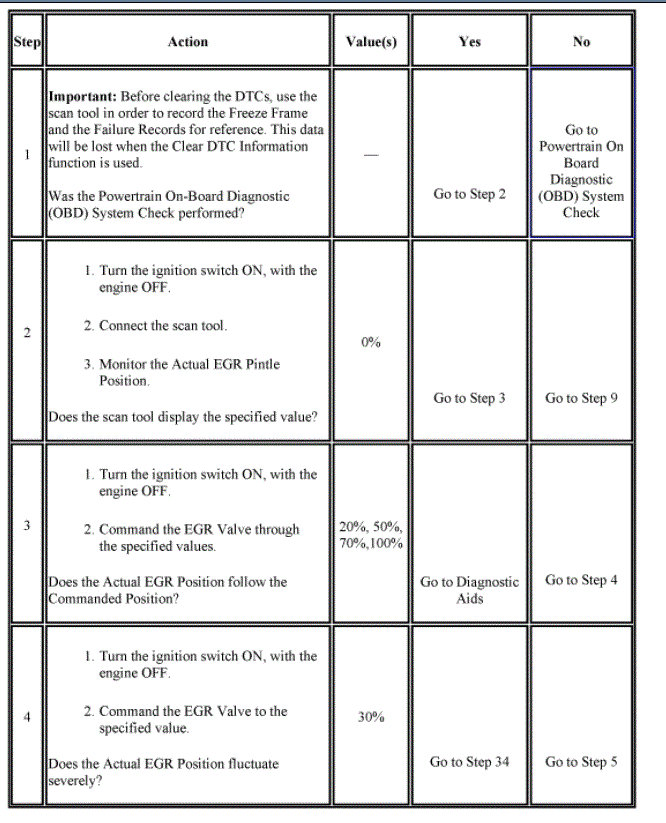

Now, the code indicates an issue with the EGR. That can be causing a lean mixture or even a vacuum issue. I attached the directions for the diagnostics below. Take a look through them and let me know if you are comfortable performing them.
See pics below. Don't be overwhelmed with the directions. Hopefully, you won't need to go through all of them. They are very detailed for every possible issue. Also, I think you found the issue. I suspect there is an issue with the EGR itself.

Hey, so I did go down the list and there was power to the EGR so I changed it. P1406 is gone but the truck still runs rough. Bank 2 stft jumped up to +13. There is a gas smell. Someone told me to pull the intake and make sure none of the injectors popped out of the ports. With good fuel pressure could that have happened?
