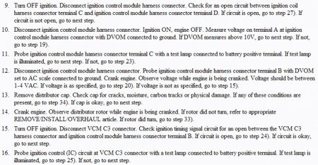

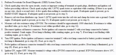

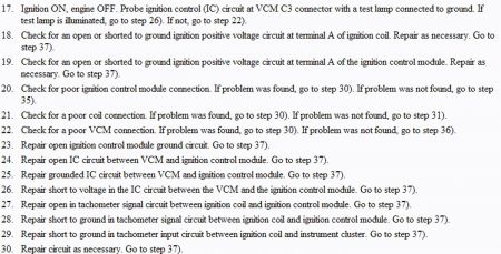

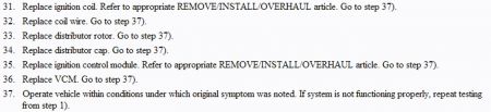

https://images.2carpros.com/forum/automotive_pictures/62217_Ignition_testa_1.jpg
https://images.2carpros.com/forum/automotive_pictures/62217_Ignition_testb_1.jpg
https://images.2carpros.com/forum/automotive_pictures/62217_Ignition_testc_1.jpg
https://images.2carpros.com/forum/automotive_pictures/62217_Ignition_testd_1.jpg

That is a very helpful and thorough, step by step procedure.
I kinda got thrown off on step 5, since the coil connector is not labeled, I assumed the 'pink' wire was 'C' and was chasing my tail until I looked at a wiring schematic. Then I assumed the 'black/wht' wire was 'C' since it was connected to the control module.
Assuming that is correct, I then proceeded down to until I got to step 12, where I did not show the 1-4 VAC, I only showed about .4 VAC on my meter.
I was not sure which connector was the 'VCM C3' connector, or which terminal was the ignition control (IC) circuit as described in steps 15-17, but I did disconnect all plugs from the module, then re-connect.
At this point, I am assuming it is the VCM since I do not seem to be getting hardly any AC control voltage to the Ignition Control Module.
If you have any other ideas, I would appreciate it.

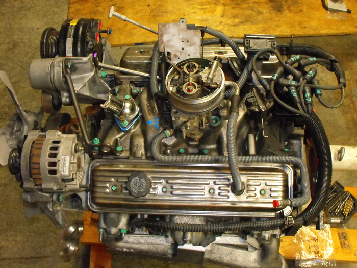

I just rebuilt my chevrolet Chevrolet K-2500 350 5.7L T.B.I. V-8 out of my 1992 K-2500. The engine had locked up so I rebuilt from the bottom up. When I start the engine the idle is rough and only keeps running with assistance. After about thirty seconds the engine will die no mater what
Engine is in initial start up and break in phase of rebuilding.
New piston Rings, main bearings, rod bearings, TPS, oil pressure sending unit, cam bearings, new stock camshaft, lifters, valve seals, professionally cleaned all engine parts, qualified all non replaced engine components, new timing chain.
adjusted rocker arms, checked timing, verified vacuum hoses are in good order and correctly placed. crankshaft was professionally ground and polished to 10/10.
