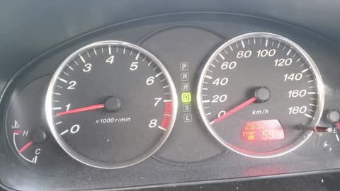

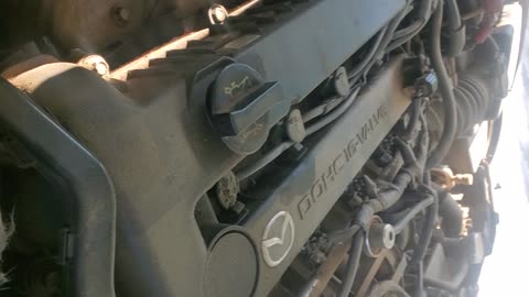

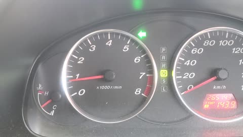

This is a video on cold start.
May 13, 2024 at 3:31 AM

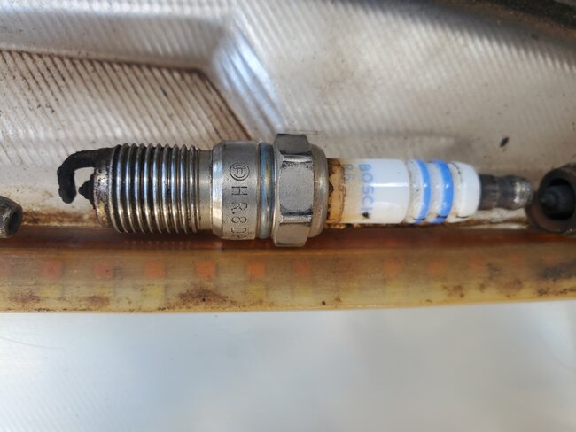

KAOMA
  • 24 POSTS

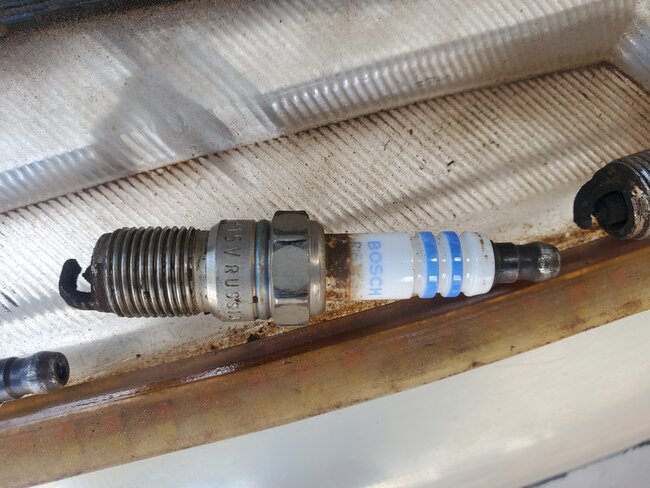

spark plug 1.
May 13, 2024 at 3:38 AM

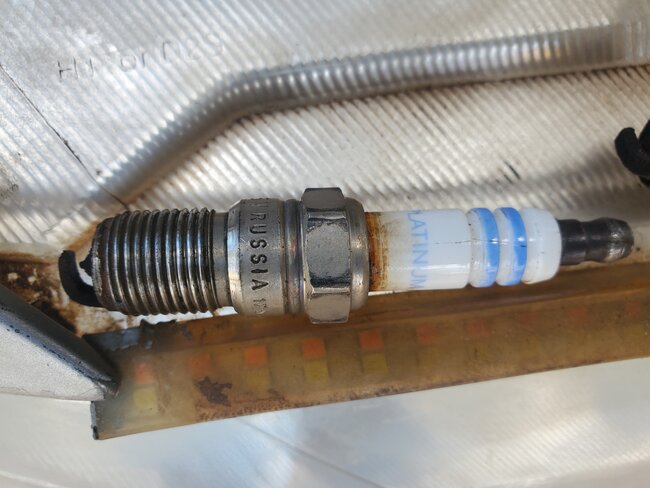

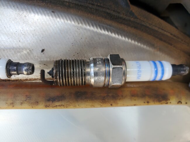

KAOMA
  • 24 POSTS
spark plug
May 13, 2024 at 3:42 AM
KAOMA
  • 24 POSTS
i got new spark plugs today, the misfiring has improved but still have a rough idle. i have not been able to locate a garage with the compression gauge. is there a way to test the compression without the gauge?

Not really, thanks for the video, I can hear some engine noise I don't like, it sounds like you may have a roller follower or a flat camshaft, I would do the compression test first because in the video it looks like you may have one cylinder that is low on compression.

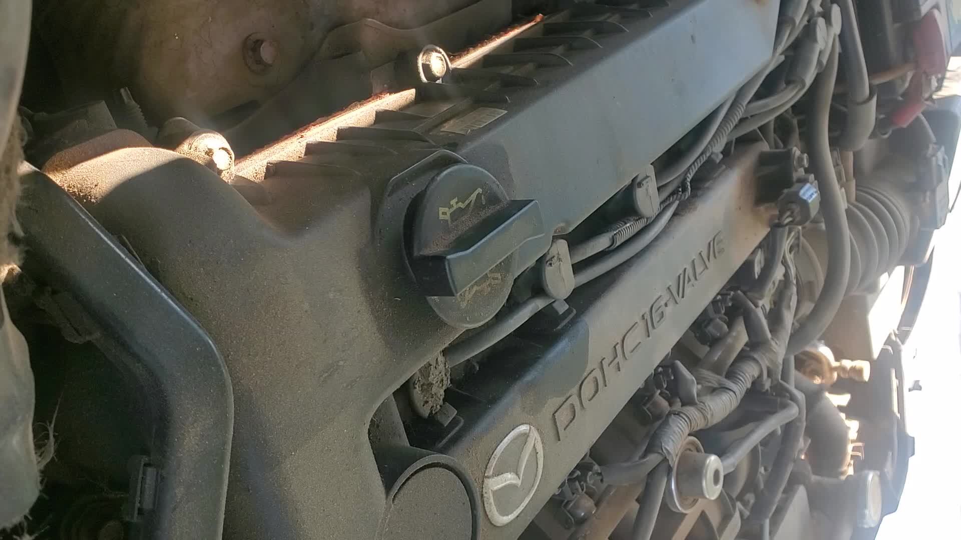

I post so you see what i am talking about.

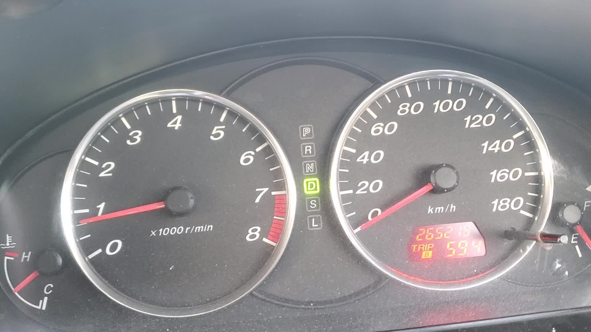

Below is a video of the car running smooth without misfiring or rough idle.
Dec 4, 2024 at 3:55 PM
  • 55,433 POSTS

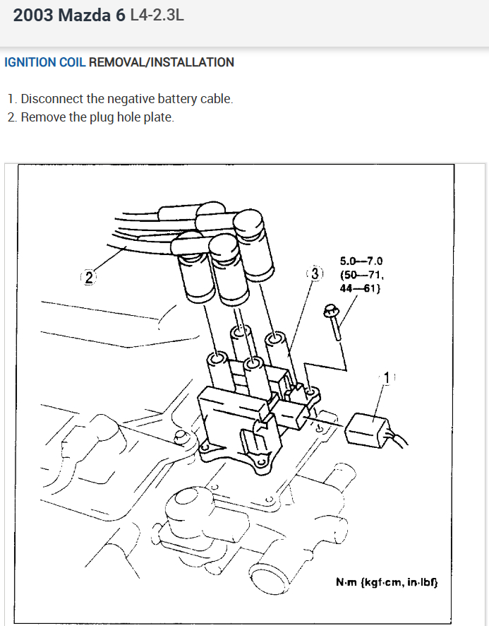

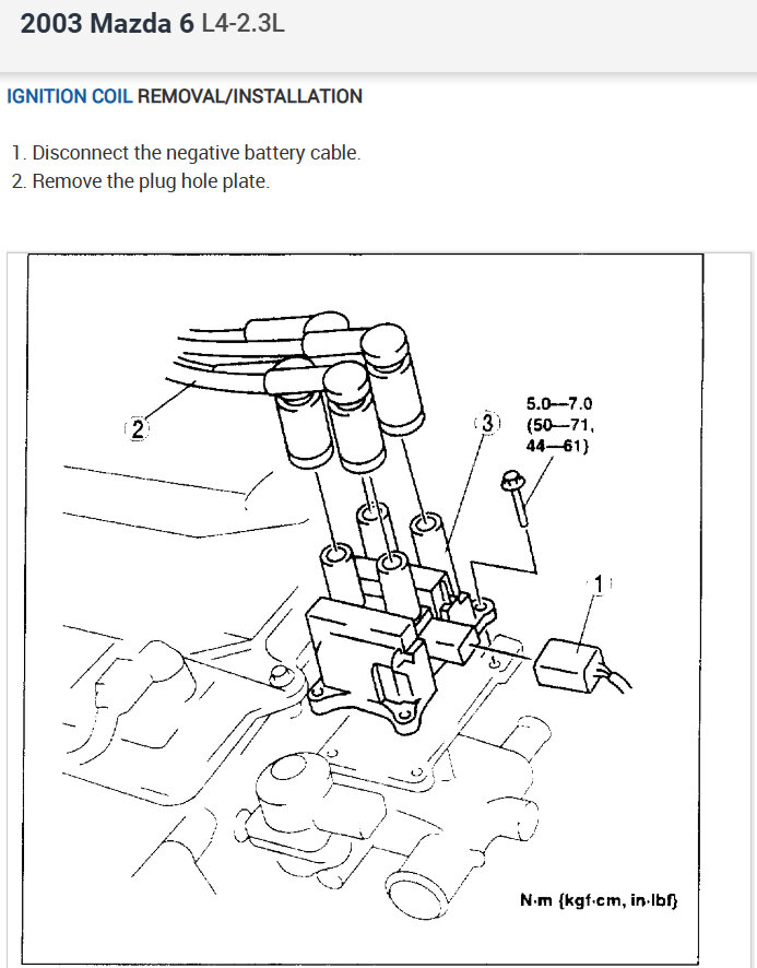

Yes, that does idle well. thanks for the video. I have seen a cracked spark plug or a bad ignition coil cause this, I would remove the spark plugs to check for cracks and replace the ignition coils. I would replace the spark plug wires as well. Check out the images (below). Please let us know what happens.

Are there any trouble codes? Also, those spark plugs like the engine is running rich like it has a clogged catalytic converter. If you use a rubber mallet on the exhaust, can you hear something rattling inside?
