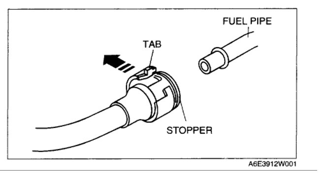

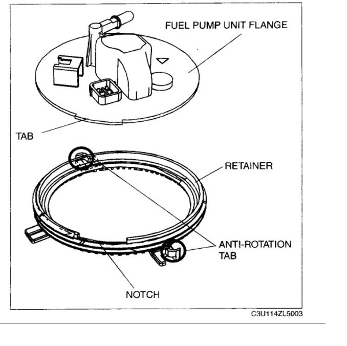

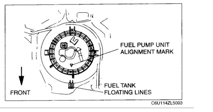

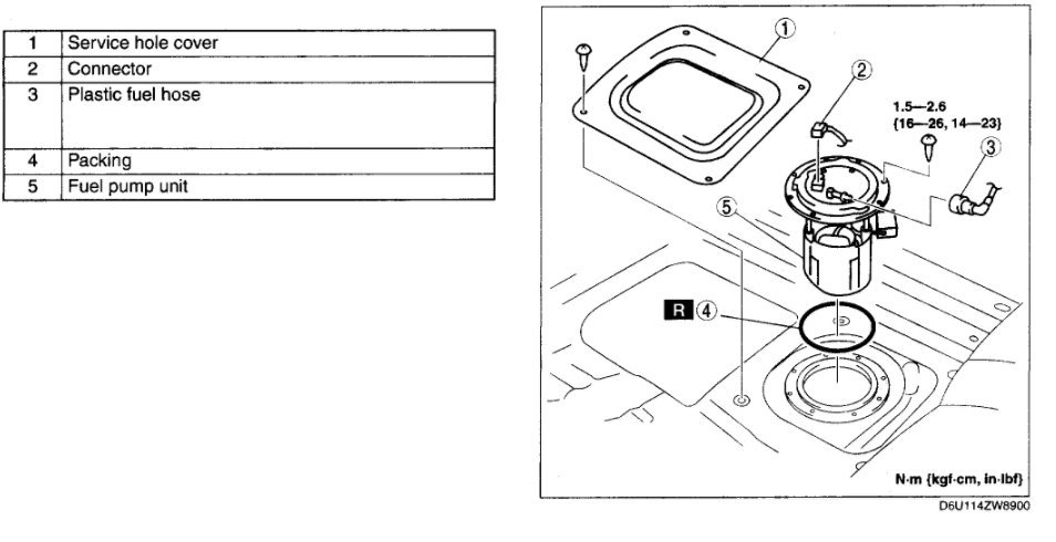

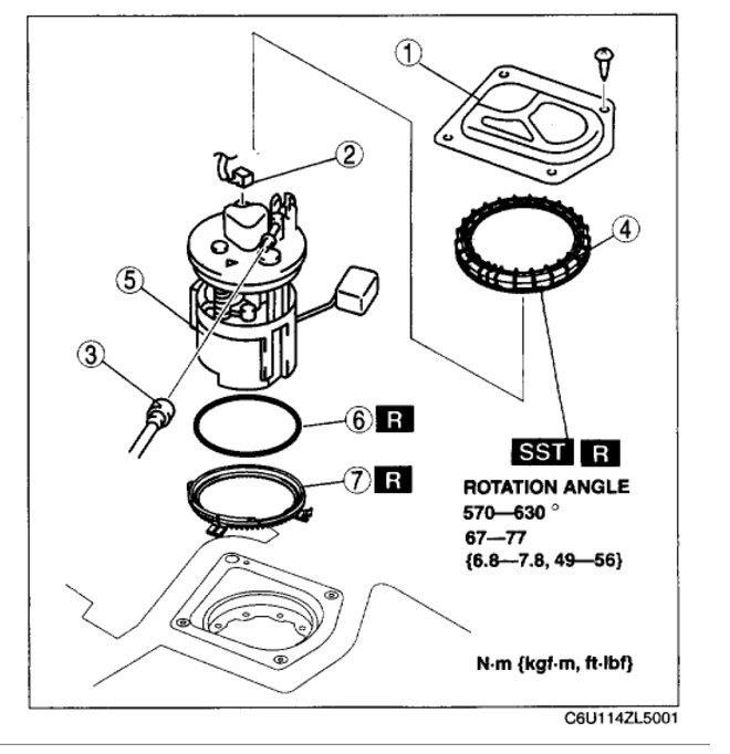

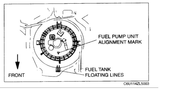

It sounds like you have a fuel pump that is starting to go out. Here is a couple of guides and some diagrams (below) so you can get the problem fixed.
and
https://www.2carpros.com/articles/how-to-replace-an-electric-fuel-pump
It looks like your car has a trap door so you don't need to pull the tank YA!
