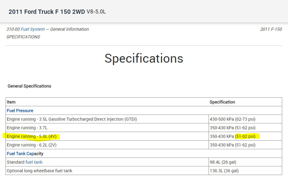

The truck idles rough when stopped and in gear. The truck has had the following recently replaced. All spark plugs, Mass Flow Value, EVAP Purge valve, and electric throttle body. All OEM parts. Have lost 3 to 4 MPG since all were replaced. Do I need to get the PCM flashed? Or ideas on what to do?

A rough idle is usually caused by either a vacuum leak or a fuel pressure issue. Since you have dropped MPG, the first thing I suggest is checking for a vacuum leak as well as checking the fuel pump pressure. A faulty fuel pressure regulator can increase fuel pressure beyond the manufacture's specifications and force more fuel into the engine than wanted or needed.
On the other hand, an unmetered air leak will produce a lean fuel mixture causing the PCM to try to compensate by adding fuel to the engine.
Here are two links that explain how to check these two things:
Also, I attached the manufacturer's pressure specifications below. Try this and let me know what you find.
See pic below.

Thank you for the info and advice. I looked things over and did not find any vacuum leak and the fuel system pressure looked good it was in the correct range. It still seems sluggish when stepping on the gas (like it's taking a while to switch gears) and still has a shimmer while stopped and in gear.
