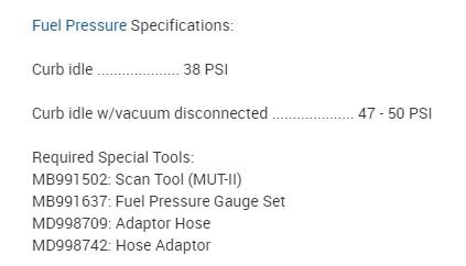

  • CAR REPAIR CONTRIBUTOR
I would check the fuel pressure to be sure sufficient fuel is being delivered to the injectors.
I attached the spec below for you.

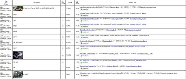

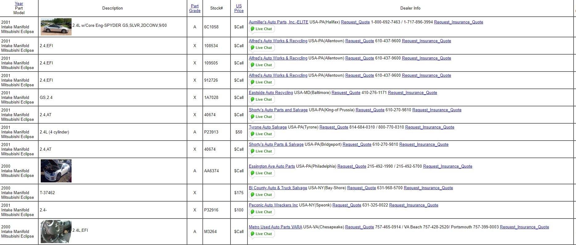

I towed it in to my mechanic's shop today, and it's a cracked intake manifold. We're having a heck of a time finding one that will fit a 4 cylinder engine, most are 6 cylinder. He's going to see if he can repair it with some sort of sealer.
Mar 14, 2022 at 12:45 PM
I found pages of the manifolds for you. I attached them below.
No, to the repair. There is no sealer that will work as the manifold expands and contracts and the sealer will fall off.
Mar 14, 2022 at 12:49 PM
KIWASABI1
  • 202 POSTS
Thank you for that recommendation on where to get the part, I ordered one for $40.00 plus shipping. So hopefully once it's installed my car should be all good to go again.
