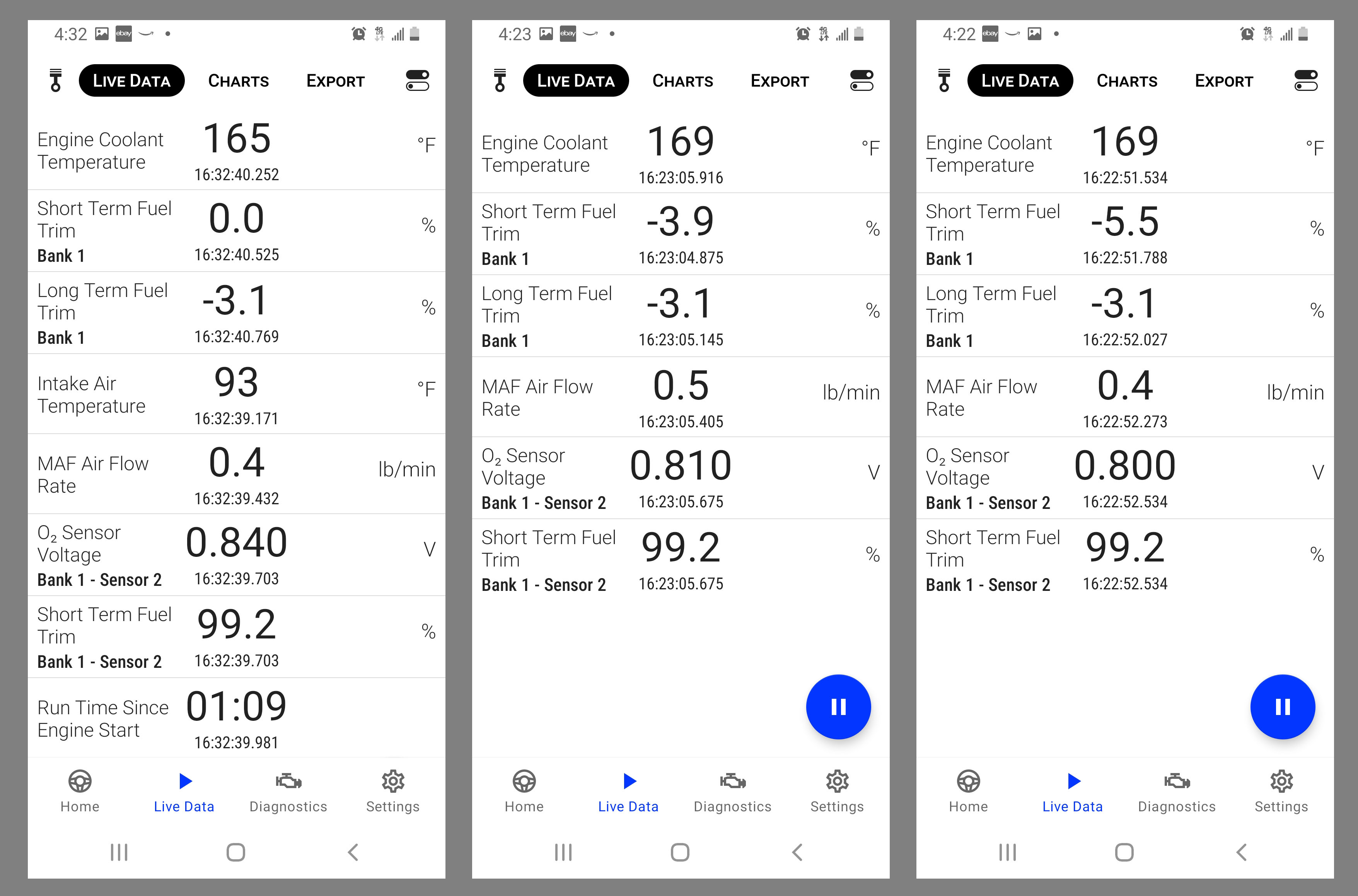

Dongle arrived. A little flaky connecting to the OBD2 port under the dash but eventually I got it to stay on steadily.
Here's what I found using live data from the free version of the Piston phone app.
First number is idling, 3 or 4 minutes after start up. Figures that are in brackets [] are taken revving to about 2500 RPM. Most did not change, so no brackets. Screen shots are below, the newest one on the left was after the shutdown/restart.
Coolant temp: 171 [163]
Short term Fuel Trim Bank 1: varied between -5.5 and +3.9 [similar when revving]
Long Term Fuel Trim Bank 1: -3.1
MAF Air Flow Rate: 0.4 to 0.5 [higher when revving, 1.5 to 2.5]
O2 Sensor Voltage bank 1 sensor 2 : 0.8 with small variations
Short Term Fuel Trim Bank 1 Sensor 2: 99.2
In addition I had a code P303, Cylinder 3 misfire, which was there twice (one was Permanent, the other was Current.)
I cleared that code, and CEL went out. "Permanent" code went away after a shutdown/startup cycle. Did not come back so far.
During this testing the car was NOT idling rough at all, so I guess this is baseline info. Only a few minutes of running in all.
I see that STFT B1S2 at 99.2% is normal.
Coolant level was at the seam in the tank, so - I think - that's at the bottom of the COLD range, there is a mark about an inch above the seam which I think is the top of the range. This is what I remember from a previous check also, so not losing coolant so far as I can tell.
Next step, I'm guessing, is to drive a bit until I get the rough idle and check again while it's acting up?
Any tips to get the dongle to make solid contact instead of needing to be jiggled until it lights up steadily?

Second session:
After some intermittent rough idling, and about 2 solid minutes of revving over 3000 RPM,
the only changes I see from the scanner are occasional dips in O2 Sensor Voltage bank 1 sensor 2 : it would go as low as .12 for short periods which seemed to coincide with rough idling, and also the Long-Term Fuel Trim Bank 1 was changing more than it had before, with dips to -2.1 and then returning to a steady -3.1.
Everything else seemed about the same.
Idling was on the lesser side of the roughness spectrum this run, it was intermittently a lot rougher yesterday when the CEL lit up.

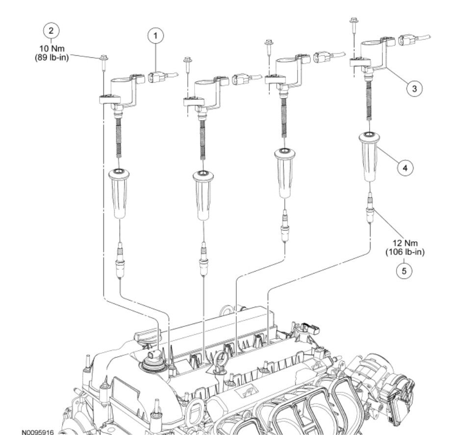

Okay, the P0303 code is pointing at a misfire, Fords in that era didn't trip the code until there was a long period of misfires. Check to see if that app can read the misfire monitors, it might let you watch the cylinders to see if it's missing during the rough idle. I would also take it for a drive and see if the coolant gets up to a hotter temperature, which should have a 185 thermostat in it. The fuel trims look good once it warms up.
If you want to do a bit of testing, pull the coil off 3 and swap it with 1. Then swap the 3 plug with 4. See if the misfire code travels with one of the parts and you will have found the bad part. I would say to change the plugs as they are due at 115,000, if you already did and it started missing after that it could be a bad plug or a failing coil. The swapping could pinpoint it if the misfire shows up during the rough idle.

Swapped coils. Misfire followed the coil on the scanner. I spoke to my mechanic; he's going to put a new replacement in for me tomorrow. He had tossed the originals, and two of them were certainly bad so trying to test with one of them would have been a crapshoot anyway.
The 4 coils now in there are bright shiny and new, so I guess a new-part failure. In the tube world, "infant mortality."
Or a second problem will show up once all the coils are straight. Fingers crossed. Thanks for the backup!

Two good test drives since the suspect coil was replaced. No kicking at a standstill, everything seems normal all the way up to high speed. Very slight periods of very slight vibration while stopped, this seems normal. I'd say I'm completely sure it's completely fixed but for one piece of info. I just got hold of AndrOBD, a very nice free/open-source diagnostic app for Android. It has the feature of showing misfire counts, not just fault codes. I have been told that this era of engines can have a fair number of misfires before setting a code. I would suppose that the count the app shows is the total on all cylinders.
After about a 20-minute ride I saw about 20 misfires counted, no fault codes. Is that a lot? Is that a red flag? I've also noticed that my coolant temp still never gets above 180. But the idle does change to a lower RPM (950 goes to 750) once the engine warms up - so that means my thermostat is working, right?
I also drove around a bit and rechecked the ATF with the dipstick - no problem reading it this time. It was reading just about perfect - between the upper hole and the top line. I poured in about another pint. I'll look at it again in 25,000 miles if I ever get there. I'm not really as worried about leakage anymore but next time I'm under the car I will take a close look. (I have some black vinyl wrap I plan to chrome-delete the three upper grille bars and the lower grille surround with; that will require me to go up on the ramps at some point.)
Feeling pretty good about going ahead with the ATF service, I think it seems pretty clear it was warranted what with the low level and the 100,000+ miles.

The misfires are a bit high but as you had the coil issue it's very likely just a remnant of the cylinder not firing all the time. Pour a can of Berryman's B12 in the tank and take it out for a spirited romp and blow the carbon out of it. Then see if the misfires go away. If not then you may want to pull the plug and clean it, but it should clear up with a bit of hard use.
Temperature wise if it's cold in your area the coolant may not get much above the thermostat's operating temperature.

Hmm okay. So, I would change the plug in 3 (where I had the problem for a little while) then? Not 1 (where I only had misfires while I was troubleshooting, relatively short time)?
I don't think I get any data from this tool on *which* cylinder is misfiring until it reaches the threshold to send a code, the "Misfire count" is just a single number which I think is a total.
How important is it to get a plug that's exactly identical to the other 3?
