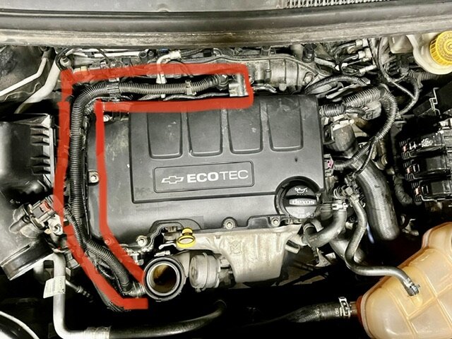

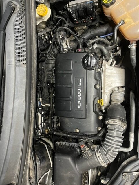

I attached a couple of pictures of the engine. I circled in red what I think is the PCV hose. I removed the air filter intake hose so you could see where what I think is the PCV hose is attached. Let me know if that's right or not. The other pic is just a regular pic of the engine compartment. I don't know if you can take the pic and circle the correct PCV hose if I'm wrong. But just in case you can I'm attaching one.

You found them. What you highlighted in orange is correct. The hard part is behind the engine it gets a little difficult to see. Take your time. Check for the smaller hoses I highlighted above and make sure they are not damaged as well.
As far as the coolant issue is concerned, you should pressure test the system. It requires a pressure tester, but most parts stores will lend one to you.
Here is a link that explains how to pressure test the cooling system:
https://www.2carpros.com/articles/radiator-pressure-test
Let me know what you find.
