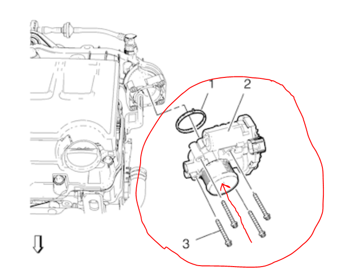

Thanks so much for your response. I have never used starting fluid before. Not trying to sound like a complete idiot, but where do I spray it? Do I need to spray it and have someone try to start the car at the same time? How much do I spray?

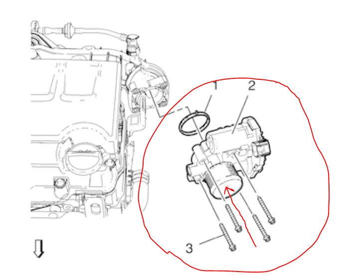

You will need to spray it into the throttle body. If you follow the air intake tube from the air filter, it will lead you to the throttle body.
I attached the only pic I could find below. I have an arrow pointing to where to spray the starting fluid. Just give it a brief spray (1 second) and then try starting it.
Keep in mind, it will evaporate fast, so don't wait too long to try starting it. Also, just as a safety precaution, make sure you remove the spray can away from the engine when you try starting it.
Let me know if this helps and by no means is this a stupid question. I'm glad you asked.

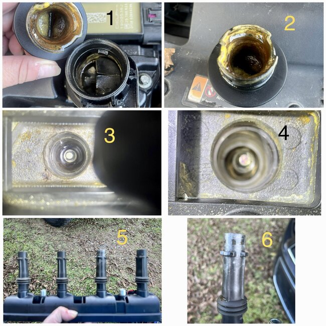

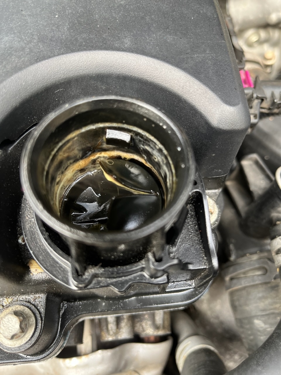

Okay, here's the latest: there's definitely coolant in the oil. That was confirmed when I took off the oil cap (pic 1 and 2). I also did the cylinder compression test. When I removed the ignition coil, I could see coolant on the boot (pic5). The same spark plug that had oil in the spark plug well before now had coolant as well (pic3). There results from the compression test are:

I performed the test three times on each cylinder to ensure the results are correct. So, I'm going to take an uneducated guess and say it's a blown head gasket??? If so, do you think something like K&W Head Gasket Block and Repair will fix it? I have a brand-new bottle of this that I bought when I thought I had a blown head gasket in my jeep. (Thank God that I didn't). I'm not scared to do the repair but if that bottle of stuff will fix it then that would be a lot easier. Let me know what you think.
Nov 6, 2022 at 7:00 AM
  • 110,244 POSTS
It won't hurt to try. I'm not familiar with the product you have. I have heard that Blue Devil brand works well if the directions are followed. However, I don't think any of them are permanent fixes.
Looking at the oil in the pics certainly appears to indicate coolant is mixing. Whatever you do, make sure to change the oil and filter prior to starting it after repairs.

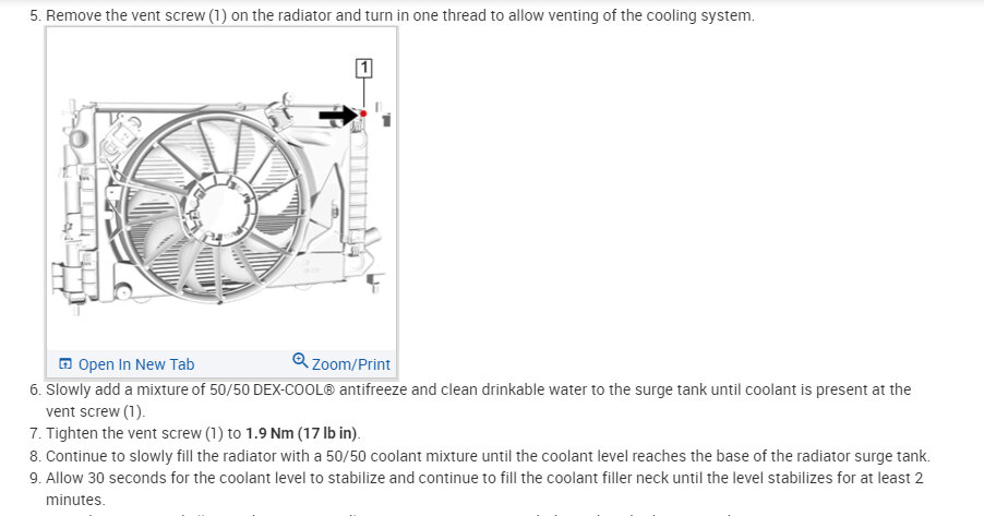

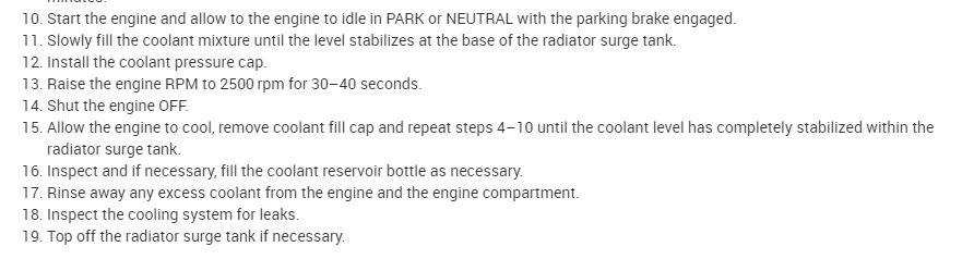

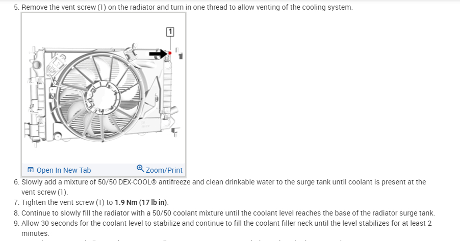

When you refilled the coolant, did you open the air vent on the radiator to help eliminate trapped air in the system? That is what it sounds like is causing the heater issue and likely the overheating.
Take a look at the directions below and let me know if it is what was done.
Nov 8, 2022 at 11:25 AM

No. I did not do this.
Nov 9, 2022 at 12:39 PM
  • 110,244 POSTS
Give it a try and see if it makes a difference. I suspect there is an air pocket causing the issue. If you follow the directions above, it should resolve the issues.

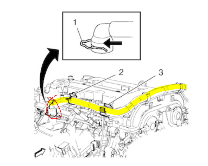

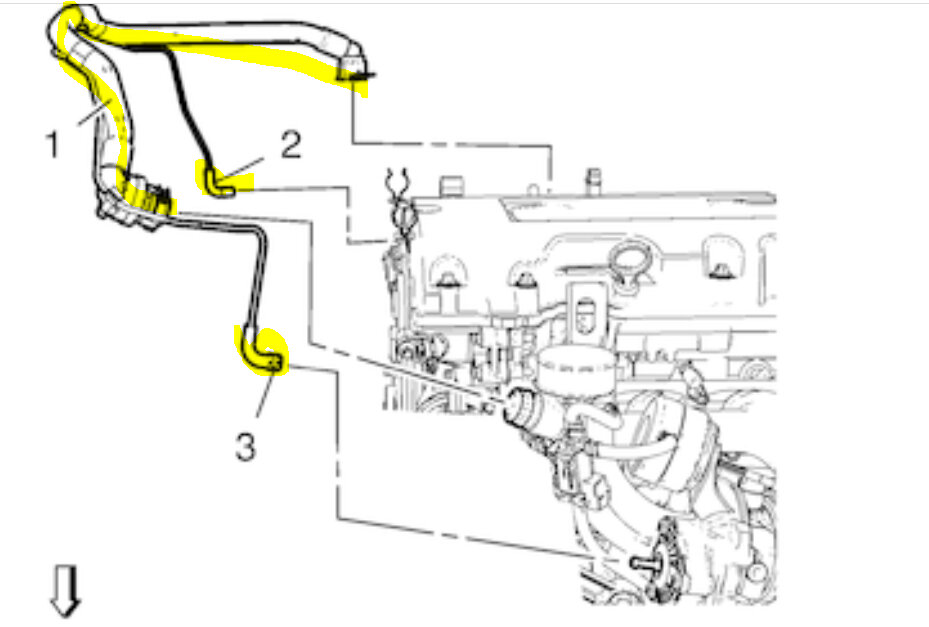

  • 110,244 POSTS

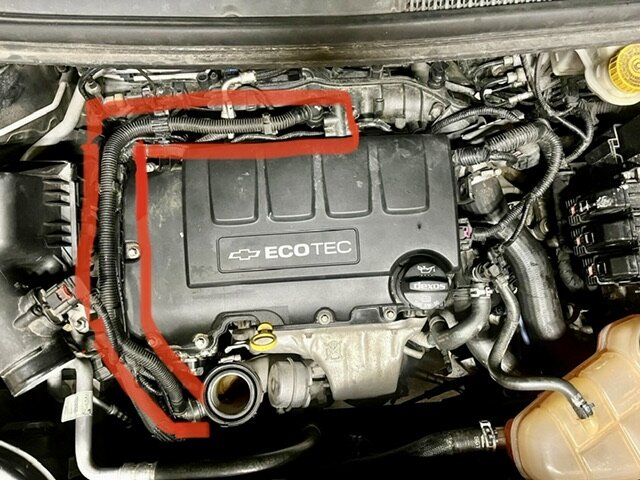

This is a little different because it is a turbo. The PCV hose is shared by the charge air tube. I attached two pics below showing things from two different angles. Note that the arrows in the pics are pointing toward the front of the vehicle.
In pic 1, I circled the start of the PCV hose. All things highlighted are related. I need you to check for any leaks in the hoses indicated as well as the smaller hoses.
When you do this, make sure nothing is cracked or allowing air to escape.
Let me know what you find. Also, please feel free to let me know if you have any questions. It is absolutely not a problem whatsoever.

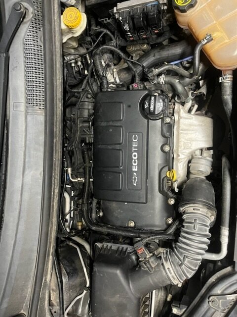

I attached a couple of pictures of the engine. I circled in red what I think is the PCV hose. I removed the air filter intake hose so you could see where what I think is the PCV hose is attached. Let me know if that's right or not. The other pic is just a regular pic of the engine compartment. I don't know if you can take the pic and circle the correct PCV hose if I'm wrong. But just in case you can I'm attaching one.
Nov 22, 2022 at 8:41 AM
  • 110,244 POSTS
You found them. What you highlighted in orange is correct. The hard part is behind the engine it gets a little difficult to see. Take your time. Check for the smaller hoses I highlighted above and make sure they are not damaged as well.
