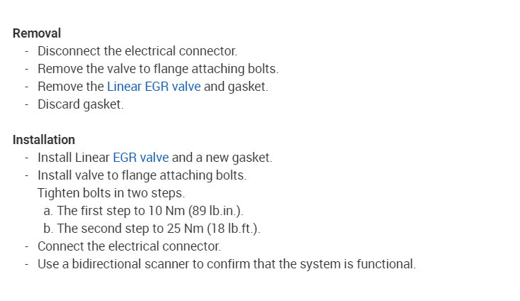

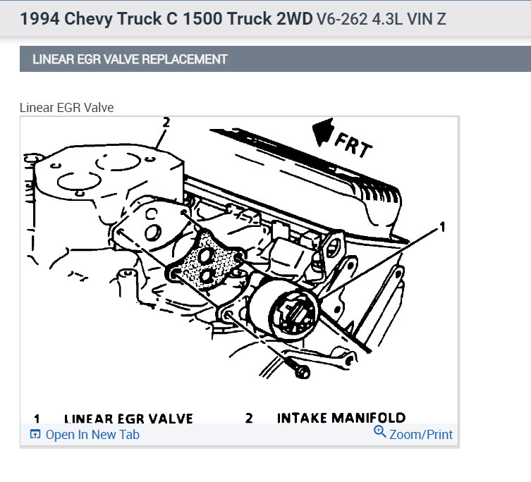

I have seen the EGR valve on these truck stick open sometime which will cause the rough idle condition you have described. Here is a guide that can help you and I have included a video on how to test the EGR valve with instructions below on how to replace it.
https://youtu.be/DqUCbbKdWf4
and
https://www.2carpros.com/articles/troubleshooting-rough-idle-in-your-cars-engine-7-common-causes-and-how
Check out the images (below). Let us know what happens and please upload pictures or videos of the problem.
