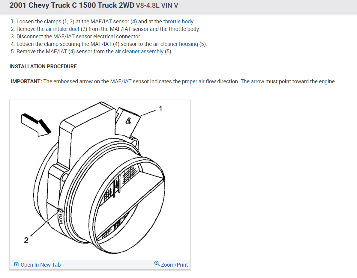

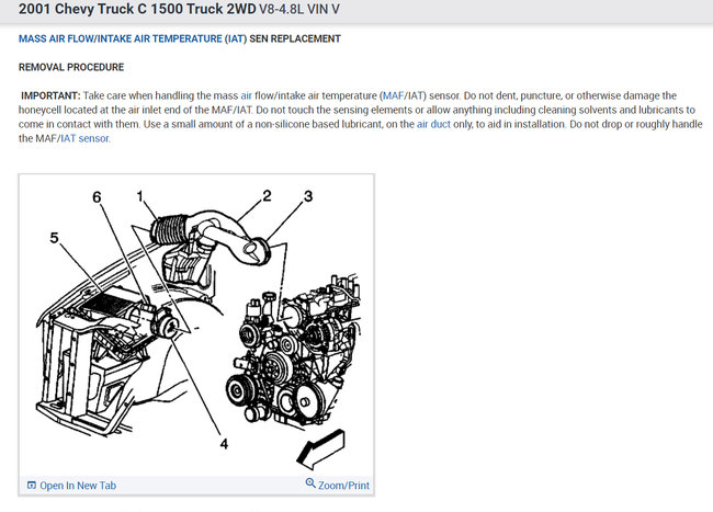

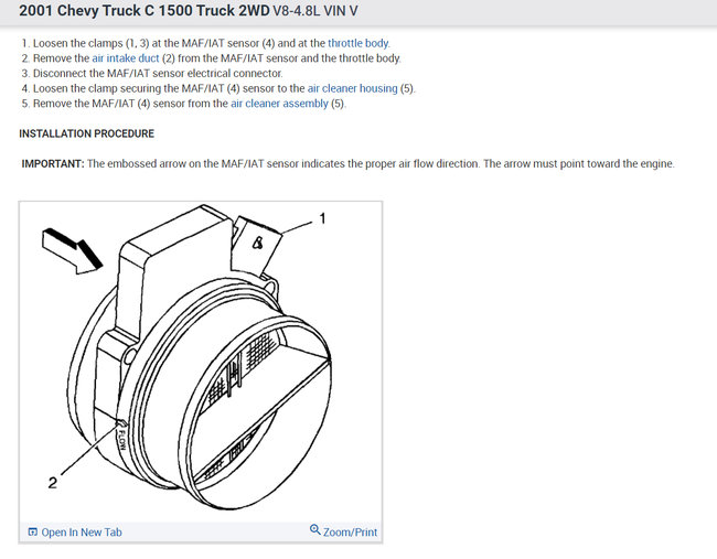

The problem sounds very reminiscent of what my truck was doing. Turned out to be a MAF sensor. Here is the location so you can replace yours. Check out the diagrams (Below). Please let us know what happens.
