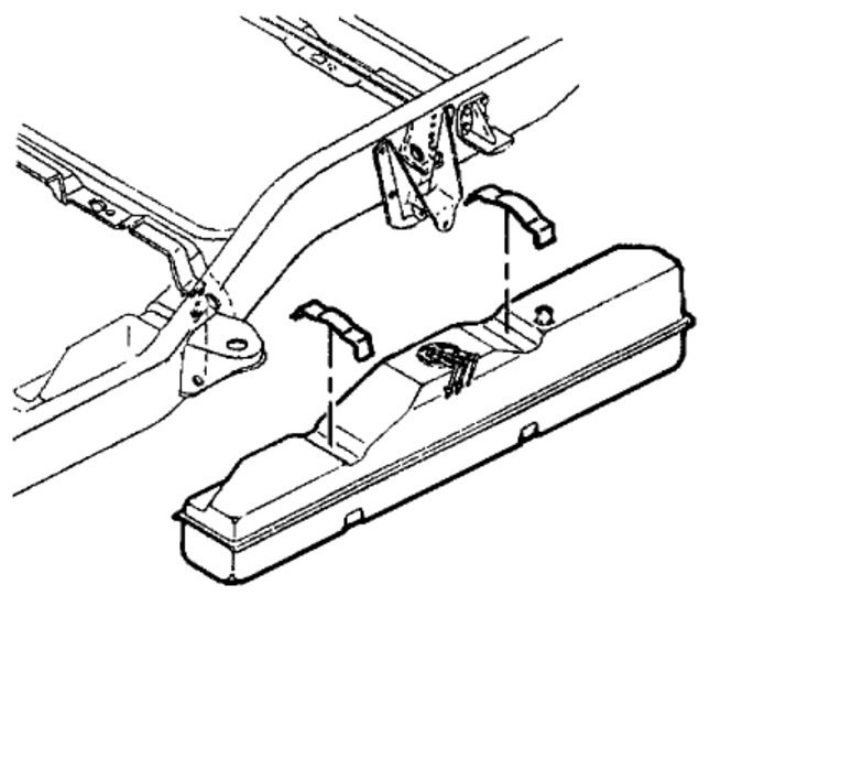

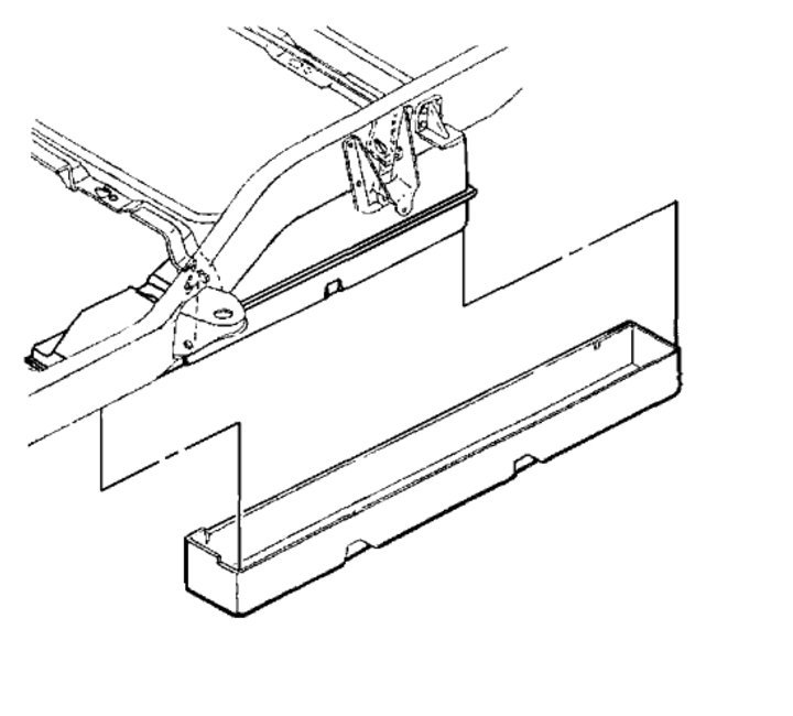

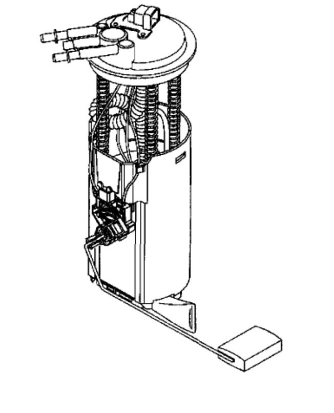

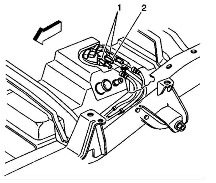

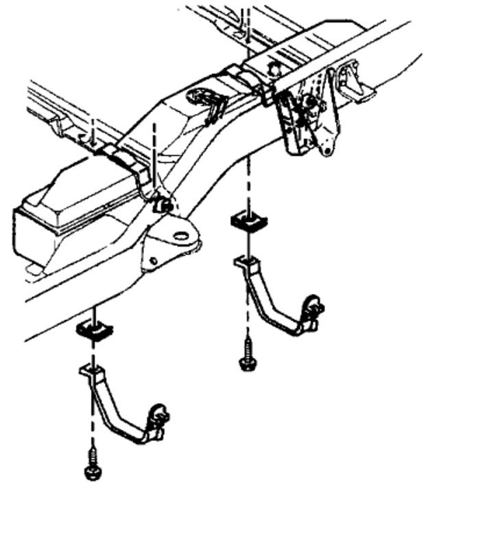

Yes the fuel pumps go out in these trucks all the time. I have put two in my truck.
Here are some guides and some diagrams (below) to help you get the job done:
and
https://www.2carpros.com/articles/how-to-replace-an-electric-fuel-pump
and
https://youtu.be/Q5MH2gnyFH0

I changed the fuel filter and it started right up. It ran and drove good for about two miles and then it died and wouldn't start again.
Jul 12, 2017 at 9:48 AM
  • 55,402 POSTS
Yep, it sounds like the fuel pump has gone bad.
Let me know what happens after you replace it.
