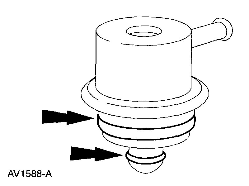

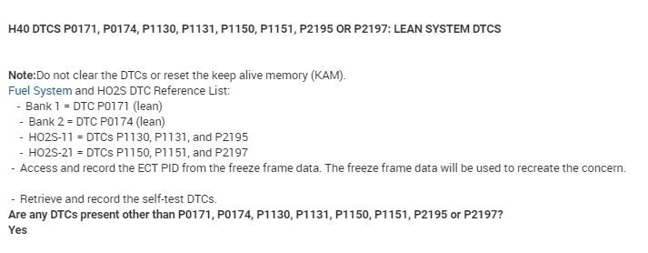

Next, if there is a problem with the fuel pressure regulator which is allowing pressure to be too high, it can cause this type of problem. To check this component, you would need to perform a fuel pressure test along with checking the regulator. Here is a link that shows how that is done:
Before you go through the fuel pressure test, locate the fuel pressure regulator which is located on the fuel rail. There is a vacuum hose attached to it. Remove the vacuum hose and confirm there is no raw fuel in it.
Here are the directions for removal and replacement of the regulator. The attached pictures correlate with these directions. I attached these directions in case you determine the regulator is the problem.

FUEL PRESSURE REGULATOR
REMOVAL
WARNING:
- Do not smoke or carry lighted tobacco or open flame of any type when working on or near any fuel-related components. Highly flammable mixtures are always present and may be ignited. Failure to follow these instructions may result in personal injury.
- Fuel in the fuel system remains under high pressure even when the engine is not running. Before working on or disconnecting any of the fuel lines or fuel system components, the fuel system pressure must be relieved. Failure to follow these instructions may result in personal injury.
1. Relieve the fuel pressure.
2. Remove the upper intake manifold.
Picture 1
3. Remove the fuel pressure regulator.
1 Disconnect the fuel pressure regulator vacuum hose.
2 Remove the snap ring.
3 Remove the fuel pressure regulator.
Picture 2
4. Remove and discard the fuel pressure regulator O-ring seals.
INSTALLATION
1. CAUTION: Use O-ring seals that are made of special fuel resistant material. Use of ordinary O-ring seals can cause the fuel system to leak. Do not reuse O-ring seals.
NOTE: Lubricate the new O-ring seals with clean engine oil to aid installation.
To install, reverse the removal procedure.

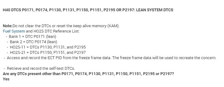

Joe, I went back and listened to my conversation with him I had today and he was saying the code is only for one bank not both but the fuel trim is reading both sides at +40 and should only read -5 to +5. basically it is starving for fuel. Not sure if that helps with anything but they do know that but not why the fuel trim readings are +40.
Mar 20, 2019 at 12:41 PM
  • 110,241 POSTS
Welcome back:
This is a tough one. If I had the vehicle, here is what I would do and in this order.
1) Confirm there are no other codes in addition to the 2195.
2) I would check freeze frame data to see if there is anything I can use to pinpoint any specific issue.
3) If nothing is found with freeze frame data, I would then carefully inspect the wiring to the O2 sensor for fraying, damage, connection, corrosion and so on.
4) If the wiring was good, check for vacuum related issues and repair as needed.
5) If that checks good, confirm there are no exhaust manifold leaks on that bank. The 5.4 is known for leaks.
6) If nothing was found, I would replace the O2 sensor.
The +40 on the scanner indicates the computer is trying to compensate for a lean mixture by making the fuel mixture richer. I would expect it to be like that.
Now, earlier you mentioned that the O2 sensors were checked. I'm starting to question if the sensor itself is bad.
