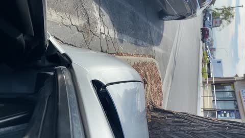

I’ve recently been dealing with rough idle whenever my car is at a stop generally sounds like somthings knocking under the hood which makes the car shake.It goes away and comes back after my car warms up.I have changed the icv and nothing changed.I do have a CEL lightnon with is P0740 which is for a solenoid which I already have changed and yet it still gives me the code after i deleted it.

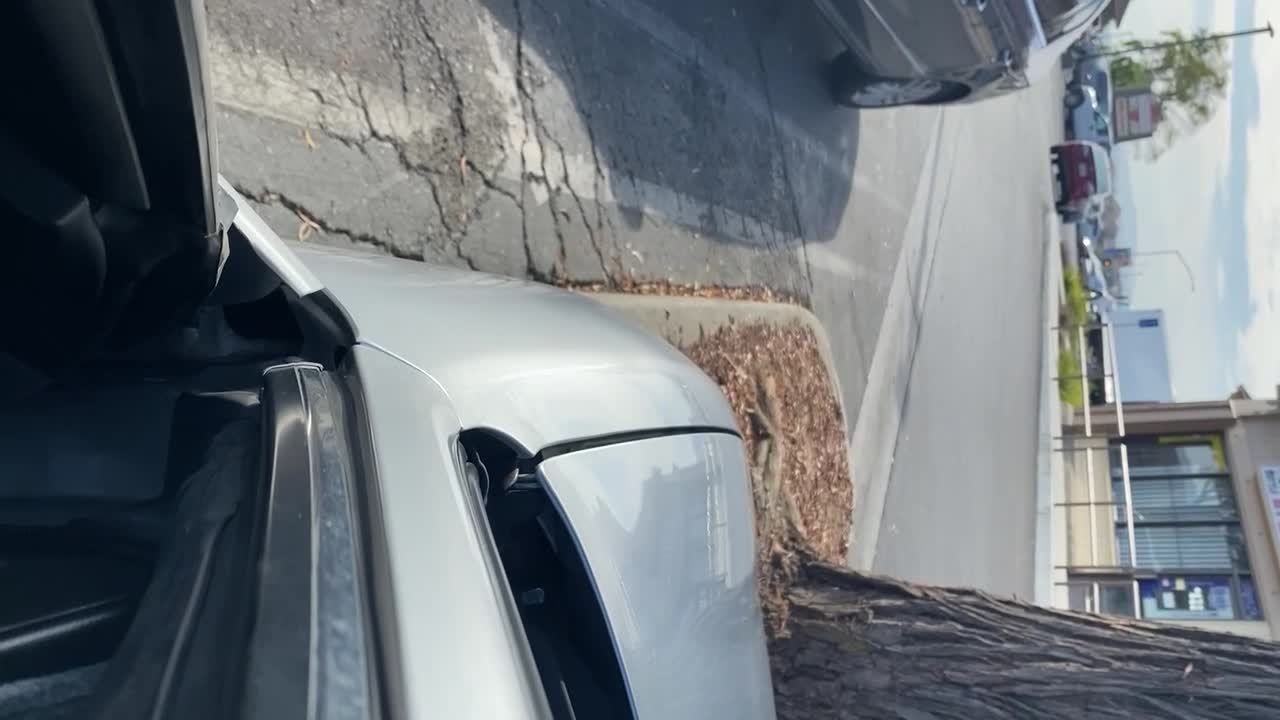

I recently changed the sparkplugs like 2 months ago so theyre fairly new.In the video you can hear me revving it a bit and then it sounds like it wants to turn off but comes back up.

Thanks for the video. It does sounds like thing is wrong with the timing belt/tensioner but if you could get a video of the front of the engine under the hood I can tell for sure. Also how many miles are on the engine? you said 99k but I wanted to be sure it makes a difference.

It has 99,500 miles on the engine and ill take a video when I have time.
