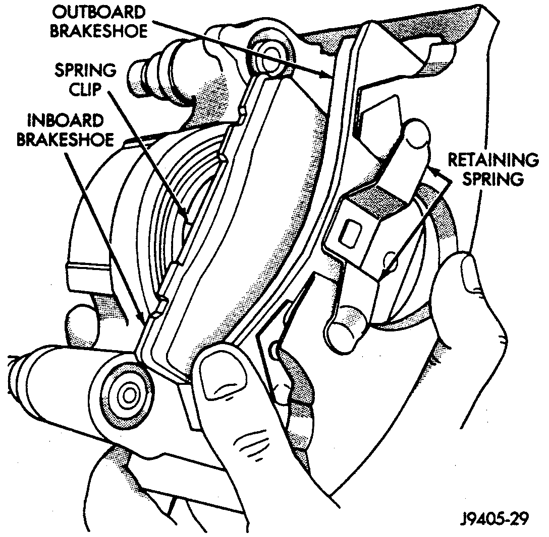

They are two different parts and will not work. I don't know if you need it, but here are the directions for replacing front pads on your vehicle. To remove the rotor, you will need to take off the wheel bearing. When installing new rotors, your old bearings (if good) will need repacked and installed into the new rotor. Additionally, a new wheel bearing seal will need installed.

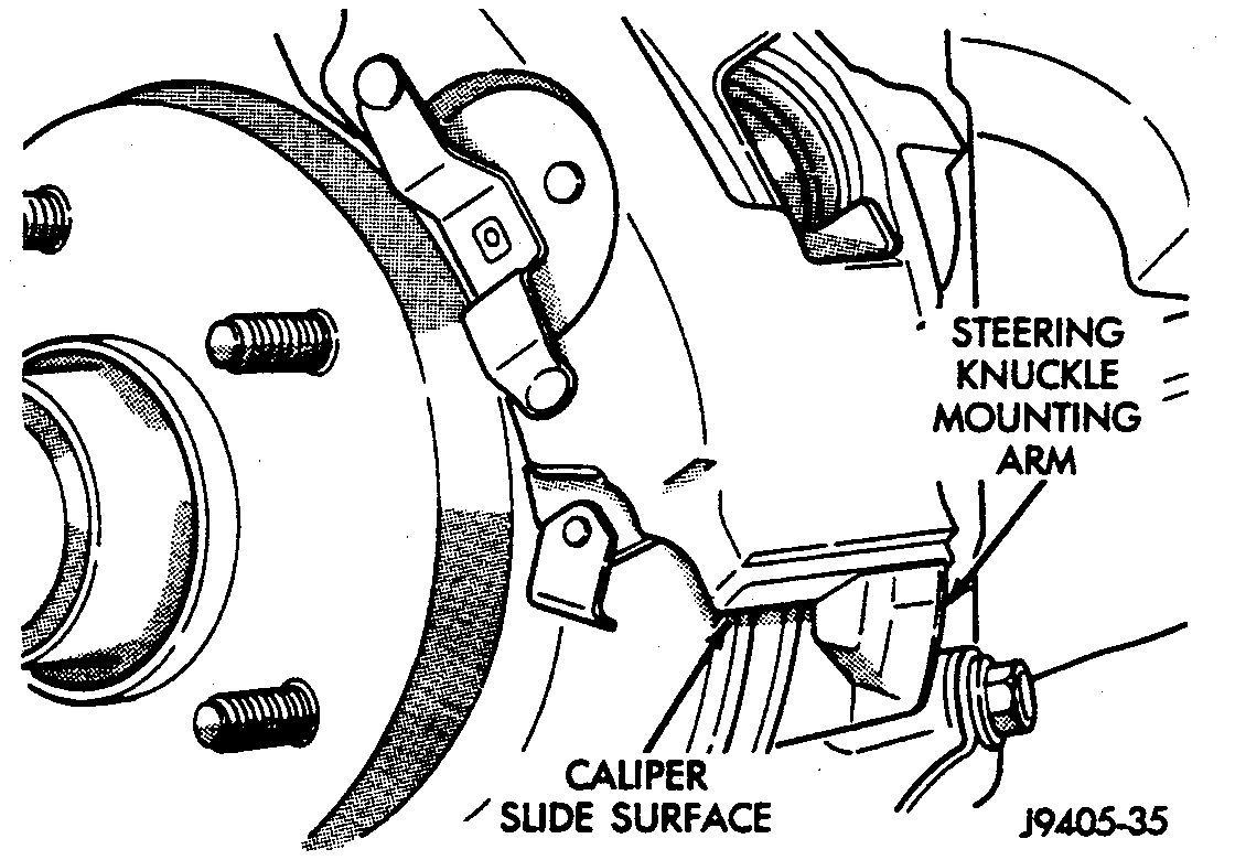

6. Rotate caliper rearward off rotor. and out of steering knuckle support ledges.

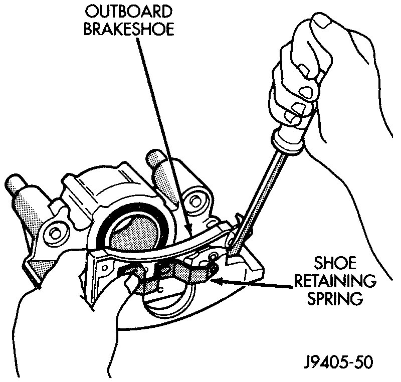

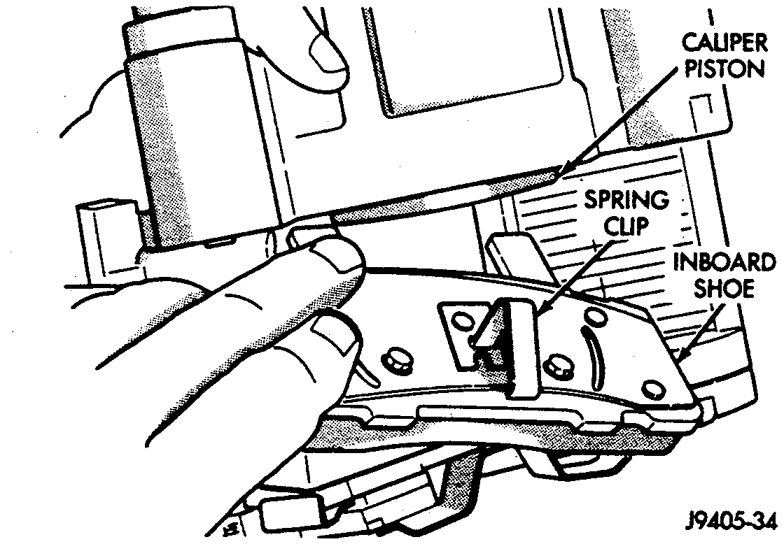

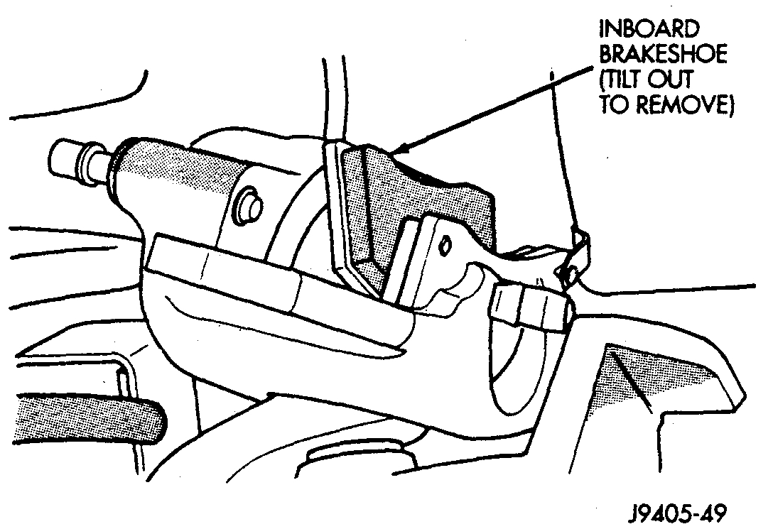

7. Remove inboard and outboard brake shoes. Inboard shoe has spring clip that holds it in caliper piston. Tilt this shoe out at top to unseat clip. Outboard shoe has, retaining spring that secures it in caliper. Unseat one spring end and rotate shoe out of caliper.

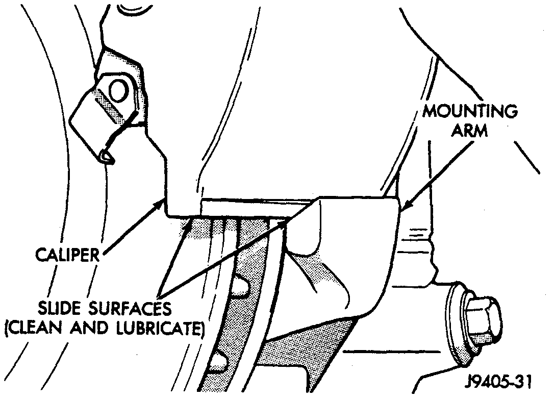

Caliper And Steering Knuckle Slide Surfaces

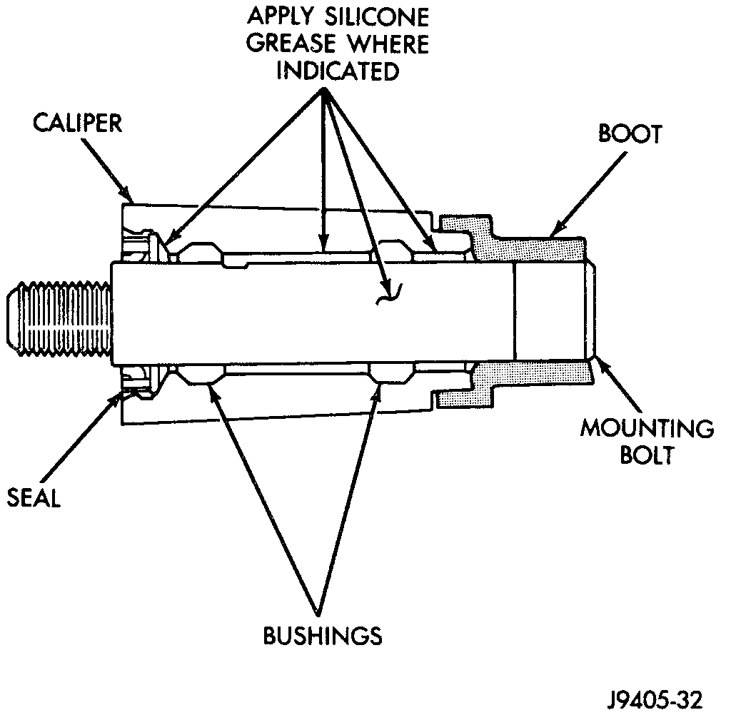

1. Clean caliper and steering knuckle slide surfaces with wire brush. Then apply coat of Mopar multi-mileage grease to slide surfaces.

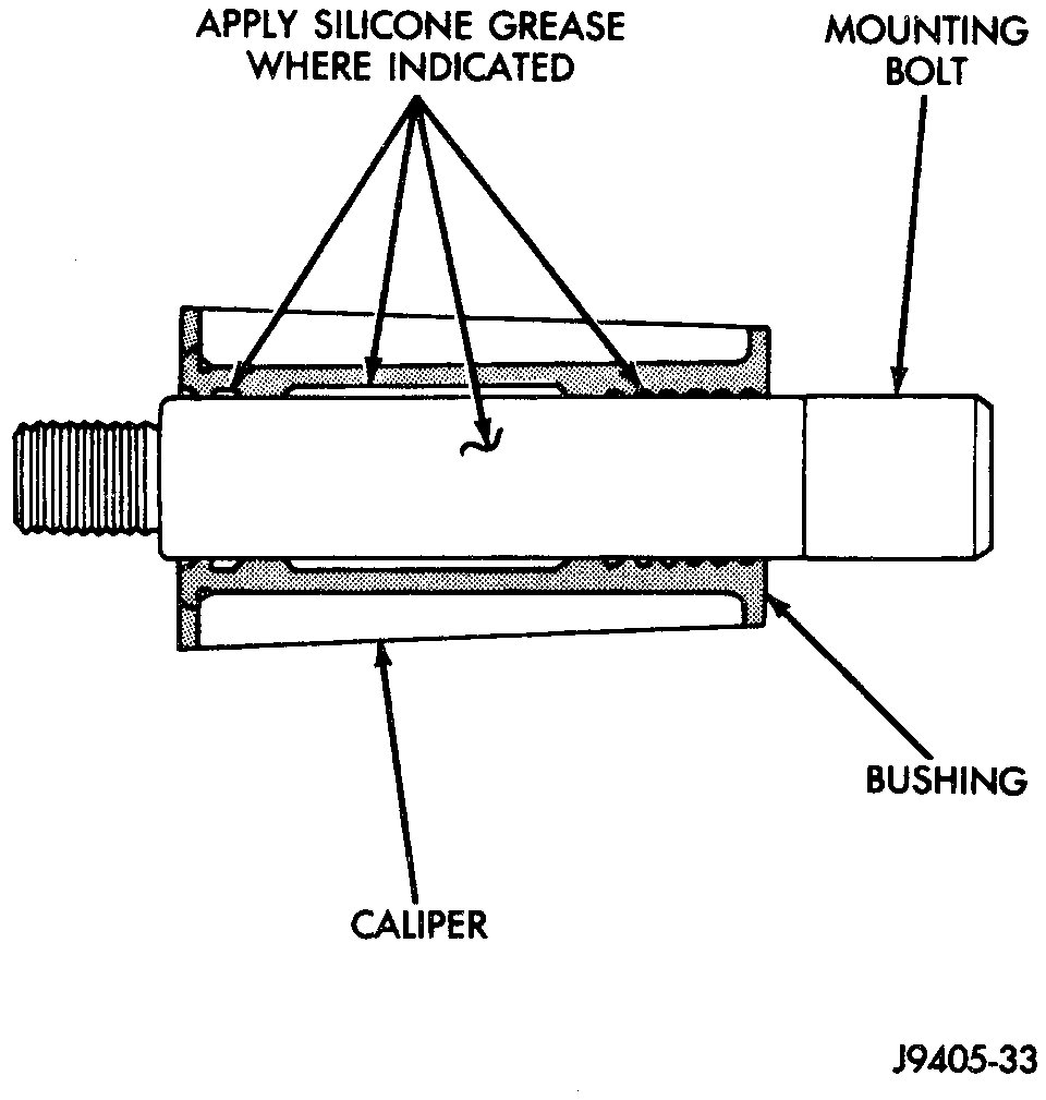

2. Lubricate caliper mounting bolts, collars, bushings and bores with silicone grease as follows:
Mounting Bolt Lubrication (75mm Caliper)
- 1/2 ton models with 75 mm caliper, apply silicone grease to mounting pins and collars. Then fill space between bushings in caliper.
Mounting Bolt Lubrication (80 Or 86mm Caliper)
- 3/4 and 1 ton models with 80 or 86 mm calipers, coat mounting pin and interior of bushing with silicone grease.
Inboard Brake Shoe Installation
3. Install inboard brake shoe in caliper. Be sure spring clip on shoe is properly aligned and seated in caliper piston.
Brake Shoe Position In Caliper
4. Install outboard brake shoe in caliper. Be sure spring ends are seated in dimples in caliper.

5. Install caliper over rotor and into steering knuckle mounting arms. Be sure caliper is seated flush on mounting arm surfaces as shown.
6. Start caliper mounting bolts by hand to avoid cross threading. Then tighten mounting bolts to 51 Nm (38 ft. lbs.) torque.

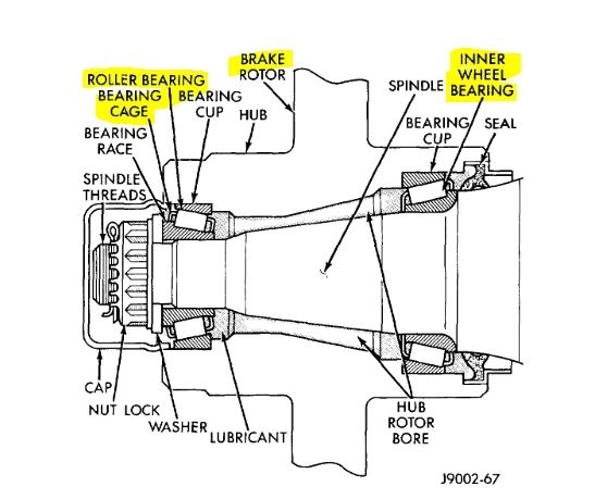

Here are the directions for replacing the bearings. These directions explain removal of the rotor so you can access the bearings. This is why 4wd parts won't work. They do not have a spindle and bearing the way this one does.
REMOVAL
1. Raise and support the vehicle.
2. Remove the wheel and tire assembly.
3. Remove disc brake caliper.
4. Remove the dust cap, cotter pin, nut lock, nut and washer from spindle.
Wheel Bearings & Hub/Rotor
5. Carefully slide the hub/rotor from spindle.
CAUTION: Use care to prevent inner wheel bearing and seal from contacting spindle threads during removal.
6. Remove the seal and inner wheel bearing from the hub/rotor.
7. Remove the inner and outer bearing cups from hub/rotor with a pin punch.
INSTALLATION
1. Install the new bearing cups with an appropriate size driver tool.
2. Apply a coating of MOPAR Wheel Bearing Grease to inner surface area of hub.
3. Clean and grease inner and outer wheel bearings.
4. Install inner wheel bearing and new bearing seal.
5. Inspect bearing and seal contact surfaces on spindle for burrs and roughness.
6. Remove all rough contact surfaces from spindle. Apply a coating of lubricant.
CAUTION: Use care to prevent inner wheel bearing and seal from contacting spindle threads during installation.
7. Carefully slide the hub/rotor onto the spindle. Install outer wheel bearing, washer and retaining nut.
8. Tighten the nut to 41-54 Nm (30-40 ft. lbs.) to preload bearing while rotating the hub/rotor. Stop hub/rotor and loosen nut to completely release bearing preload torque. Tighten the nut finger-tight and install the nut lock. Install a new cotter pin.
NOTE: The end play should be 0.25-0.076 mm (0.001-0.003 inch).
9. Clean the dust cap and apply a coating lubricant to the internal surface. Do not fill the dust cap with lubricant. Install the cap.
10. Install disc brake caliper.
11. Install the wheel and tire assembly and lower the vehicle.
