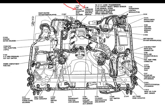

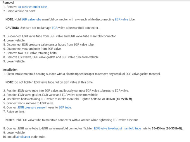

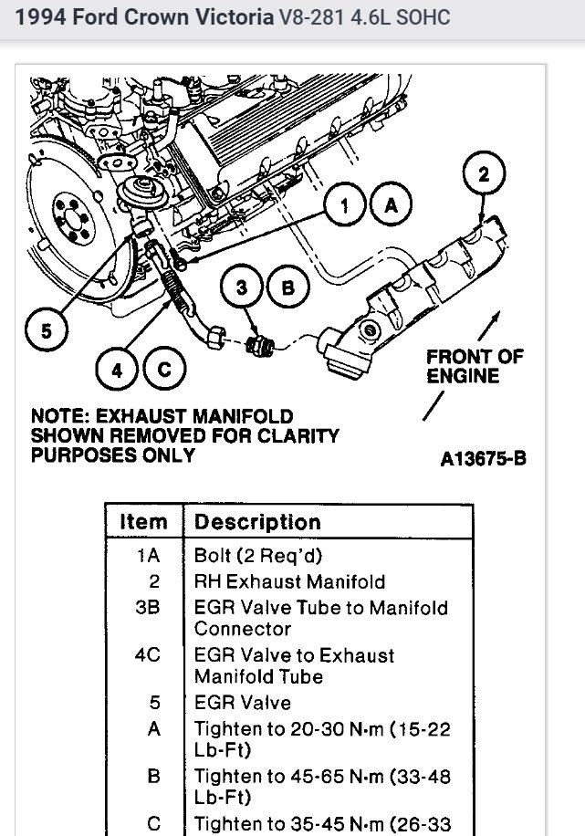

That port goes to the EGR pressure feedback sensor which will give you the EGR flow code. The Pressure Feedback EGR (PFE) Sensor is located at center rear of engine, near RH side of intake manifold. Please make sure the EGR valve ports are clear and free from carbon. Check out the images (below). Please let us know how it goes.

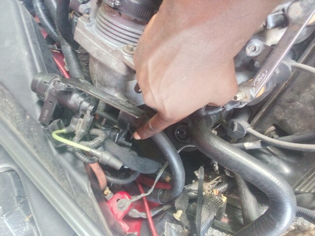

Pic of port underneath vacuum solenoid.

That could be an open air vent which is no to have anything on it. When the engine is running does it have vacuum?

That was the issue with my EGR valve. I bought a foot of hose from part store and code instantly disappeared.
