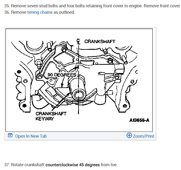

i want to service my rocker arms and hydraulic lifters myself at home. aside from the obvious of getting new rocker arms and hydraulic lifters... what other new parts would i need? i know i need new bolts for the headers because it's not recommended to reuse. also is this a job someone like an avg joe as me can tackle at home?
Mar 14, 2025 at 5:25 AM
  • 55,423 POSTS

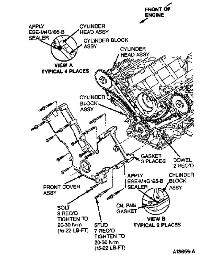

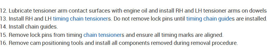

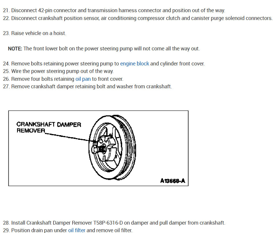

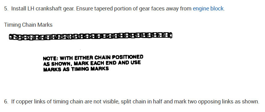

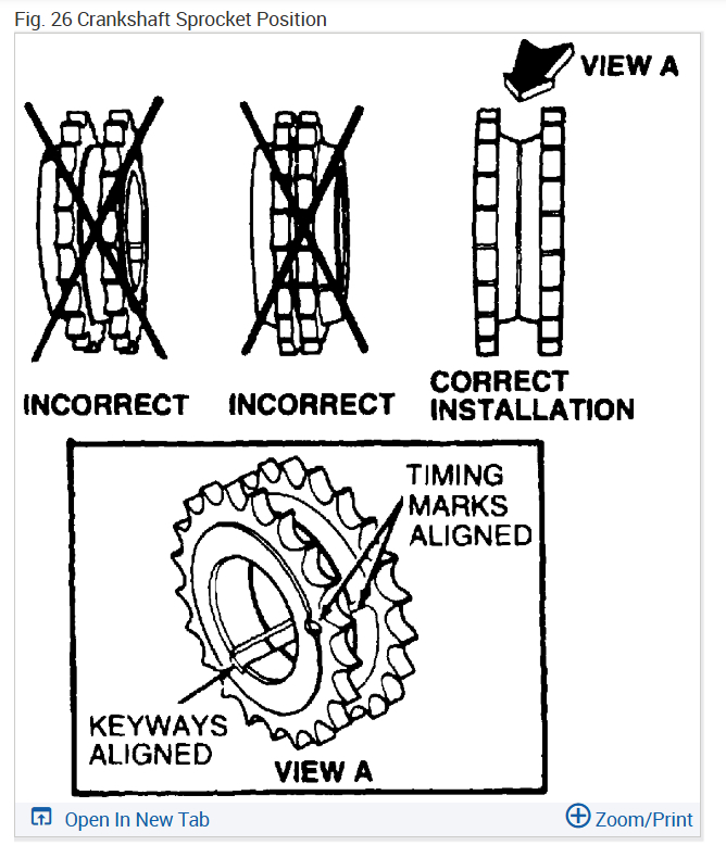

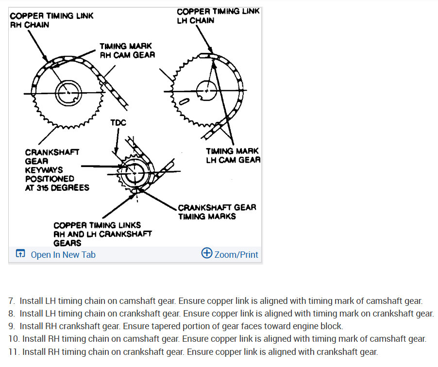

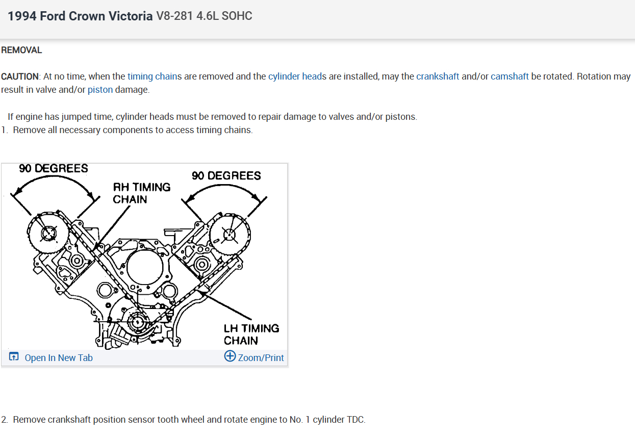

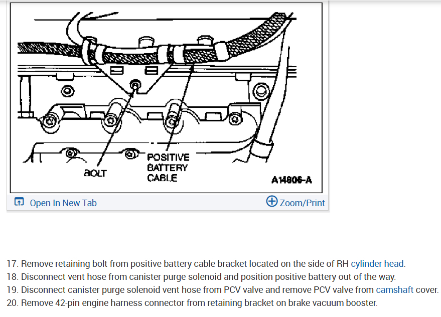

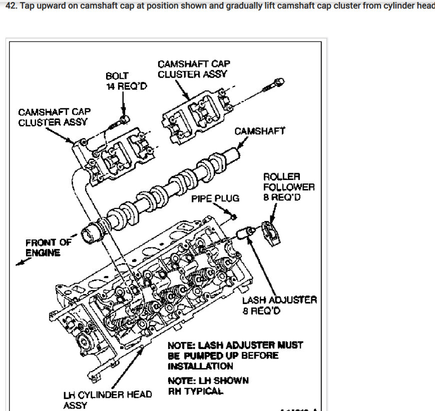

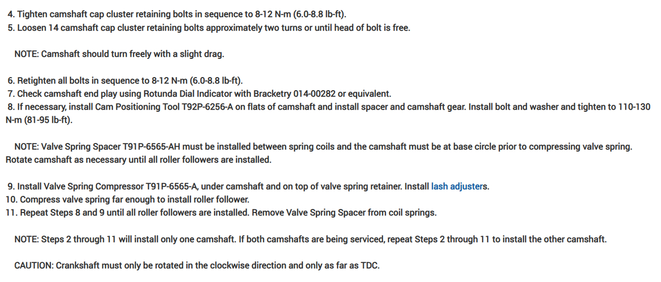

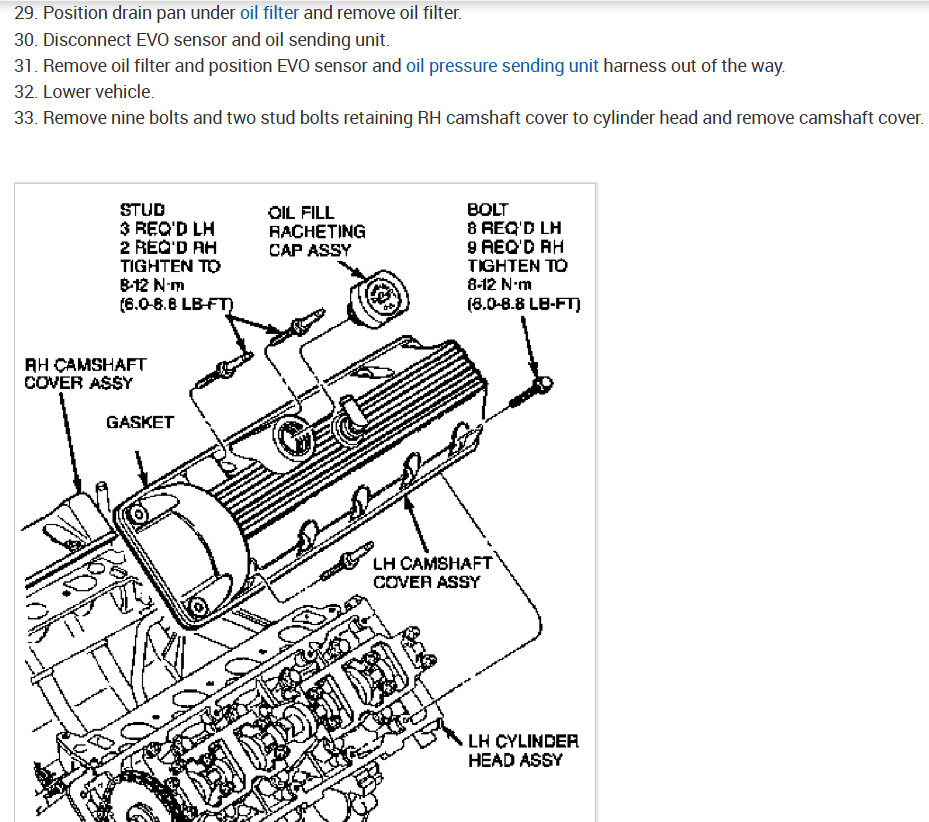

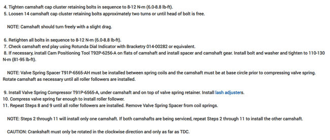

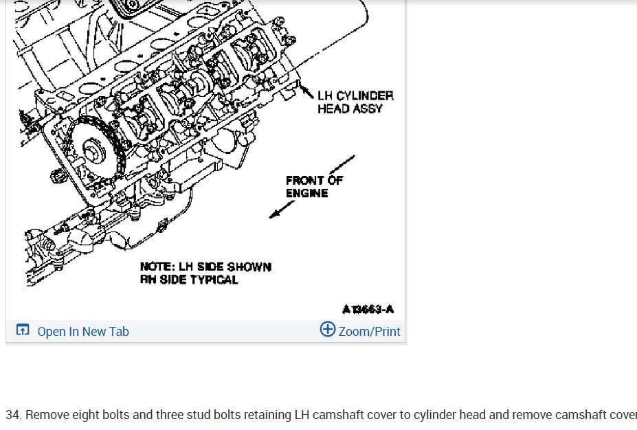

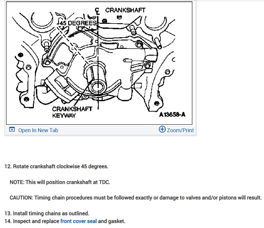

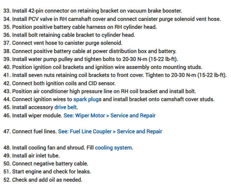

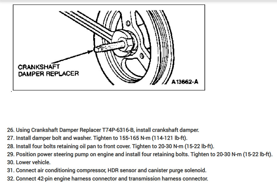

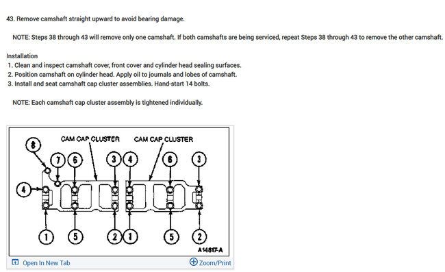

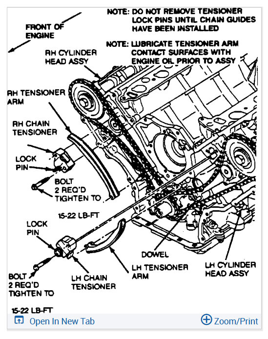

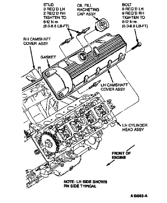

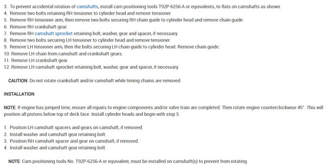

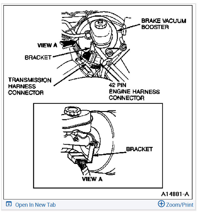

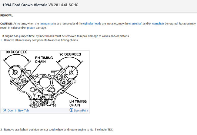

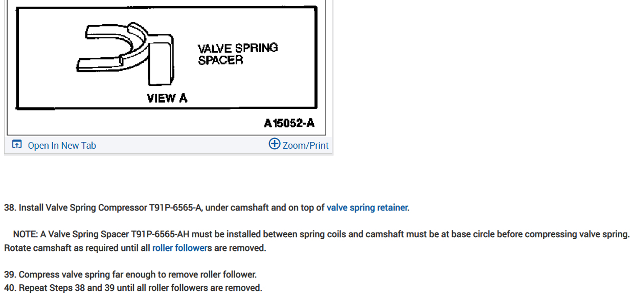

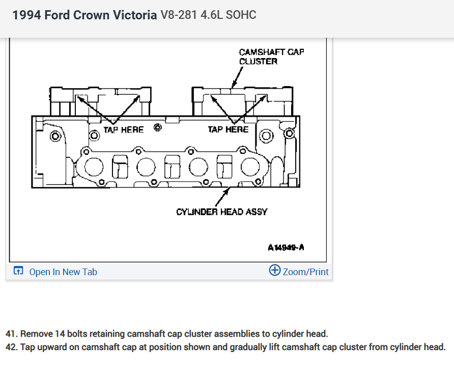

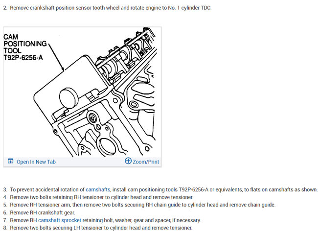

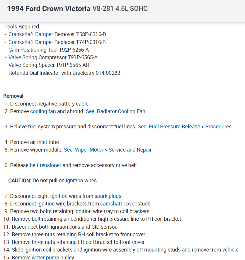

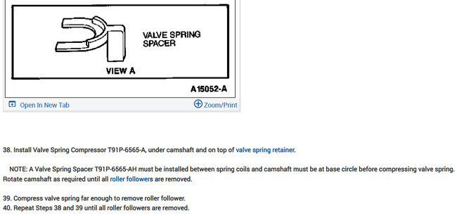

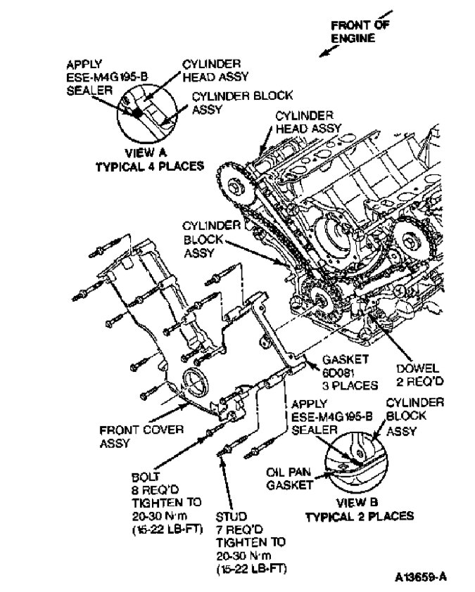

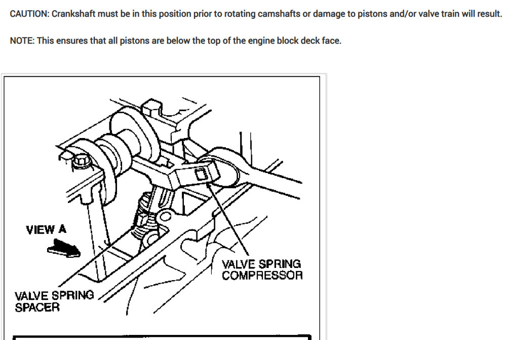

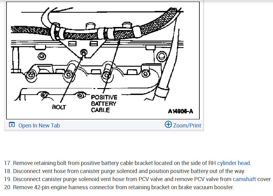

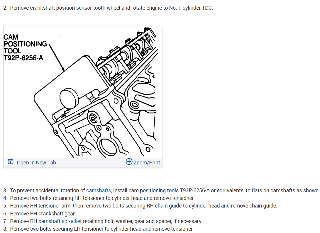

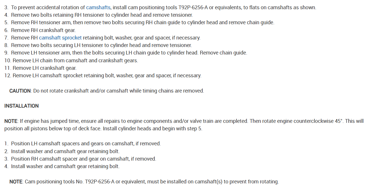

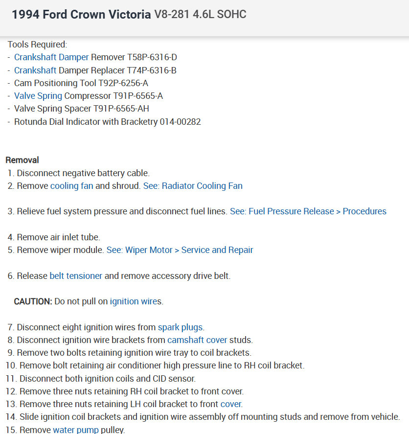

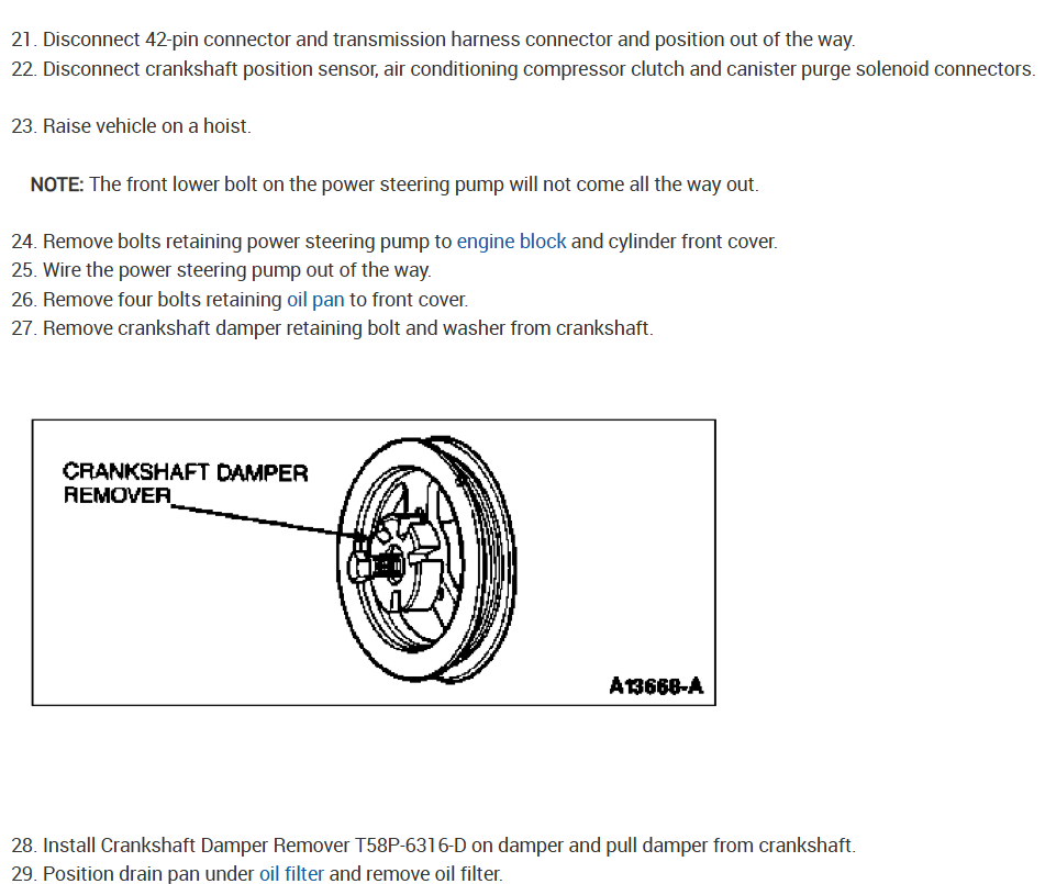

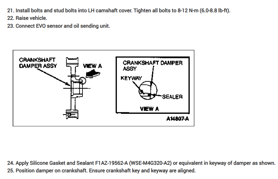

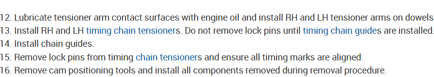

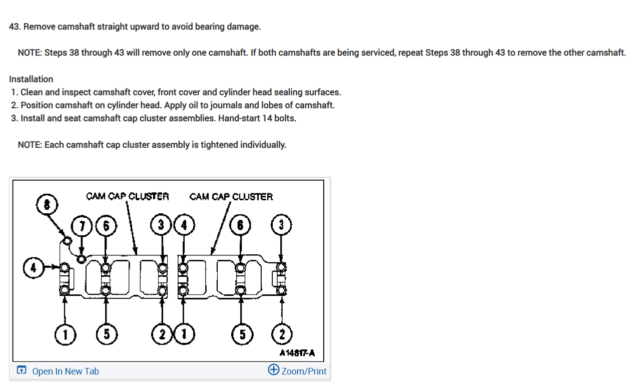

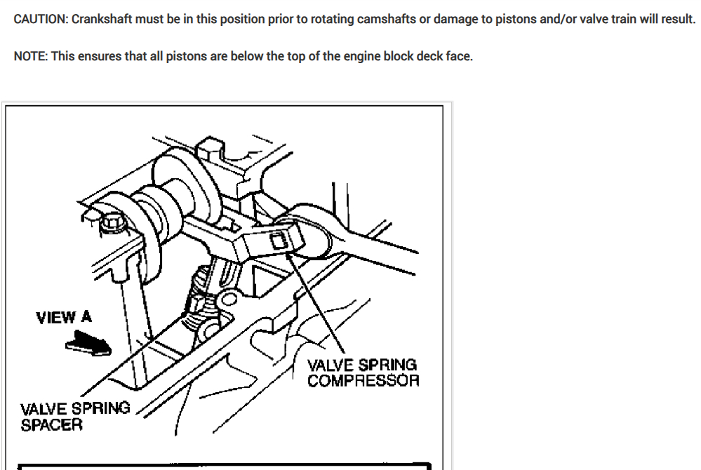

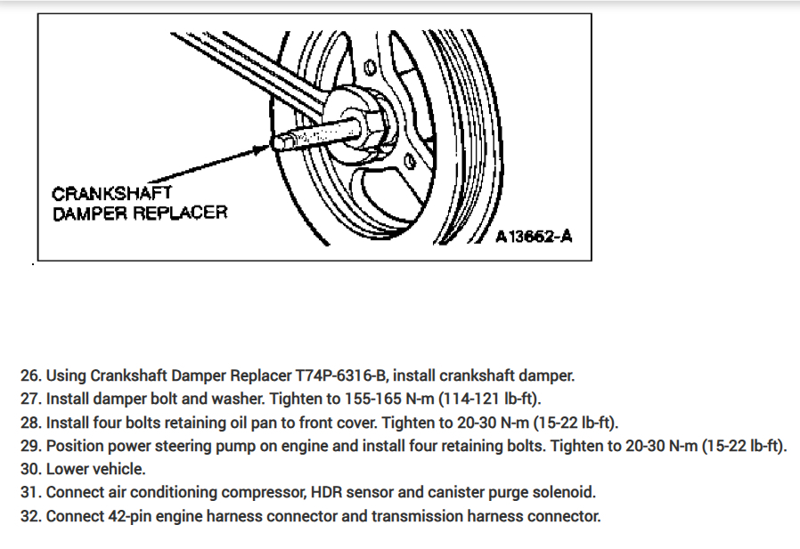

Sure, if you have the tools and take your time, I will guide you through the job np. Here is a video to help get an idea of what needs to be done, and I have included instructions in the images below, you will need to remove the timing cover so start by disconnecting the battery and drain the coolant. If you watch the series, it will help you know more about that engine.
https://youtu.be/dler2t2e4Zw?si=gakpwBaoFJGiLSOB
You will need some specialty tools which are listed and featured in the video. Upload images or videos of any problems you are having. You should replace the timing chains and inspect the camshafts as well. Go over all of the material before you begin to see if you feel comfortable in doing a job this size. The timing chain marks are at the end of the images. Check out the images (below). Let us know how it goes.

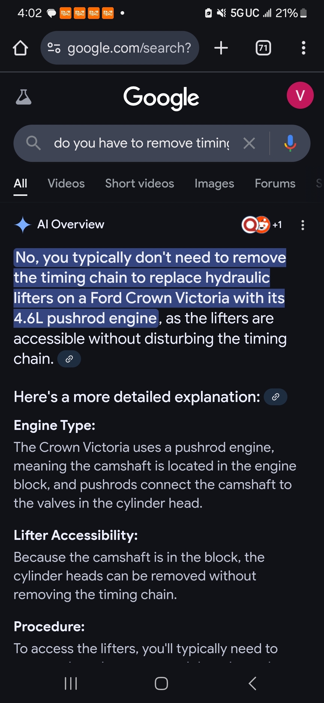

Yep, AI misses it sometimes, it thinks you have a pushrod engine and in block camshaft which is not true. You can see the lifters will not come out unless you remove the camshaft towers. If you remove the valve cover and shot an image straight over head so we both can be sure.
