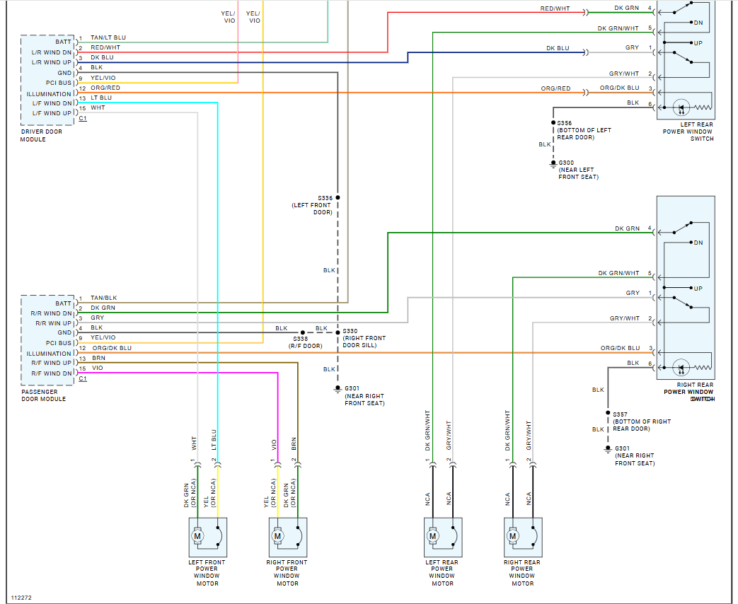

From both the driver and the Rt rr door switches the window goes down, not up. I'm able to hot wire the motor to make it go up. With auxiliary on, I'm getting 12V to both up/down feeds at the switch connection. The switch continuity tests as follows:
G and G/Wt
Gy and Gy/Wt
G/Wt and Blk in one position
Gy/Wt and Blk in the other
I'm getting constant 12V to both wires at the motor connection.
Seems like 2 12V feeds to the motor is a bad thing.
I get microvolts to one side when the switch is activated and 12V to the other, in either position.

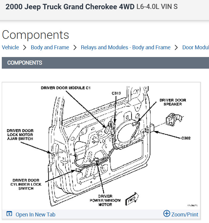

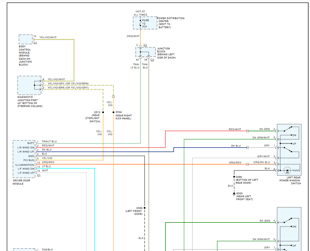

If the master switch is bad the switch at the window will not work window. Here are the wiring diagrams to help you see how the system works and a guide to test for power and ground.

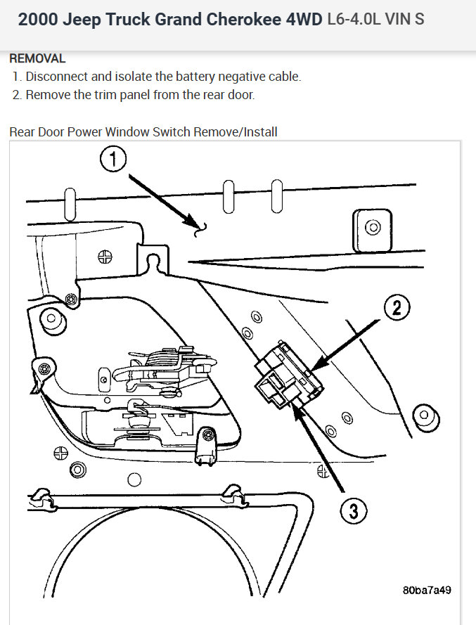

Here is how to change the master switch out which might fix the problem. Also, I see there is a passenger side door module which I have seen go out as well. Check out the images (below). Let us know how it goes.
