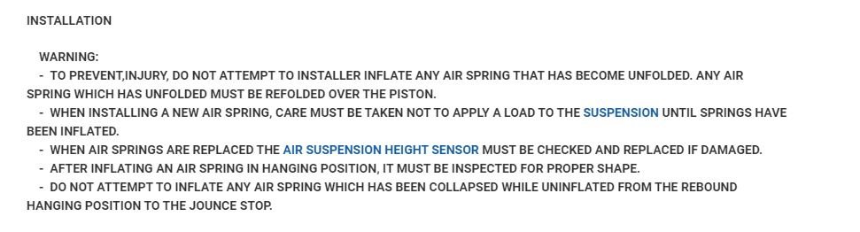

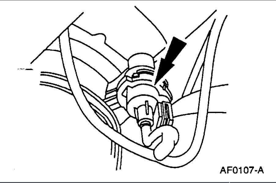

I have replaced the bag, solenoid and compressor, and it still drops, left rear stays up. what else could cause this problem?
Mar 22, 2020 at 11:43 AM
Good afternoon,
Did you replace the vent solenoid with the airbag?
Did you drop the car all the way to the ground and then start it up? I have seen where the bags are replaced and damaged when dropping it down and it hits the ground. The bag gets pinched and will not hold air.
