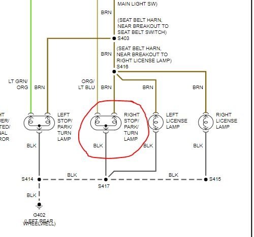

Right rear brake light and turn signal do not work

However, the other side works. The only thing lights up on the right side is the park lights. I replace the bulb because it was burnt but the new bulb don't do nothing.

First, confirm the bulb is the correct replacement. This will require a dual element bulb.
Next, I attached a pic below from the wiring schematic. I need you to check for power to the orange/light blue wire that goes to the socket. Also, check for continuity to ground on the black wire.
Here are a few links you may find helpful when testing:
___________________________
When testing, make sure the light socket isn't corroded or damaged where the bulb goes. Make sure the pins that make contact to the bulb are not bent or damaged in any way.
