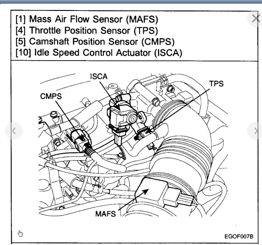

If not then we need to check the fuel pressure as it may be loosing its prime when you start the vehicle. So let's use this guide and test the fuel pressure after the engine starts and stalls:
The last most likely cause is the idle control has failed.
https://www.2carpros.com/articles/how-to-replace-an-idle-speed-control-motor-iac
Below you will find the detail about your idle control. If nothing else, I would replace this and retest the issue.

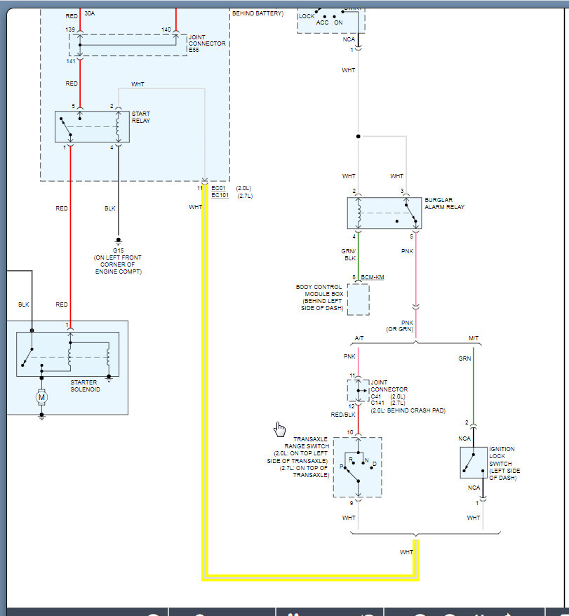

It record really high a couple more times then like magic it leveled out . But i have no lights brake or turn signals and I have headlights but when I switch them off they stay on until i shut off the car . Also to start it i have to take the relay cover off and just touch it and it starts right up. I'm so confused.

The lights issue sounds like a different issue so let's get a new post started for that but if you can clarify what you are touching in the relay cover to get the engine to start that would help.
It sounds like there is a loose relay so we need to narrow this down. If you can notice what you are touching to get it to start and then get a picture of that or tell me what it is and we can dig further into that.

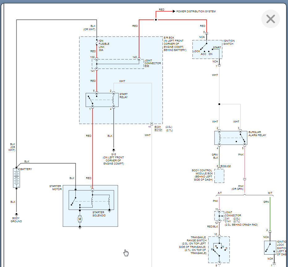

I am touching the starter relay the one next to the main relay the copper inside of the relay itself.

DANI ZATELLI
And I'm touching it with my finger i take the cover off of the relay itself and then just touch it. Starts every time like that . I'm going to take a pic of it here in a few minutes.

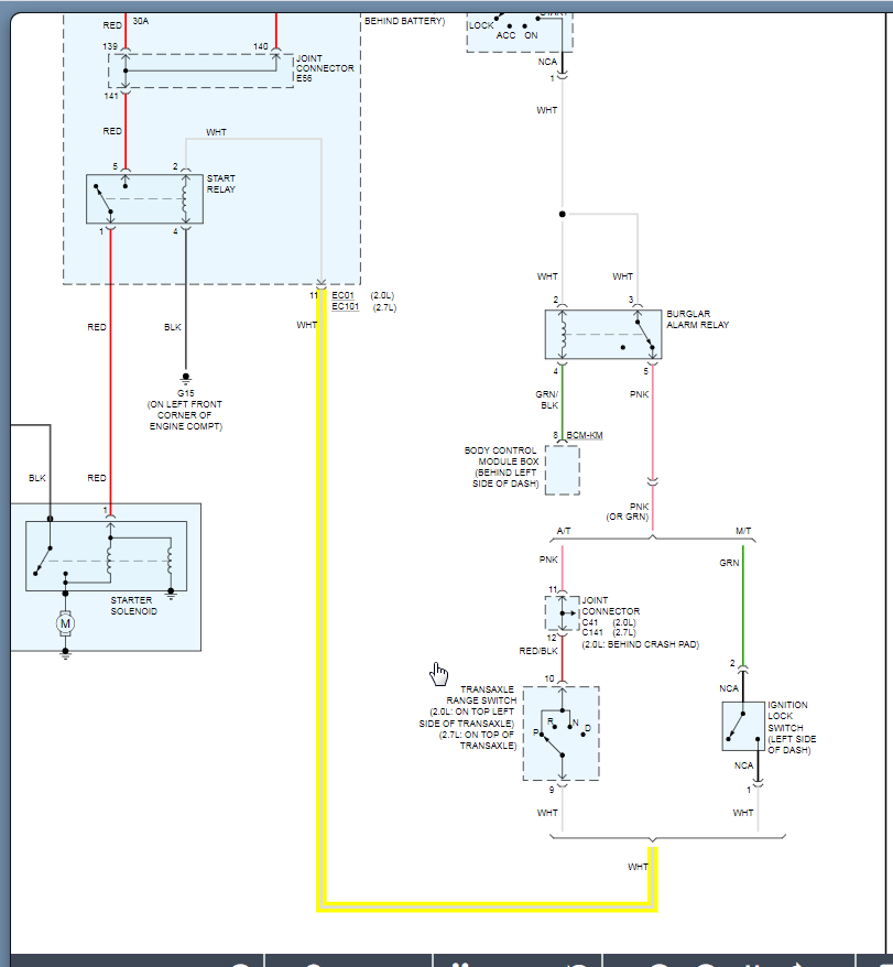

That is great info. So what you are doing is closing the relay yourself rather then the coil side of the relay where it energizes when power is applied to it and it pulls the contact closed.
This means that highlighted wire is not supplying voltage. So either the alarm relay has failed or the ignition lock switch (on manual transmissions) has failed or the BCM is not grounding the alarm relay.
Let's go to the ignition switch and test for voltage coming in. If you have it coming in on the green wire then you can just the switch and the engine should start. This proves the switch is the issue.
Let's start with this and go from there.
