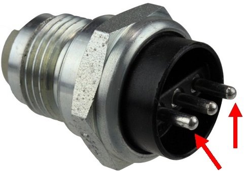

All my reverse lights including my trailer reverse lights went out. Both fuses and relays are good. Any help appreciated.

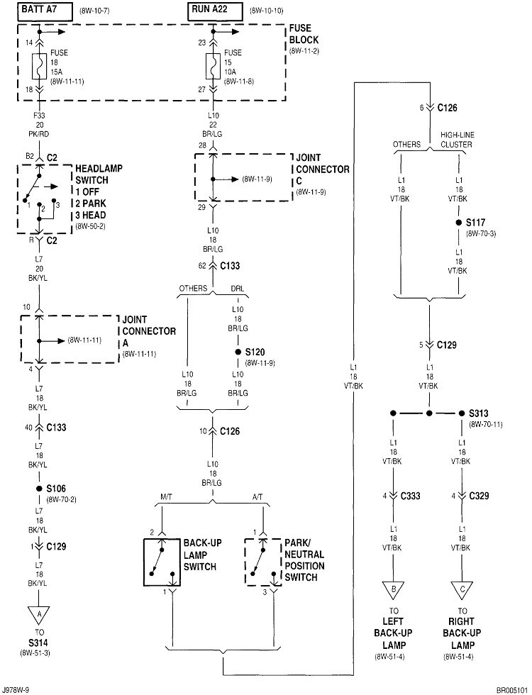

The next best suspect is a defective neutral safety switch. It's shown in the first photo. You'll find it on the left rear corner of the transmission, right above the pan. A fast way to identify this is to turn the ignition switch to the "run" position, crawl underneath and unplug the connector, then use a stretched-out paper clip to connect the two outer terminals. If it's somewhat dark, and you look real closely, you'll see a tiny spark when you make that connection. That's proof current is flowing now. If you can't see that little spark, you'll have to check if the back-up lights are on. If they are, replace that switch. If they still are not on, here's the diagram for the circuit. Start by checking for 12 volts on the brown / light green wire in the plug. Let me know what you find, then we'll go from there.

Thanks for the quick reply! I'll try jumping that wire like you said and see what it does. I keep you updated.
