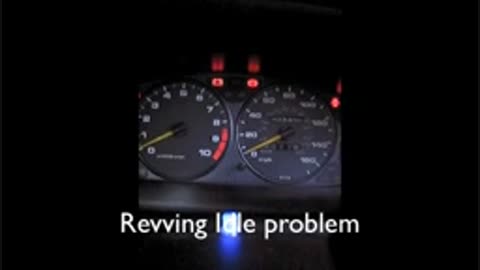

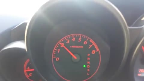

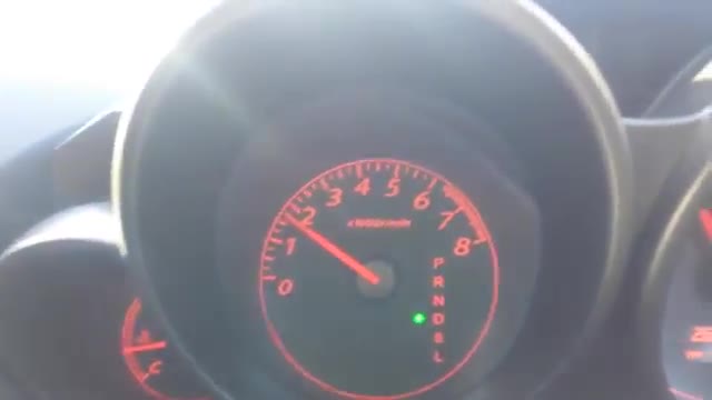

This is what my car doing while am driving (this video I download one of the website), but my car does the same because when if am changing down gears still it revs high.
Jan 6, 2020 at 5:50 AM
SANDILE04
  • 20 POSTS
Same like this car too. so guys what is wrong here or I must clean the throttle body?
Jan 6, 2020 at 5:51 AM

I didn't realize it did it while driving. I thought it was at idle. When the engine is revving up and down while driving, do you feel the vehicle accelerate and decelerate?
Let me know. Also, has the check engine light come on and stayed on with the engine running?
Jan 6, 2020 at 8:07 PM

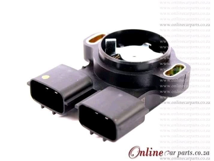

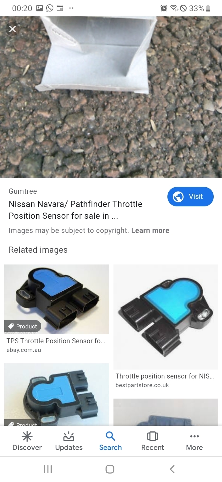

It revving like this car so I went someone he told me I must fix Throttle position sensor it damaged inside that why is doing like this, so can you help on that problem,because now so which means I must go buy that sensor
Jan 10, 2020 at 2:42 PM
SANDILE04
  • 20 POSTS
This sensor,it need to adjust to make rev normal
Jan 10, 2020 at 2:43 PM
  • 110,194 POSTS
That is the throttle position sensor. Yes, it could cause the issue. Did the dealer check it to confirm it is bad before you just replace it? I'm sure it isn't an inexpensive part.

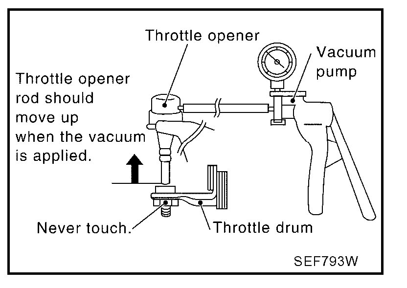

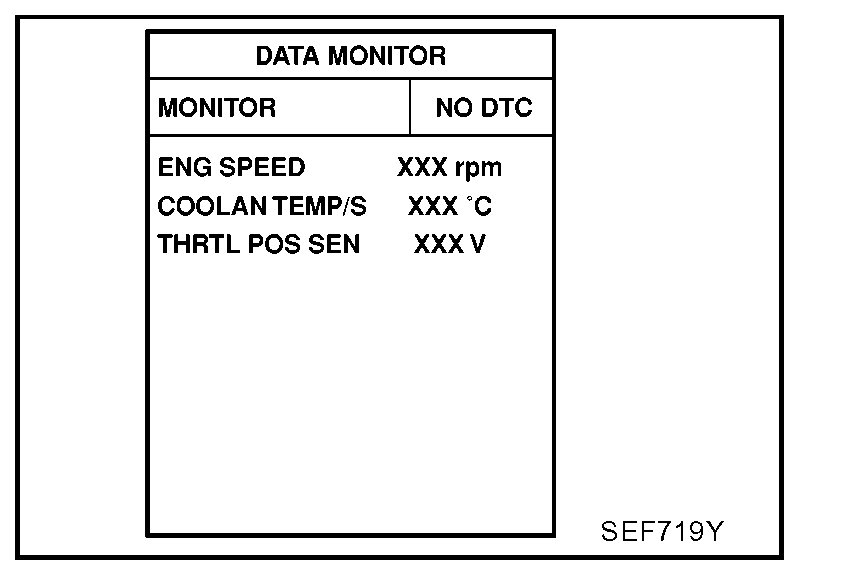

Here are the directions I have for an 02 Sentra with a 1.8L. The attached pics correlate with the directions.
_________________________________________-
2002 Nissan-Datsun Sentra GXE L4-1.8L (QG18DE)
Component Tests and General Diagnostics
Vehicle Powertrain Management Fuel Delivery and Air Induction Sensors and Switches - Fuel Delivery and Air Induction Throttle Position Sensor Testing and Inspection Component Tests and General Diagnostics
COMPONENT TESTS AND GENERAL DIAGNOSTICS
Component Inspection
THROTTLE POSITION SENSOR
With CONSULT-II
1. Start engine and warm it up to normal operating temperature.
2. Stop engine (ignition switch OFF).

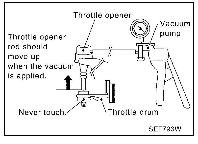

3. Remove the vacuum hose connected to the throttle opener.
pic 1
4. Connect suitable vacuum hose to the vacuum pump and the opener.
5. Apply vacuum [more than -40.0 kPa (-300 mmHg, -11.81 inHg)] until the throttle drum becomes free from the rod of the throttle opener.
6. Turn ignition switch ON.
pic 2
7. Select "DATA MONITOR" mode with CONSULT-II.
pic 3

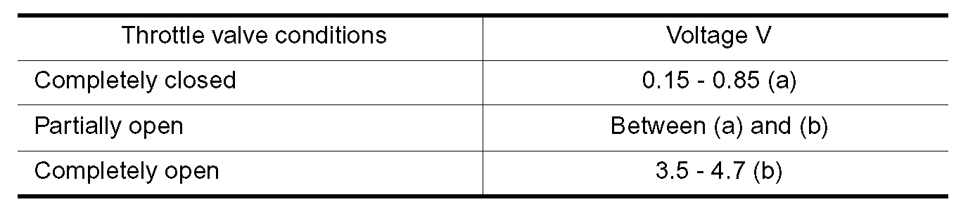

8. Check voltage of "THRTL POS SEN" under the given conditions.
NOTE: Voltage measurement must be made with throttle position sensor installed in vehicle.
If NG, adjust closed throttle position switch. Refer to "Basic Inspection".
9. If it is impossible to adjust closed throttle position switch in "Basic Inspection", replace throttle position sensor.

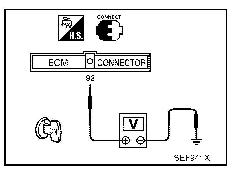

Without CONSULT-II
pic 4
pic 5t
pic 6

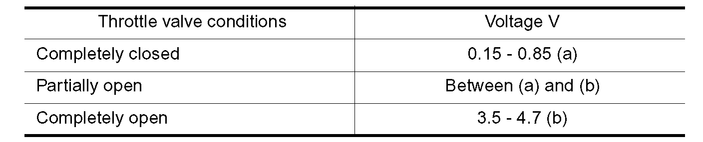

7. Check voltage between ECM terminal 92 (Throttle position sensor signal) and ground under the given conditions.
8. If it is impossible to adjust closed throttle position switch in "Basic Inspection", replace throttle position sensor.

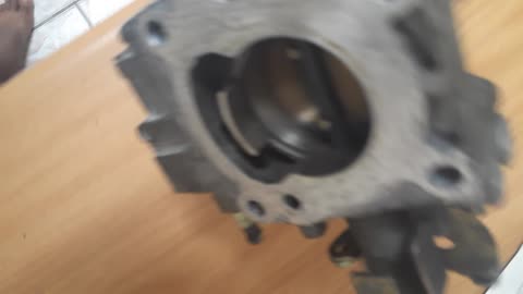

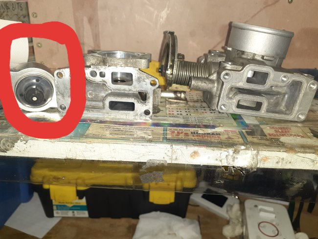

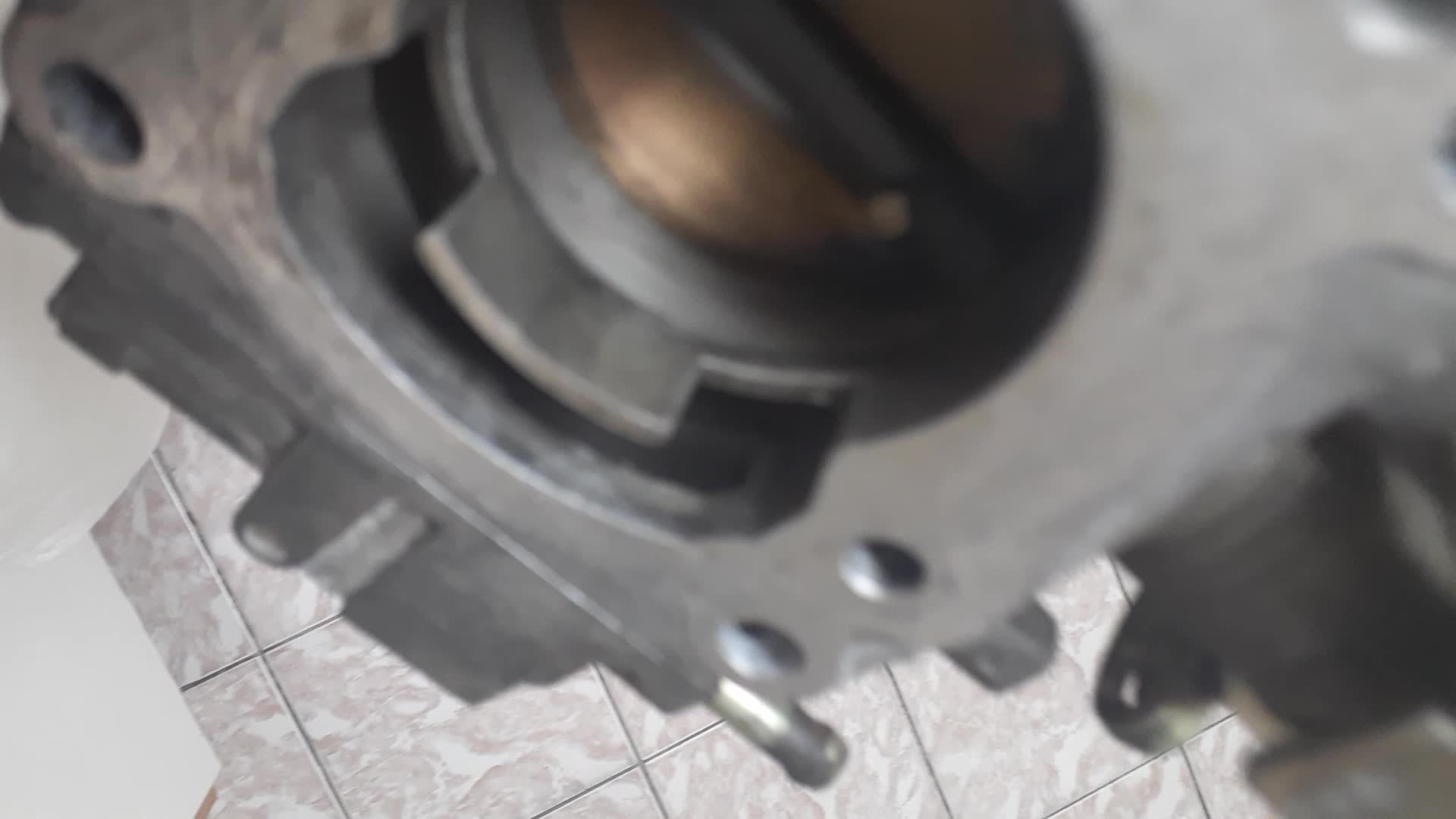

Hi help me here that is my car throttle body,I don't know what noise it making if I shake it,it like something broke inside. Is it suppose to be like this? guys this thing is there inside that hole.
Jan 24, 2020 at 2:56 PM
  • 110,194 POSTS
Nothing should be loose. However, hold the throttle plate when you shake it to see if that stops the noise.
Next, I believe where you pointed is where the idle air control valve (IAC) allows air to enter the engine when the throttle plate is closed. Have you removed the IAC and inspected it?

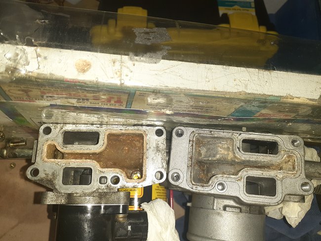

SANDILE04
  • 20 POSTS
I just open my Idle Air Controller Valve saw how dirty inside. so guys do you think it the same thing that makes my car revving up and down?
Jan 27, 2020 at 1:49 AM
  • 110,194 POSTS
Any thing that can cause an air restriction can create an issue. I would also check the IAC itself and yes, make sure the gasket is new. Otherwise you risk having a vacuum leak.

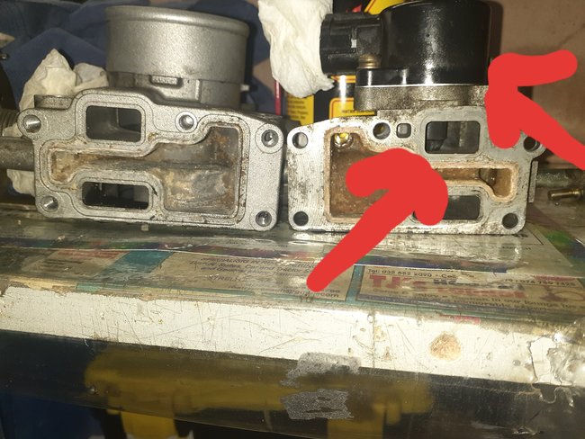

  • 20 POSTS
Guys, what do you call this black thing it where the air goes in throttle body,this one I put red mark?
Feb 2, 2020 at 11:56 PM
  • 110,194 POSTS
That is the idle air control (IAC). That is what changed position to allow air to enter at an idle.
