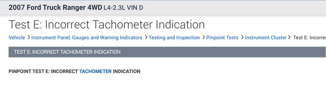

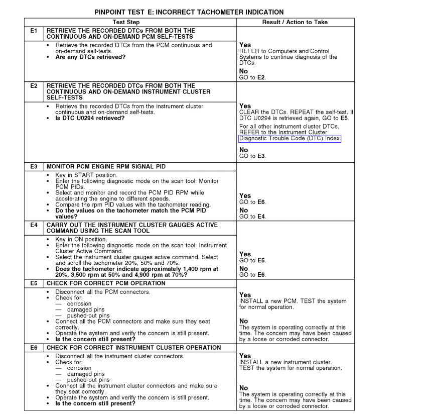

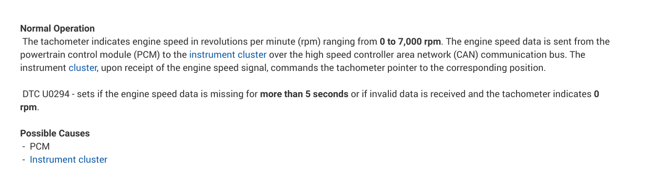

Tachometer needle intermittent not working properly?
2007 FORD RANGER
350,000 MILES • 2.5L • 4 CYL • TURBO • 4WD • MANUAL
RONNIE DU PLOOY
My 2.5 turbo diesel's tachometer jumps and even stop giving readings from time to time.I expect it might be the sender unit on the engine or loose wire/electrical plug.On gravel roads the symptom is less.Where is the sender unit located on the engine?
Please assist. Thank you
Regards,
Ronnie
Mar 24, 2020 at 5:41 PM
SCGRANTURISMO
  • 4,897 POSTS
The problem is either going to be with the Power-train Control Module, the instrument cluster itself, or the CAN system connecting the two together. In the diagrams down below I have included the diagnostic troubleshooting guide from the vehicle manufacturer for an intermittent tachometer. Please go through this guides and get back to us with what you find out.

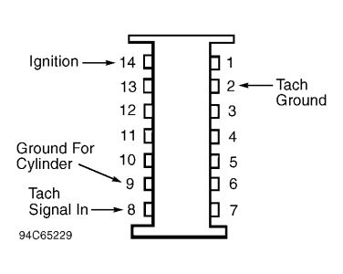

AROWNIOUS
  • 8 POSTS

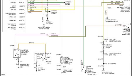

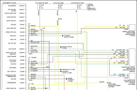

I own a 1995 Ford Ranger and recently replaced the old instrument cluster (no tach) with a fully functional cluster from a 2001 Ford Sport Trac (with tach).
The cluster is completely compatible and has no issues, except for the fact that the tach acts sluggish and weak.
I would like to know what all is involved in the tachometer receiving its signal and how can I troubleshoot the issue? Its worth mentioning that before replacing the original instrument cluster, I did have a check engine light, and the speedometer did not function. After replacing the VSS the check engine light went off but the speedometer did not function. I assumed the cluster was bad, but could the speedo cable be bad as well? Does this electric cable have any effect on the tachometer?
Oct 31, 2020 at 4:13 AM (Merged)
BLUELIGHTNIN6
  • 16,542 POSTS
hello and thanks for donating
a slow and sluggish tachometer is normally due to faulty grounding of the tach. since the original cluster didn't have a tach, there is no ground being presented at the cluster for a tach..an easy way to check is just get a loose piece of wire and ground it good to a bolt or something in the cab of truck, then wire it to the tach. if it works fine then you need to run a good permanent ground.
the speedo cable does not affect tachs, the tach is electronic while the speedo is manually driven by cable.
AROWNIOUS
  • 8 POSTS
I'm going to try the ground wire. You wouldnt happen to know which wire in which connector it is? Or have a wiring diagram you could share?
My speedometer uses the VSS sensor connected to the wiring harness. What exactly does the Tach use to receive its signal? Thanks.
BLUELIGHTNIN6
  • 16,542 POSTS
The tach circuit terminal connector ground pin is pictured below.. The tach uses the ignition coil to get its signal..
https://images.2carpros.com/forum/automotive_pictures/261618_Graphic_467.jpg
BLUELIGHTNIN6
  • 16,542 POSTS
https://images.2carpros.com/forum/automotive_pictures/261618_Noname_2198.jpg
https://images.2carpros.com/forum/automotive_pictures/261618_Noname2_714.jpg
