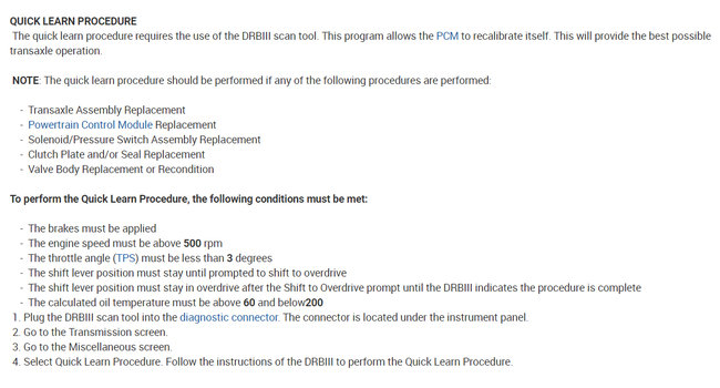

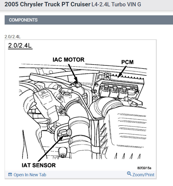

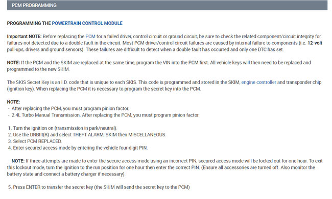

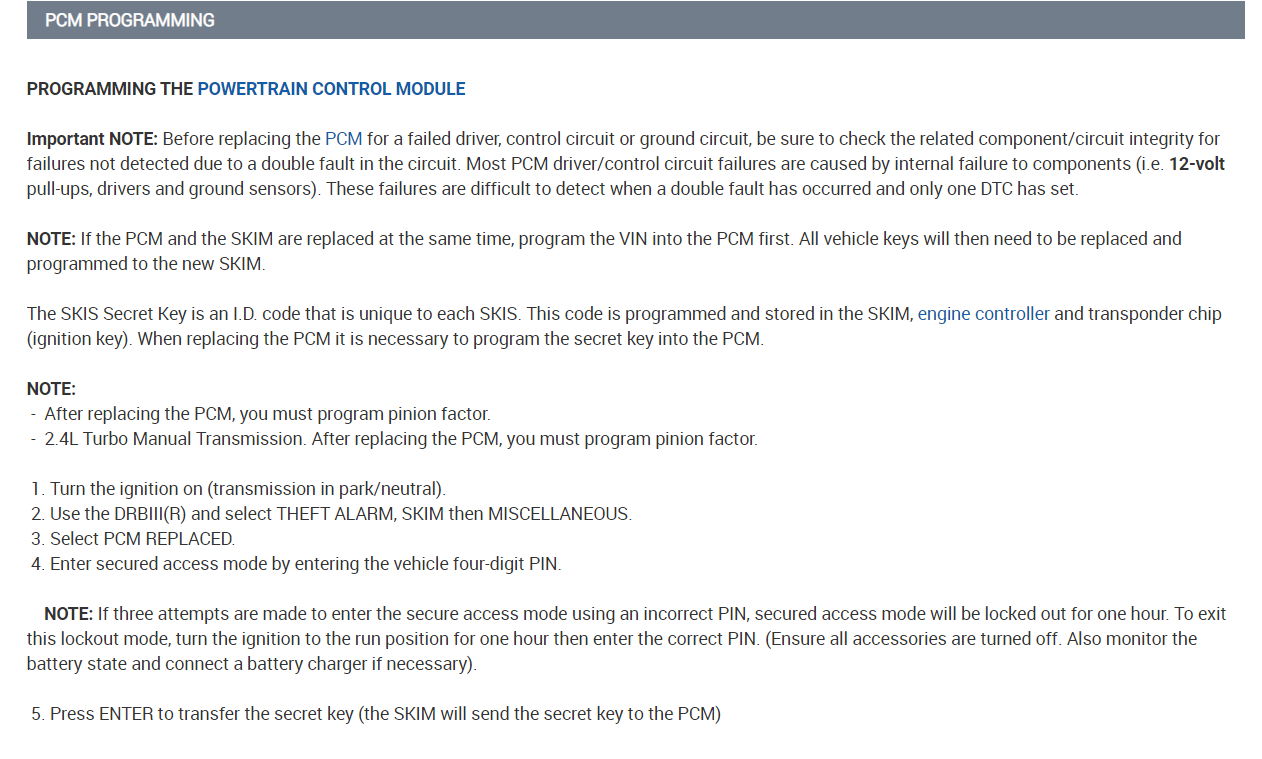

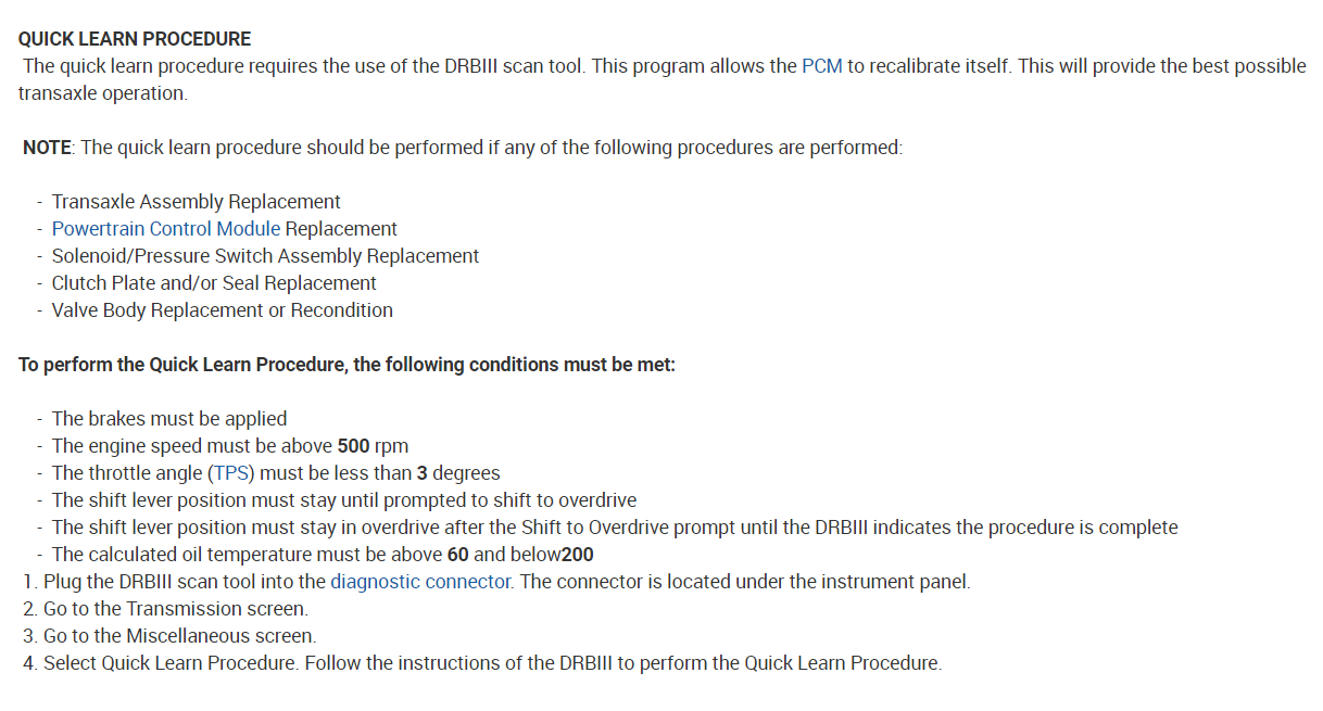

Replaced the computer box, now my key will not start the car.
Aug 2, 2017 at 1:20 AM
STEVE W.
  • 15,418 POSTS
Here is the PCM replacement instructions in the diagrams below. It looks like there is a quick learn. Check out the diagrams (Below). Please let us know if you need anything else to get the problem fixed.
